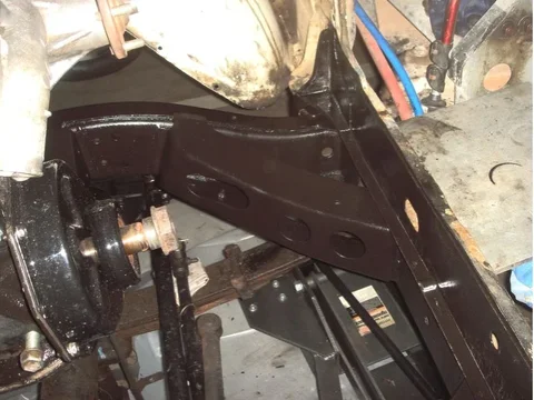

That vehicle rustproofing version of organic boiled linseed oil they sell at that link above is mixed with bone black pigment to give it a brownish color. It goes on really thin. If you slap it on thick, it just drips off. It requires about 4-5 days between coats because it dries so slow and needs to be ventilated well. Not toxic fumes, but you can smell the linseed oil. I like the smell. It dissapates in a few weeks. Never bothered me like FF. But wear an organic vapor mask if your nose is in it under the car in an unventilated garage.
I brushed it on the outside of the frame & springs with a junk brush. Several coats.
Linseed oil can be applied over rusty metal that has been wire brushed clean of any big flakes. The oil penetrates the rust and seals it..suffocating out any oxygen. The rust stops growing.
On the last coat in some places. I mixed in a little black Rustoleum alkyd oil based paint to give it a darker color and less tacky feel.
For inside the frame I used the sprayer with a flexible wand I purchased at Kellsport Products (who sell it for that evil FluidFilm.
Here's a couple pictures of it applied to the frame:
