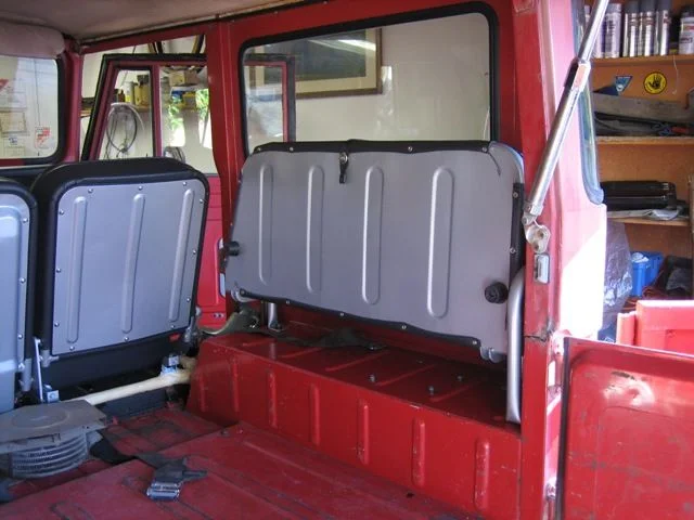

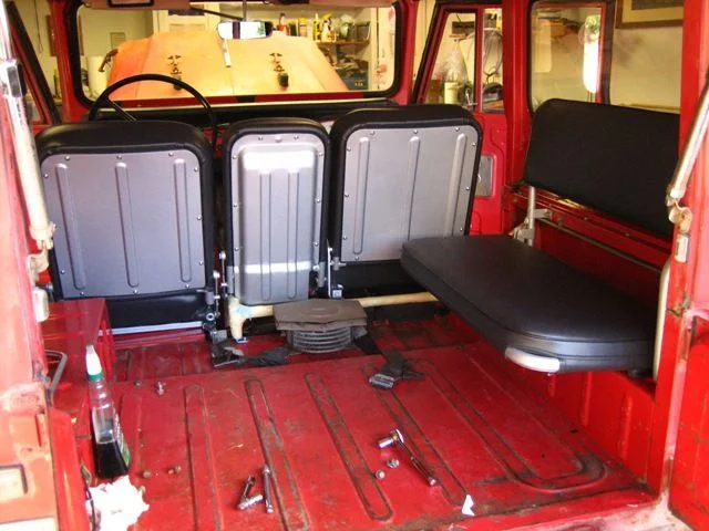

Got everything back together and I think they turned out great.
Only sanded one time and left the last coat alone.
Thanks for the tips.
Ken

Nice job fallon, Those came out really good.
What color rustoleum did you use? Thats a damn close match to OEM...
