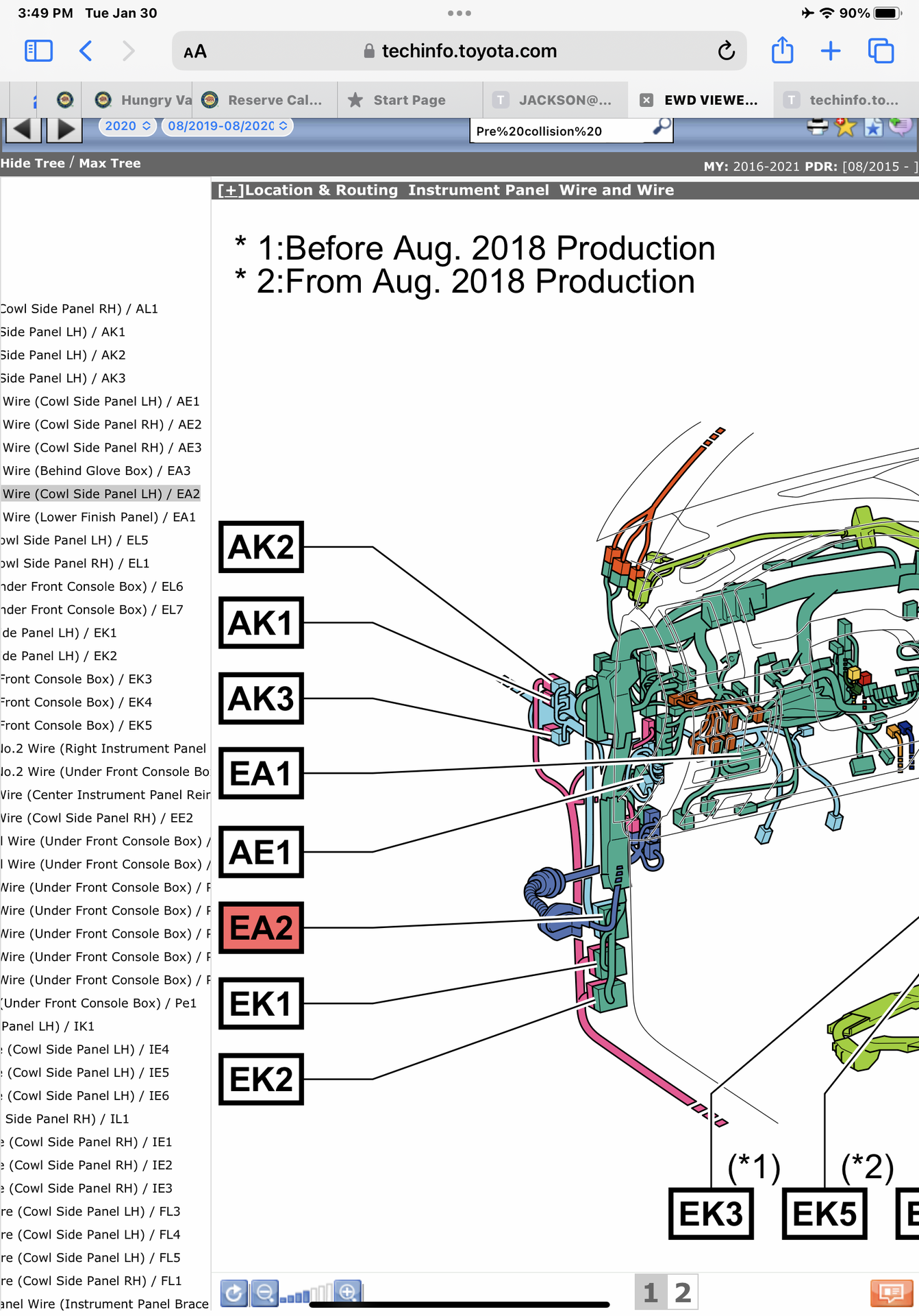

A quick little look see says that the following connectors are common to those systems. there may be a couple more, but these are the big ones. As mentioned before, it might be worth checking them for corrosion especially if your windshield sealing is suspect or if your sunroof drains are clogged. I tried to kind of order them by number of shared connections.
if you see any corrosion at all, probably want to clean and deox. the lowest ones are in behind the LH (US drivers side) kick panel.
