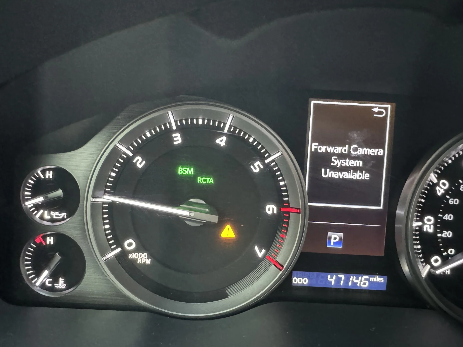

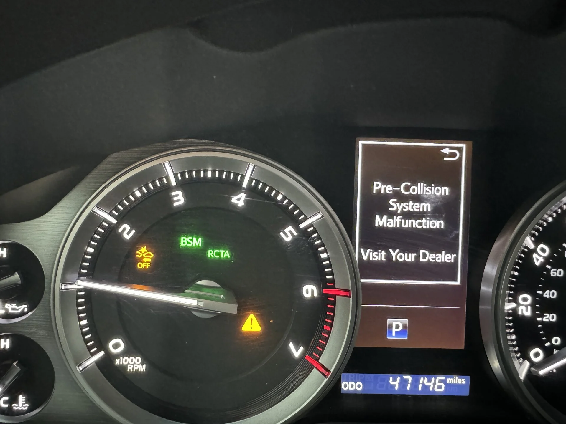

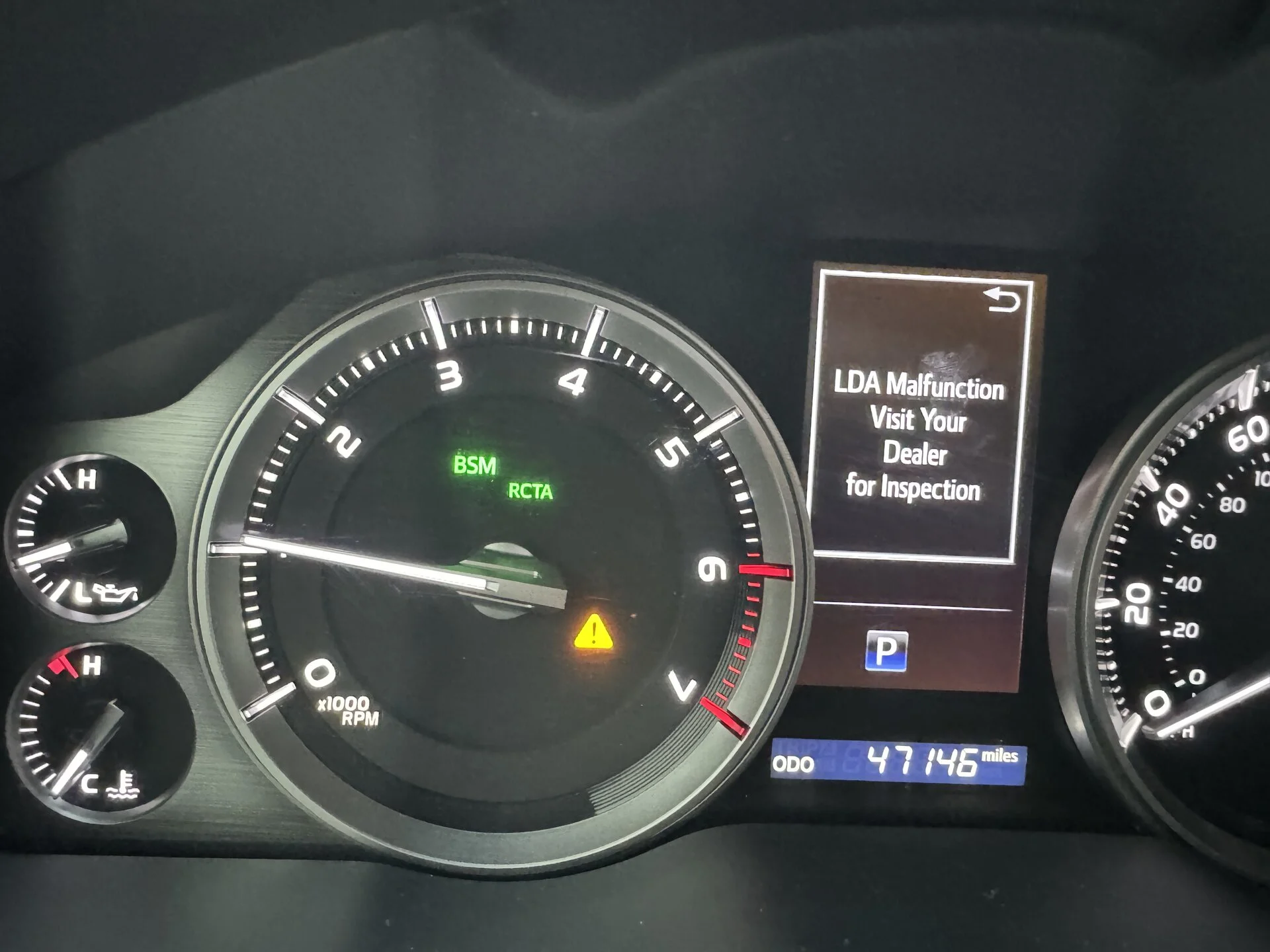

Took my 2020 LCHE to a dealer here in Austin to diagnose an error code that sporadically came on after heavy rains or when the truck was washed/detailed. But now the warning stays on after recent rains and cold weather this week. The diagnosis from the dealer states the part needs to be replaced and recalibrated. Unfortunately the parts system is stating "BACKORDERED, None available in the country. NO ETA."
Anyone else run across this issue? If so, how did you remedy it?

IIRC, cruise is only tied to the radar behind the Toyota emblem. The camera is for lane departure I think.
My best guess is that the pre collision uses a combo of camera and radar to determine likelihood of collision. But I could be wrong.

UPDATE: Yesterday drove to San Antonio for the day. The truck sat outside in the sun (facing the sun) for at least five hours. When I started it to leave back to Austin, NO CODES were thrown and the system was behaving normally...even had cruise control. Made it halfway back to Austin, stopped for fuel, turned off the truck, and then the codes came back on. I'm suspecting that the heat dried out the lines/connections beneath the hood where the front camera and emblem-mounted radar sit. But now the codes are back and I'm going to a second dealership here in Austin to find an expert and remedy.
