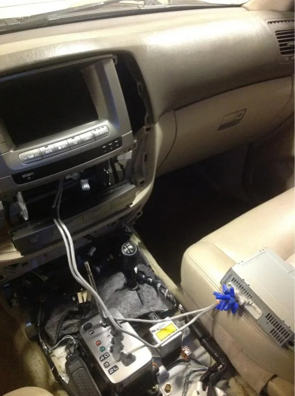

To keep the climate control working you just need to have the AC condenser unit center plug plugged in. I am going to relocate that unit underneath the center armrest after I take out the Lexus link. Then I shall have a single din space for decent deck.

Relocating ac condenser unit using couple cat 5 cables.

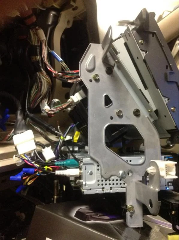

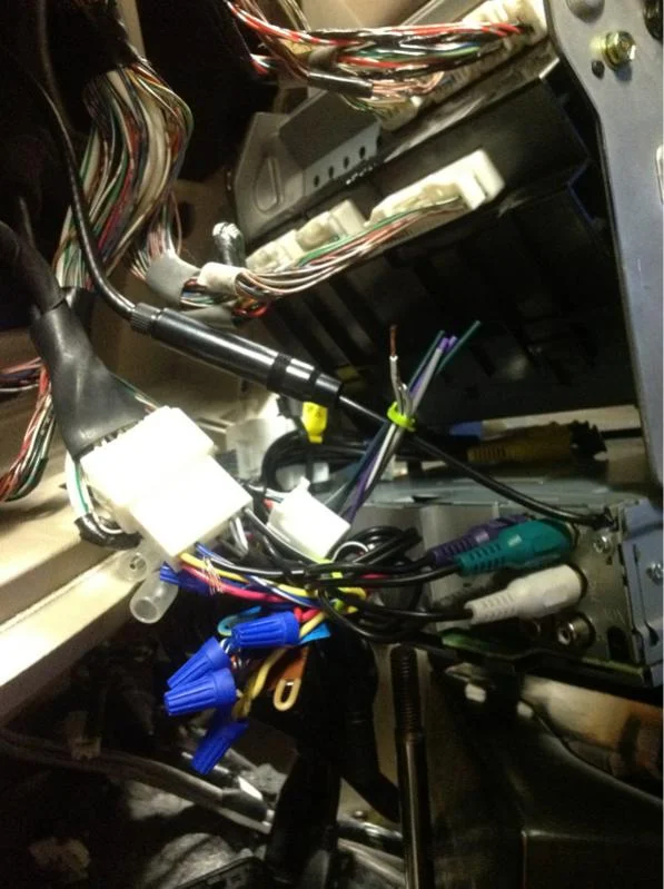

Oh yes it is the cassette deck, which also happens to be the condenser controller. Strangely without it the ac won't work... Otherwise it would be a super simple thing of taking it out and putting a single din head unit in its place. So to make the ac work you have to relocate the condenser control unit (the cassette deck) somewhere else and extend the middle connector as illustrated in your picture. Also if you are going to use the stock ML amp you need to connect the amp cable next to it.
Installed the kenwood in the condenser controller space for the first time. Getting some where but still dealing with some odds ends.
1/ the antenna goes up when radio is selected but no signal is received on the head unit
2/ seems like the head unit is not retaining time and song settings after the vehicle is off
3/ no sound via ML amp but works perfectly when I connect to pioneer speakers directly
Please share help! Much appreciated...
Front and rear ac working perfectly.
