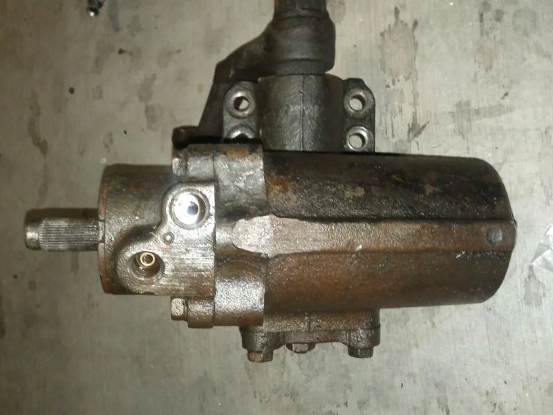

Included with my 1969 FJ 40 project is a Toyota power steering unit probably from '79 or '80 just like the one shown in the attached photo. I wish to install it using the power steering kit for JT Outfitters. Apparently this kit allows you to line up the unit with the steering column. I also want to upgrade the steering column to a collapsible adjustable unit. Any recommendations on what column will work best?

if the box is from a Landcruiser and not from a mini truck, you would need the stock pedestal for the frame mount
you can use a later 1981+ steering column from a 40 series, but there will be wiring issues and the key is on the column
also the firewall is shaped different for the hole versus what you have now
IIRCC the bracket in a kit are made to use a mini truck box which has different angles than the Landcruiser box

As others said the box could be from a mini truck or a land cruiser. Post a sideway pic of the box and someone can tell you. I got a land cruiser PS (from a 79 I think) and used a later non-PS pedestal (from a 72 I think) on my 65. Got the column coupler from JT outfitter which required cutting the stock shaft and welding it at the end. Turned out nice and it’s night and day compared to the old 65 steering box. But I’m 6’ 1” and the steering touches my knees a bit, if I knew I would have made the shaft longer compared to stock. Collapsible one would be nice to have.
