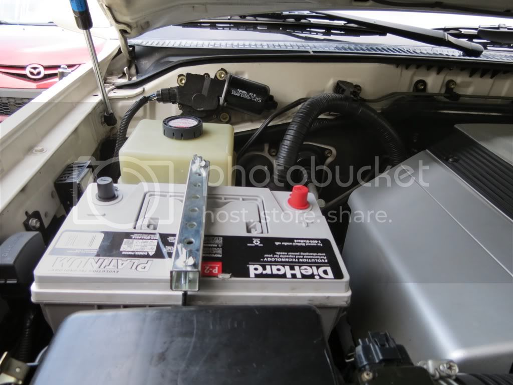

I'd cut it to length off the old ones. Or, relocate the resovior and allow a air compressor and dual battery. I have been thinking about putting the PS fluid infront of the airbox and mounting a compressor next to the second battery.
That is exactly what I did with mine. I only had to replace the 5/8 line. The other still reaches the new location.
