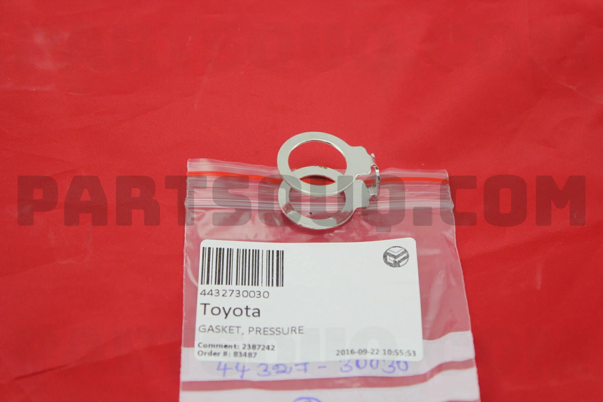

New Toyota dual gasket? Once it's been crushed it can't be reused. Maybe try a new Toyota gasket (see below).
Check to see if an old gasket is stuck on the pump and if the new hose fitting is flat on both sides of the union.
This is what you want:
New Toyota dual gasket. Failed right out of the gate. Everything seems to be flush. The leak is at the banjo bolthead and the gasket.
