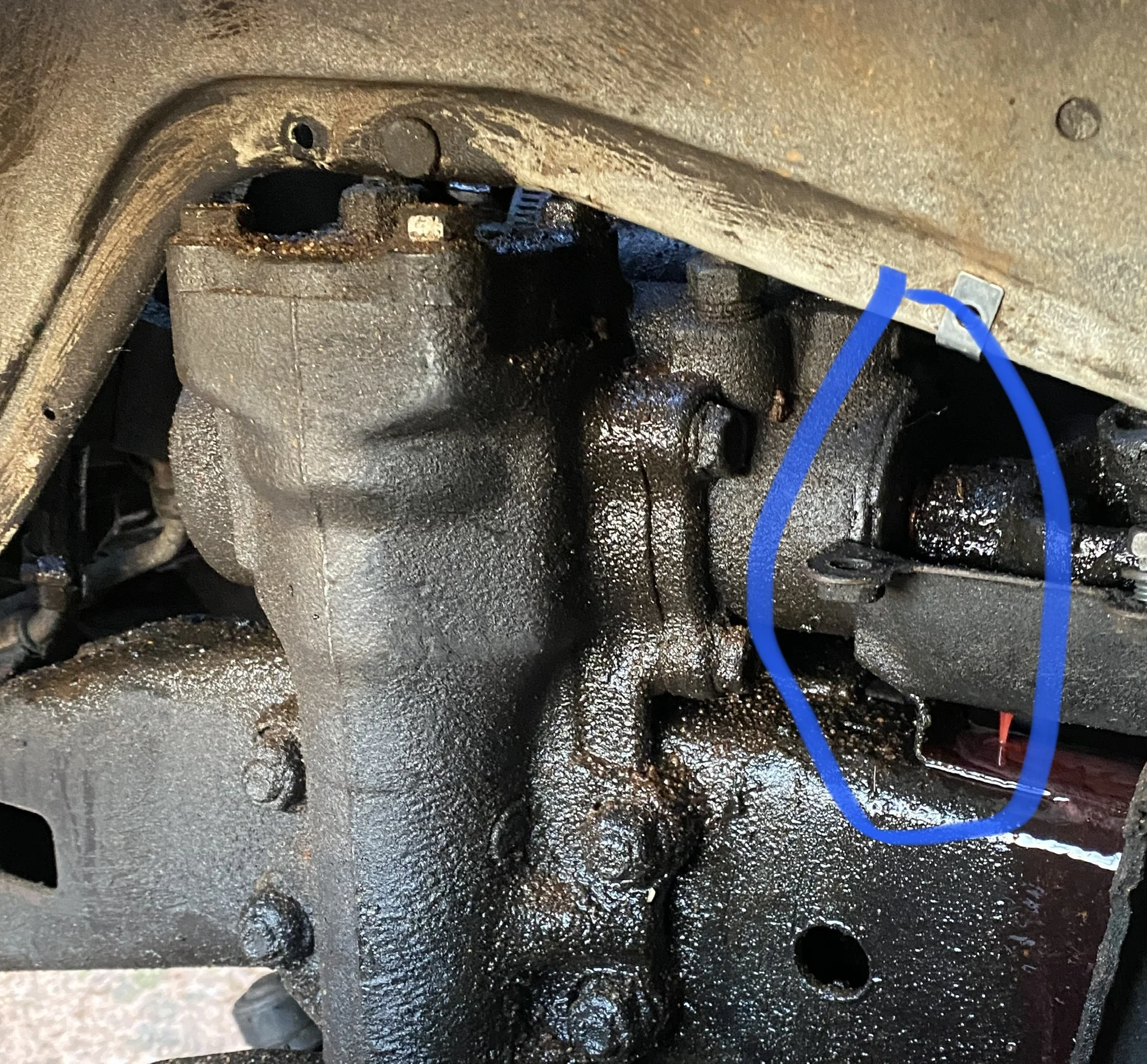

Finally decided to address my badly leaking power steering system today by first tightening the clamps on the return lines, making a new gasket for the reservoir cap (whenever I run the truck frothy ATF spews from the cap) and finally flushing the system and replenishing it with new ATF. I took it for a test drive and the gear box as groaning as usual until eventually I almost lost all power steering. I checked the reservoir and it was empty. I thought maybe there was air in the system taking up space that I hadn't totally evacuated and I put some more ATF in. Power steering was back! but then when I stopped the truck and got out I noticed a healthy stream of ATF pouring from the gear box. Guess its time to bust out the wallet. From my searching on here people tend to suggest buying a remanufactured gear box rather than trying to rebuild it yourself as they often leak when you rebuild them yourself. I've also seen people suggest getting an 80 series gear box to replace the fj60 gearbox. I'm trying to figure out what I should do, would love some advice! I like saving money and Im not afraid of taking something apart to rebuild it but where should I source a kit for this if I go that route? If its best to just buy a whole rebuilt box would I be better off getting an 80 series box or would it not even fit on an '85? Thanks!

Oh yeah, I forgot to update this thread. I got the $17 Edelmann 8770 kit and replaced everything in my gearbox with all the kit pieces with the exception of the two teflon rings that people have a hell of a time getting back in without ripping. Apparently the rings in this cheapo kit are reportedly larger than the original which complicates things further. I felt it was safest to avoid the hassle and possibility of botching the whole job by destroying the original rings upon removal and the new ones upon reassembly. I mainly just needed to replace the input shaft seal which turned out to have been put in backwards by a previous owner which explains the horrendous leak. The inside of the box was somewhat gunky. Cleaned everything out and inspected bearings and then reassembled. It was an easy job until I got to reassembling the worm gear bearings. I still don't really know how I did it. The videos I watched had pretty horrible explanations but on my 10th or so attempt of me dropping them in and jiggling/turning the shaft they finally all lined up properly and didn't bind when turning the shaft any which way. Took me an afternoon to complete the job and now power steering works again on my 60 and theres no leaks or groaning. I also replaced the high pressure line with the $14 Edelmann 71210 hose. Direct match although the tightening nuts on the hose are imperial rather than metric. I replaced the soft return lines with a couple feet of 3/8" TOC hose from the auto parts store. Feels good to have that taken care of and cost less than $40.
