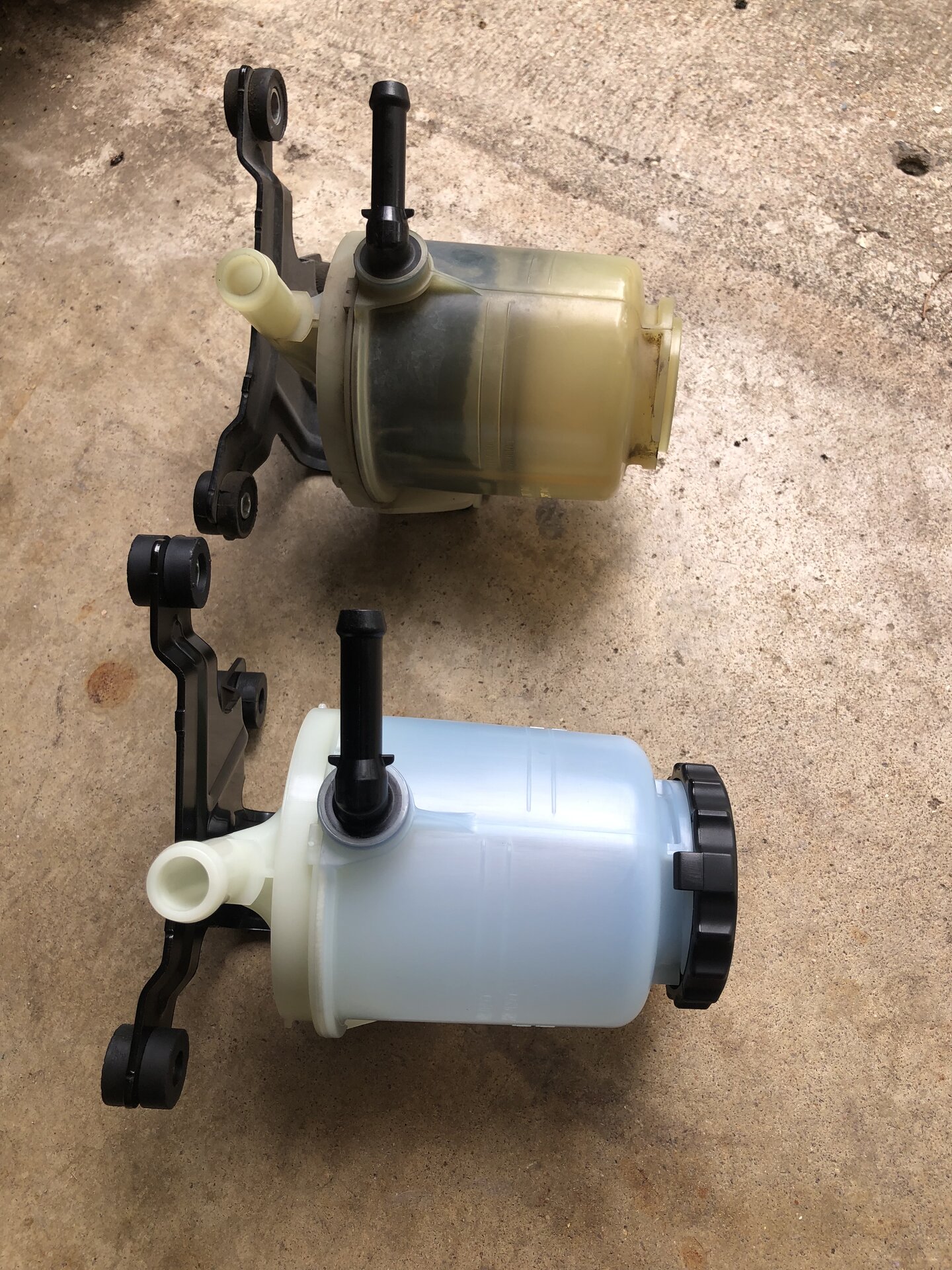

Note that our reservoir has a non-serviceable mesh filter in the bottom above the suction port. Between that and the plastic being degraded from heat/chemicals I replaced mine with a new one.. minty fresh. No chunks on the bottom either.

I ordered a new one after looking at mine yesterday, thanks for the part number. Any special install needed to avoid getting air in the system? Or can I just drain the old one, put in the new one and fill it up?
The screen actually may trap some air in the bottom that could get sucked into the system.. but it won’t be a lot and shouldn’t be difficult to bleed through normal driving.
The big caution I’d say is the return hose is very hard to get off the small nipple on the reservoir. Just be careful to avoid breaking it.

Thank you for the heads up. That thing was on there! I was finally able to get it off without breaking by having the reservoir unbolted and twisting it while pulling the return hose. There was quite a bit of sediment in the bottom of the old one so it’s nice to get a fresh one in. Not to mention the staining inside making checking the level difficult.
