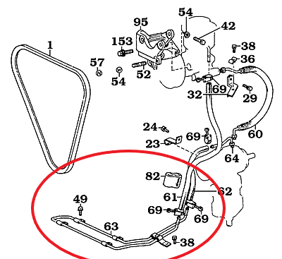

While we are on this subject....do the power steering lines loop over to the passenger side and back to help cool the fluid?
There is a hard pipe cooler assembly that loops under the radiator over to the passenger side and back for cooling the fluid:
yep...thats what I was referring to. Figured it was for cooling but wasn't sure if there was some other purpose I hadn't thought of.
