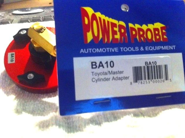

EDIT - The answer is BA10 for the 95-97. Thanks @flintknapper!
Anyone using the Power Probe products brake bleeder caps for an 80 series? I have a 97 LX450 and their chart says use the universal style (with chains) for Toyota (model BA07) BUT it also says to use the style with 4x retaining clips for Lexus (model BA10). Since I have a Toyota wrapped in LX garb...which is it? I have a call out to them but had to leave a message.

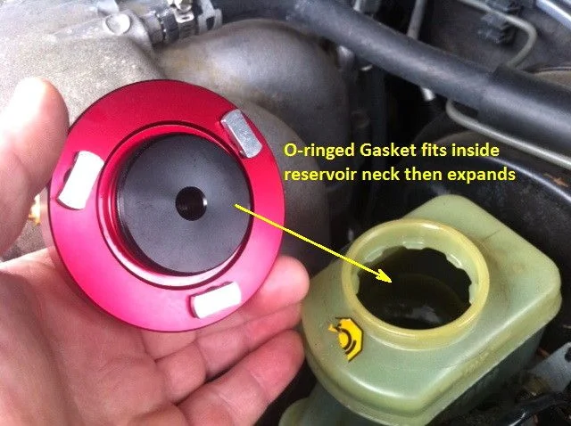

BA10 fits my '97

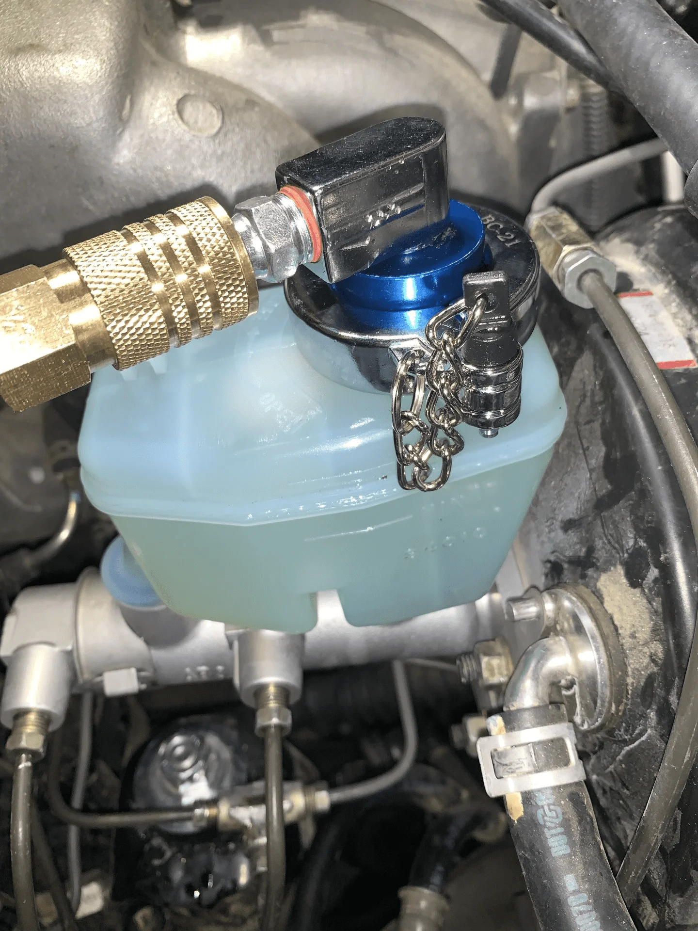

I have the chain version and it holds pressure just fine. After 30 min of letting it sit for testing it lost 5 psi. No big deal... you can easily bleed flush the system in less time then that.

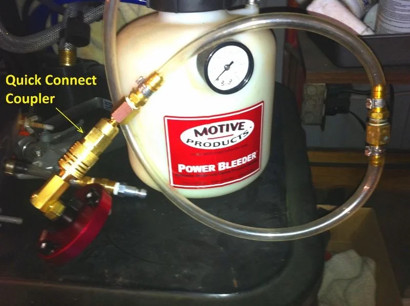

I am using this locking cap...works great. Just need to replace the quick connect fitting it comes with, with a regual 1/4" npt air coupler fitting.

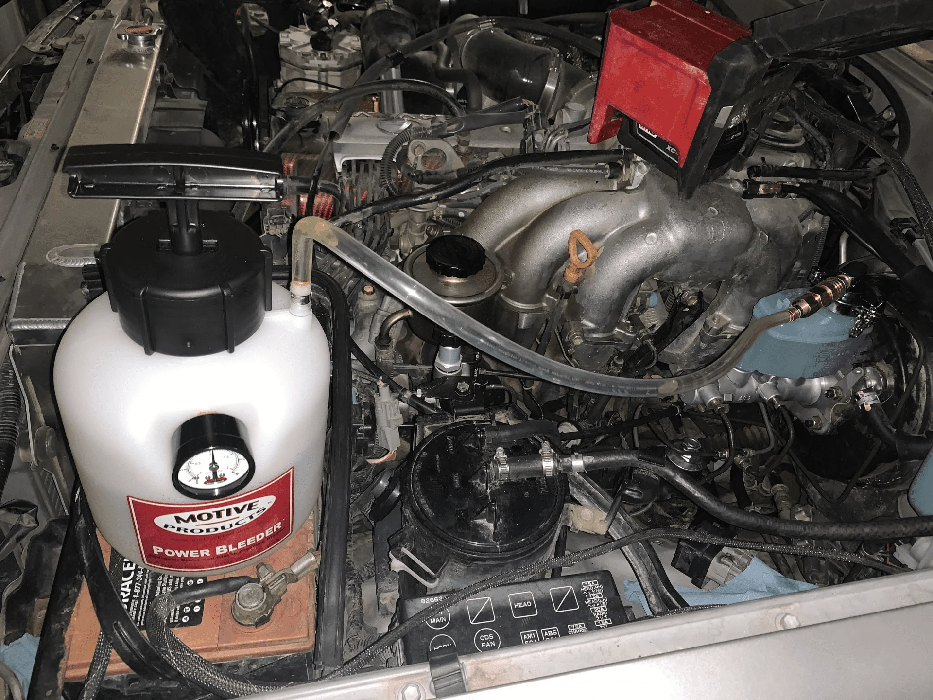

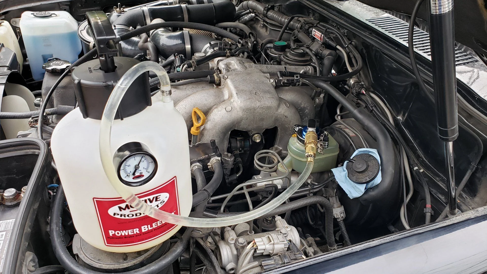

I realize y'all got some nice and fancy lids to use, but I found the included lid to work fine with my 1996 TLC. For some reason the Motive instructions do not suggest putting a light coat of brake fluid on both sides of the rubber puck that goes under the hard plastic cap that sits atop the master cylinder. Maybe that is why others have reported the thing sprays brake fluid everywhere once it's placed under pressure. I coated the rubber puck with brake fluid on both sides, and placed the angled side down toward the master cylinder, and mine sealed fine.
I'm not trying to start a war of approaches, or words, and I'm in fact envious of the nice mods y'll have done to the Motive system. I'm just posting this so others who are considering buying the Motive, or figuring out how to use it, will have a suggestion on how to make it work well out of the box.
I use the universal (rubber puck) style out of the box and it worked great.

Not sure if they fit all 80's however but I imagine it would, that said, I did use BA10 on my 91. I tried using the black puck one that came with the kit but it would not stay on once pressure was added. I had ordered mine from a site called Tool Discounter.
