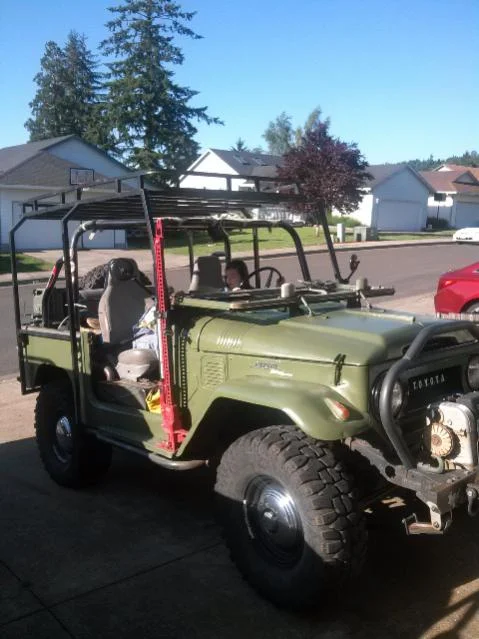

I had five done at Les Schwab's for 25 each blasted and powered. Love these now!

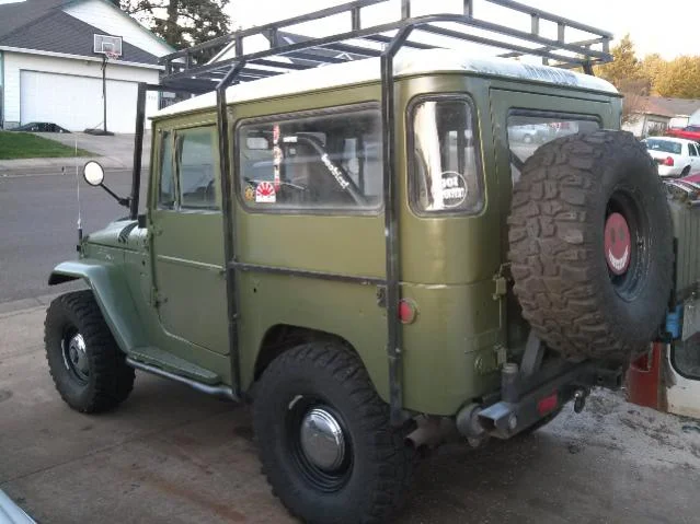

....The skinny rims (6.5) took some convincing before accepting the 33/12.5/15 tires .....
Those look like OEM factory steelies for a 40 series? If so, aren't they 5.5" wide? I know the ones on my 77 40 series are 15x5.5.
I am surprised the tire shop would mount a 12.5 tire on 6.5 or 5.5 rim. I had several tire shops that balked at mounting my 10.5 tires on my 5.5 rims.

bleh, can't get a larger picture to take, you can get a better view in my garage.
From the pic it looks like the inside was blasted /coated also. Any damage from mounting the tires?
