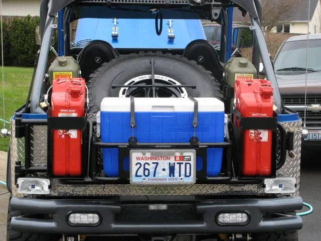

here you go the carrier is semi gloss the roll cage is gloss and so is the bumper
Fieldsken1 , I gotta say, That is One Outstanding Rig. Nice Work all the way around. I kinda like the gloss. :hhmm: It sucks, Because I think I have my mind made up ,then I think ... Maybe not.:meh:

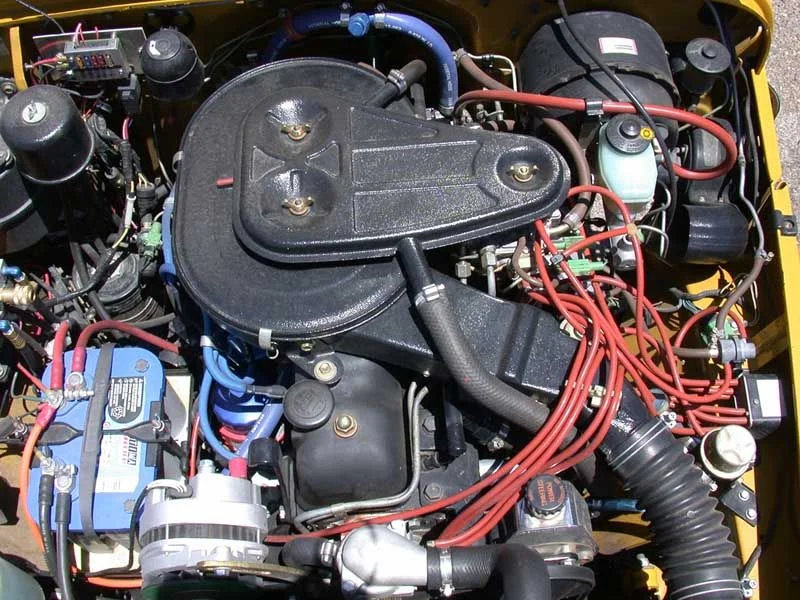

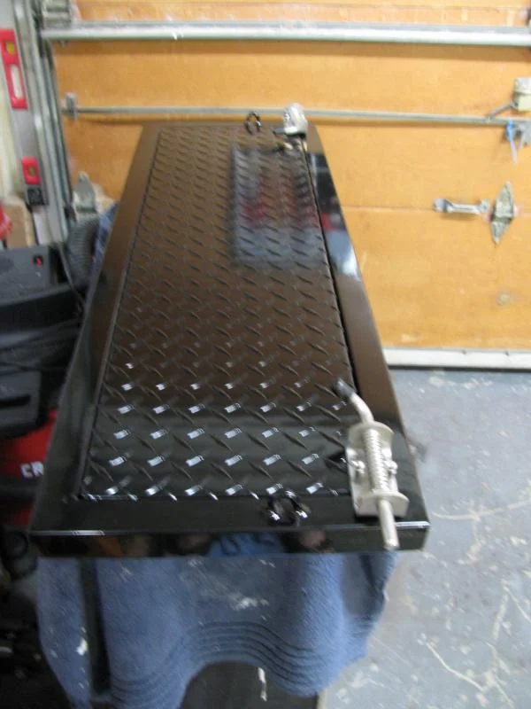

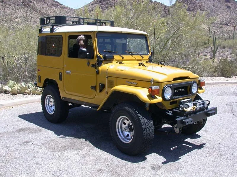

Personally, I dig Cardinal Black Hammer.
