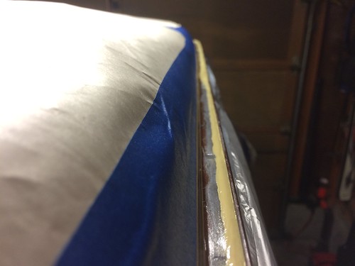

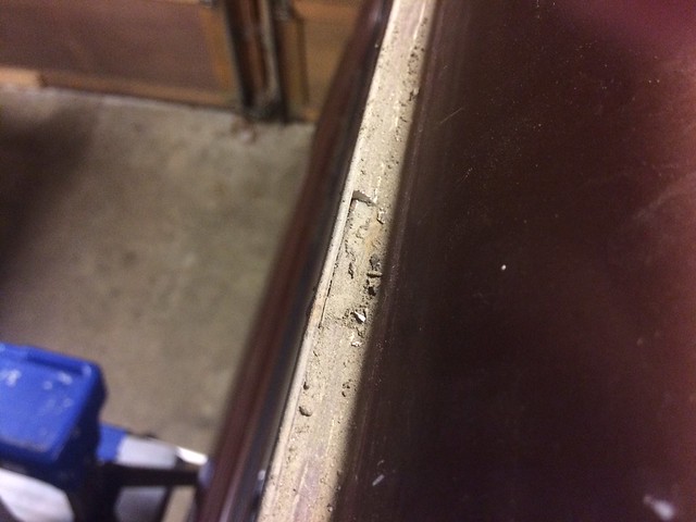

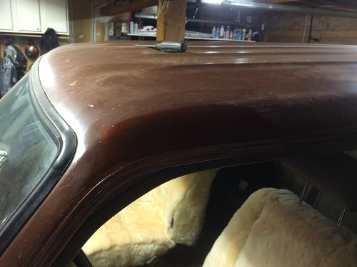

Apologies for bringing up an old thread, but I've got water in my floorboards and I've taken a few pictures of my gutters (83 FJ60).
Are these tiny cracks and missing chunks of something that seems like it might be sealant enough to cause leaks? Or should I look elsewhere (fenders/windshield?)

image1 by theophilus76, on Flickr
IMG_4465 by theophilus76, on Flickr
You may have separate windshield leaks causing floor wetness, but those gutter leaks WILL cause your roof sheet metal to rust out. Time to get some 3M sealant (the correct one for that seam) and carefully remove all the failed sealant, clean well, and apply the new. Even if your gutter bottoms are white (due to the sealant), you will have at least stopped water intrusion.

Thanks for the advice. I guess I'll start with the gutters. Water flows down hill, so I might as well start at the top. I'll take a few pics along the way in case it helps the next guy.
Finally finished the gutter reseal. I'll offer a few pics and suggestions for the next guy who finds this thread.

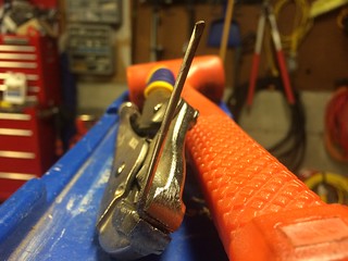

2. Plan plenty of time to get the old stuff all the way out. If it's failed, it'll pop off in 5 seconds with a thumbnail, if not, it'll take some banging. I used a lead filled dead drop hammer, and a vice grips around an old tiny flat head screwdriver (the kind for eye glasses). See pic below.

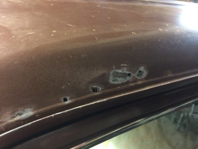

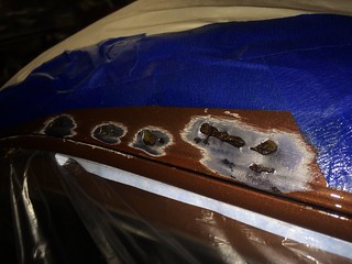

3. If you have the wire wheel in your hand and see a tiny bubble in the paint and think to yourself, "Oh, I'll just hit that real quick and prime and paint it fresh". DON'T. (or do, but be prepared to weld or fix holes).

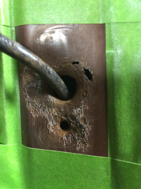

Massive funnel under a horribly fitting antenna (never seen a 60 with the antenna on the A-pillar till this one)
Untitled by theophilus76, on Flickr

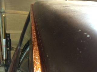

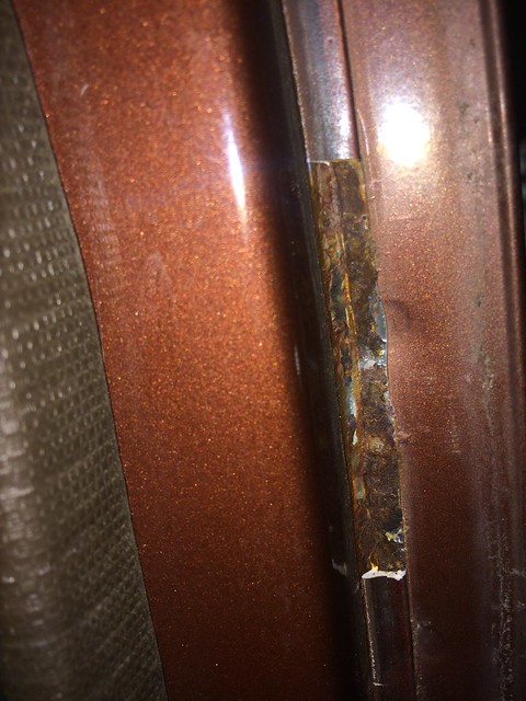

Underside of A-pillar gutter (front door jam) - OLD sealer and rust patch when I picked at it with my thumbnail.
Whoops

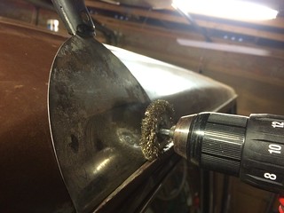

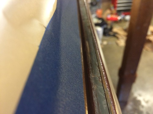

How to keep from scratching everything when wheeling the gutter out
Taped and wheeled - you can see the seam right at the edge of the gutter
Whoops - before sealing

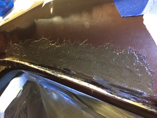

Whoops after Fiberglass/Bondo - hope it doesn't leak
