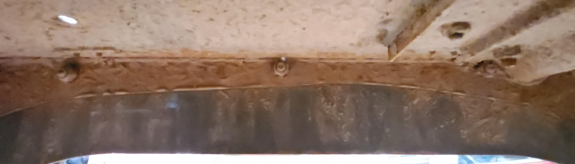

@Fast Eddy here is what I’m working with. I have almost no lip on the front and top, flares used to be attached above fender wells. What do you think?
Probably the perfect application.
Measure how far up from the lip to the flat top above the tire and from the lip to a line extended along the lower body line of the rocker. I'll measure mine later tonight.

From the lip up to the top of the fender well is about 1/2”, and from the lip above the tire down to the bottom of the rocker panel if measured vertically would be about 17”.

Mine has about 7/8" or so from the lip up to the fender, but I'm not using all the space. I'm pretty confident you can make it work in 1/2".
At the front edge, I also have very little sheet metal and at least one hole partially overlaps the edge. I use a washer on the back of that one and it works fine. If you were really picky, you could tack the washer in place but I didn't.
I measure almost 20" from the top of the fender plate to the bottom. You may have to trim it at the bottom-front. The shop doesn't cut a hole there, so you have a lot of flexibility.

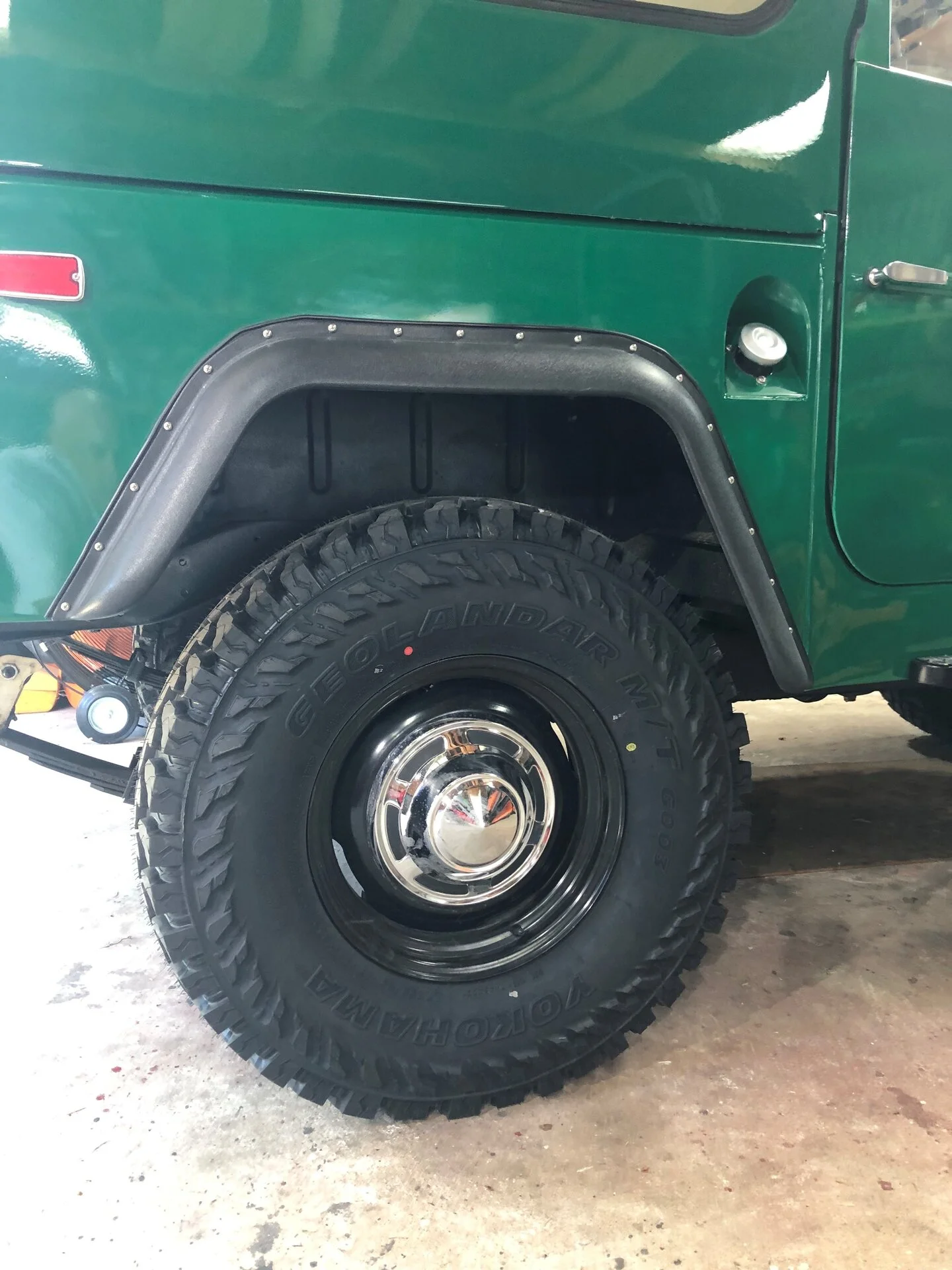

@Fast Eddy here is a photo of what we are working with. I'm not planning on moving the rear axle back, but from reading through the entire thread, it seems that these will work, but may need a little trimming on the front outer edge. Do you agree? Also, what are folks using to get a neat bend at the front contour?

Yea, you'll have to make a bend to go around the body crease at the front, or you could trim them along the body crease if you want.
I wish there were more "after" pics in this thread, but there's one that's in-progress in post #73 and post #165.
