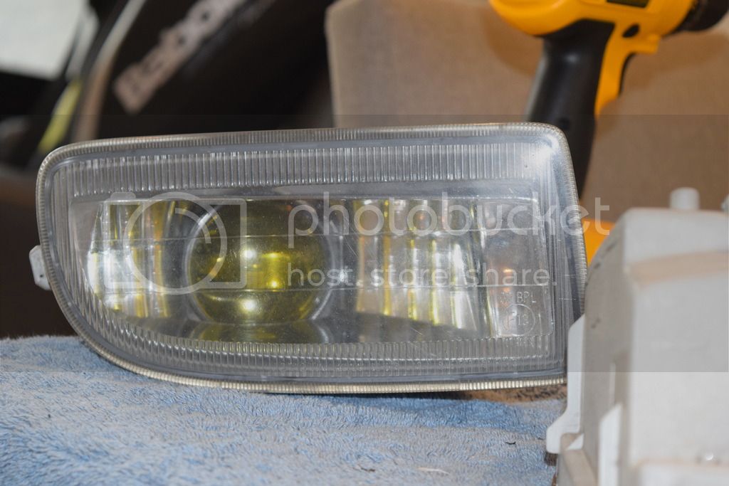

I took a picture of the LED light on top of the fog light so you could get an idea of the size between the two.
You can see on this picture at the bottom center of the bulb area there is a portion of the fixture that sticks out further than another portion. That is where the measurement goes up to 3-3/8", but also note that the other side of the fog light has a slight curve to it.
Here is a better picture of the 2007 LC fog light. I took the back plate off (in the picture), held in by 4 screws, and removed the bulb so it was easier to measure.

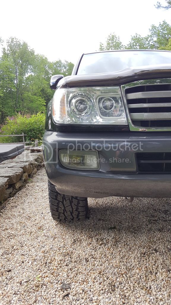

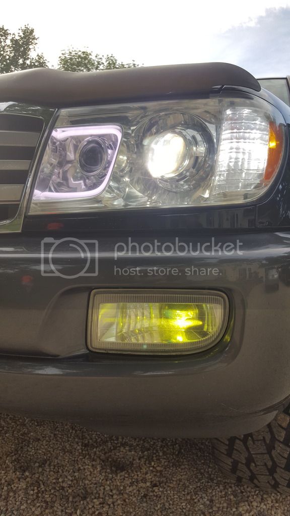

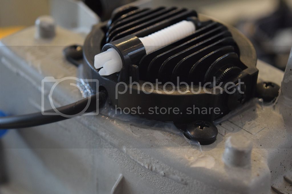

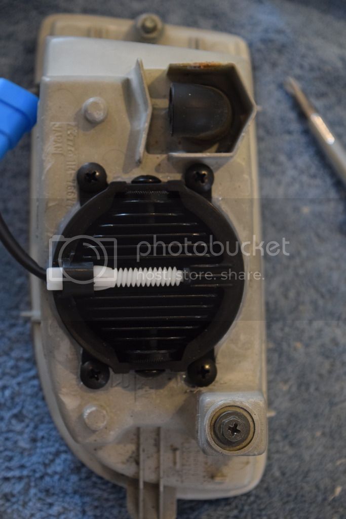

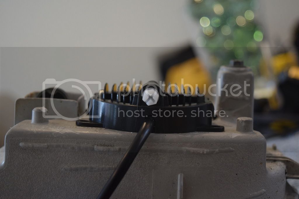

There's a fair amount of Dremel-ing needed to get everything to fit with the reflector housing (I prefer an OEM look, otherwise you could probably just take it out). They fit very snugly on the back of the housing and I think they'll end up being a really simple upgrade in place of a true retrofit. I like how they are full enclosed and weatherproof and require no ballasts etc., truly plug and play.
End result:
There's still some fine tuning to do, but overall I'm pretty happy with the result. They have a nice cutoff and are adjustable (up/down) to aim them correctly.
For those that aren't afraid to hack up stock housings a bit, this is a great option that puts out a significant amount more light than OEM halogens. If any of you decide to bite the bullet and purchase, reach out with any questions, I took a lot of pictures along the way.

Happy to contribute. A couple things worth noting if you go this route:
1) Make sure you trim the reflector enough to give yourself some clearance to adjust the light up/down, I think mine are a little tight.
2) On the plugs provided, you have to trim the little "nub" a bit to get the factory clips to secure properly, they are just a little bit big for the OEM clip to go over the top of
3) Order some 70mm universal rubber boots for the back of the housing to cover things up. There's still a gap between the adjustable bracket you mount to and the light itself that can let some water in
