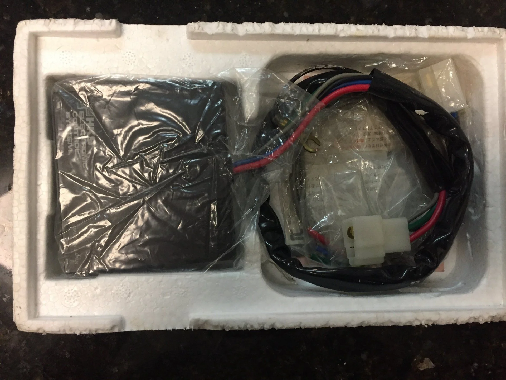

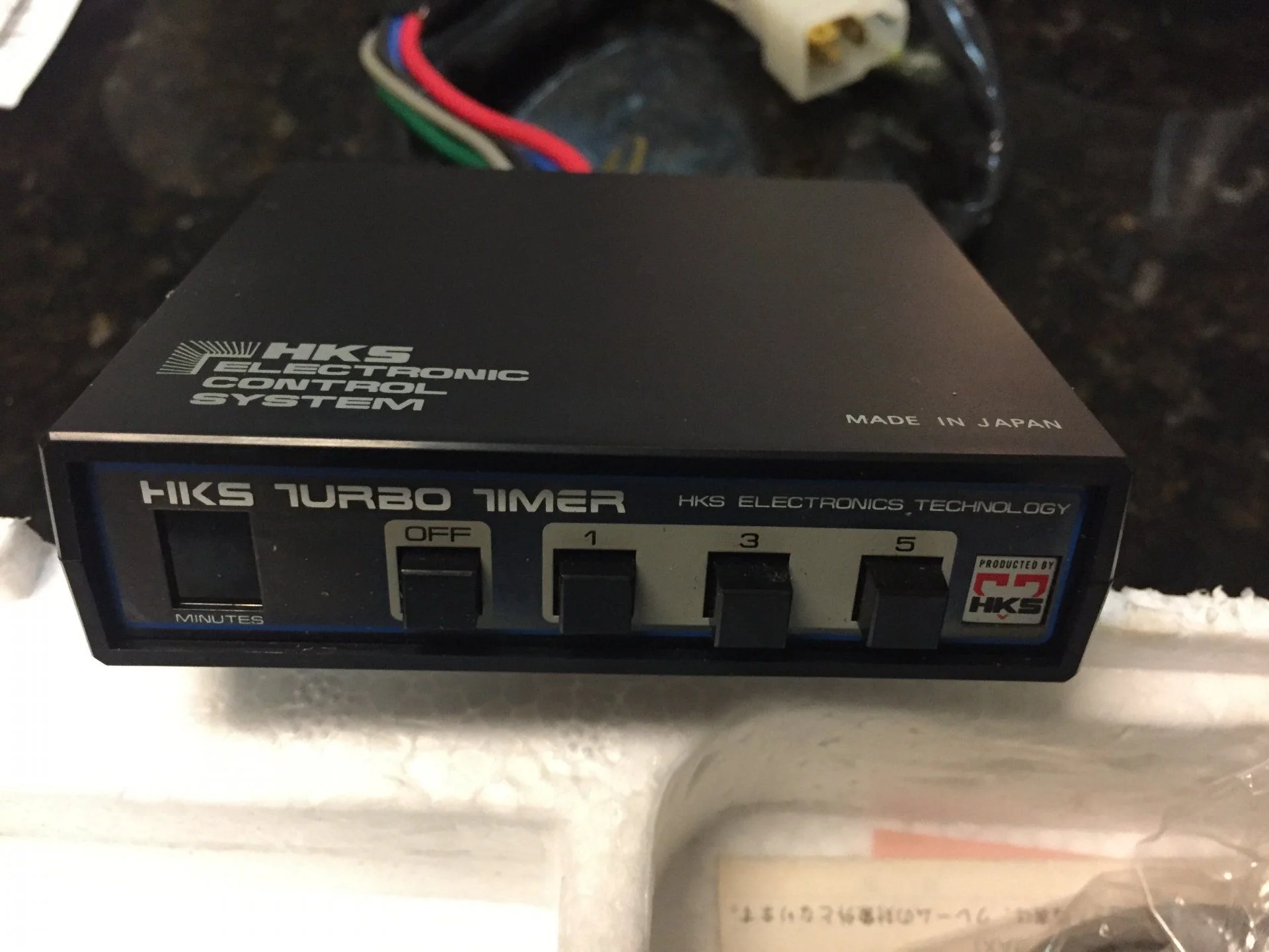

Getting ready to install an old school HKS Turbo Timer. New in box!!!

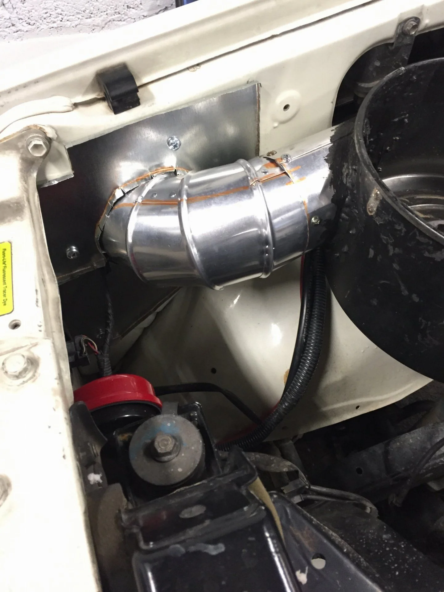

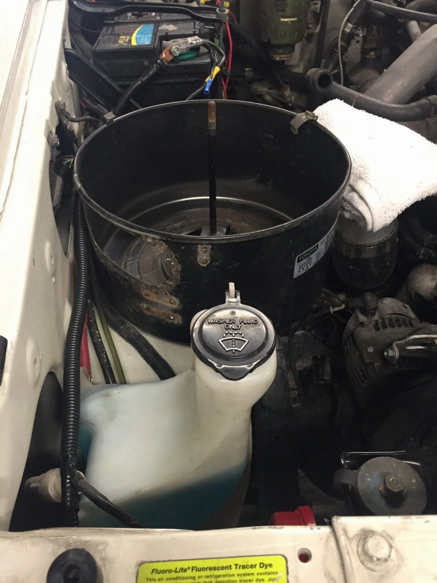

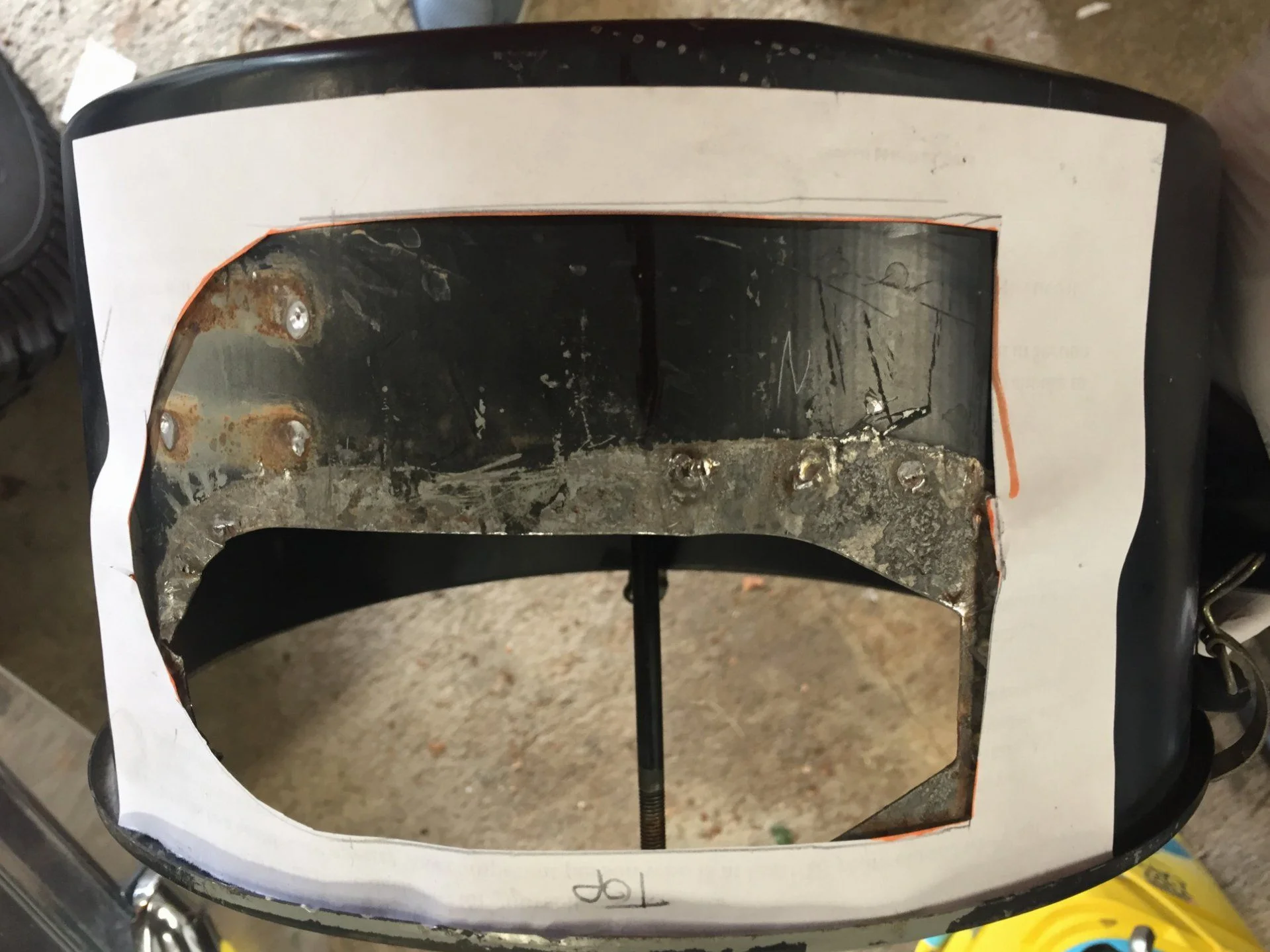

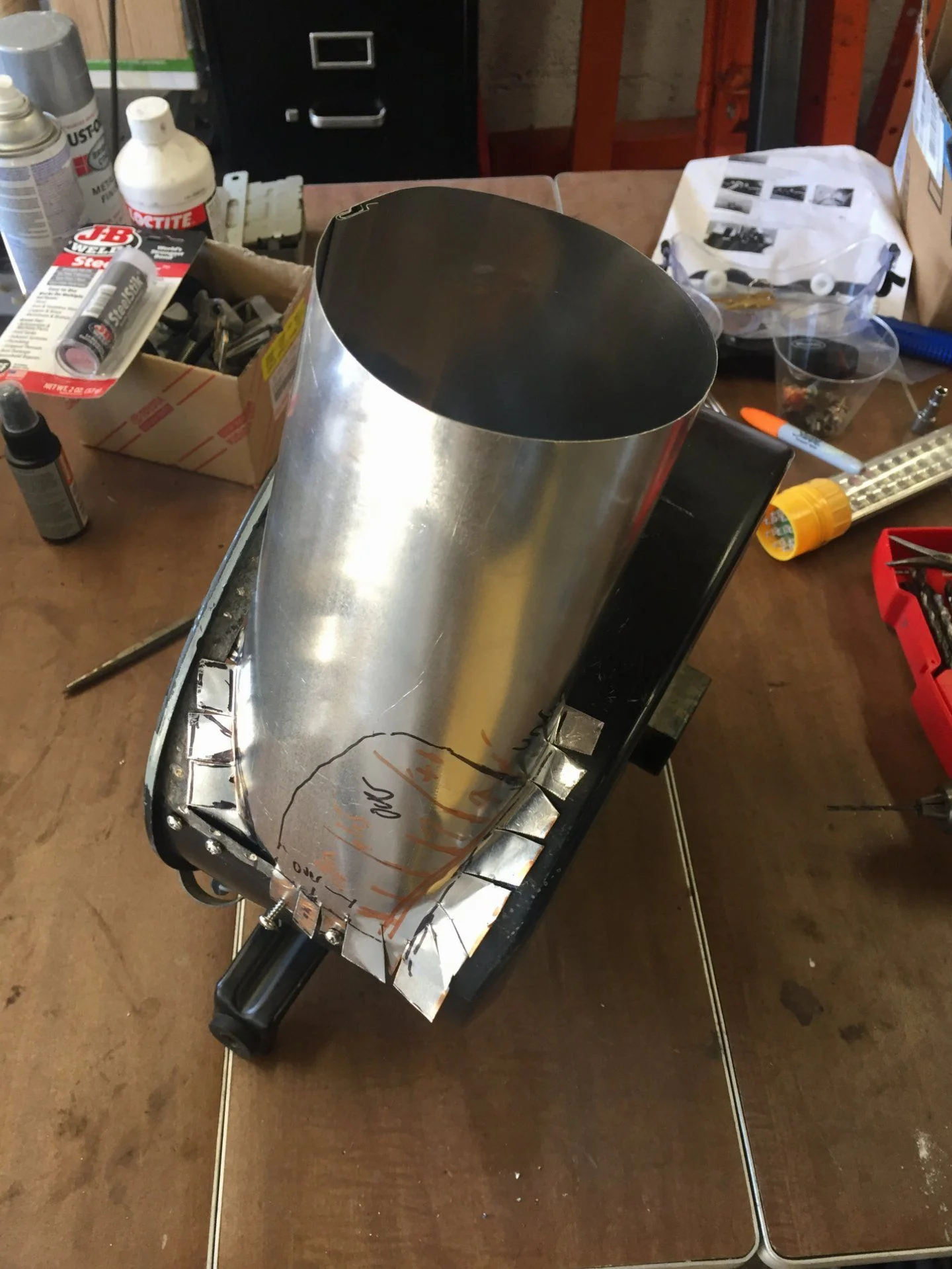

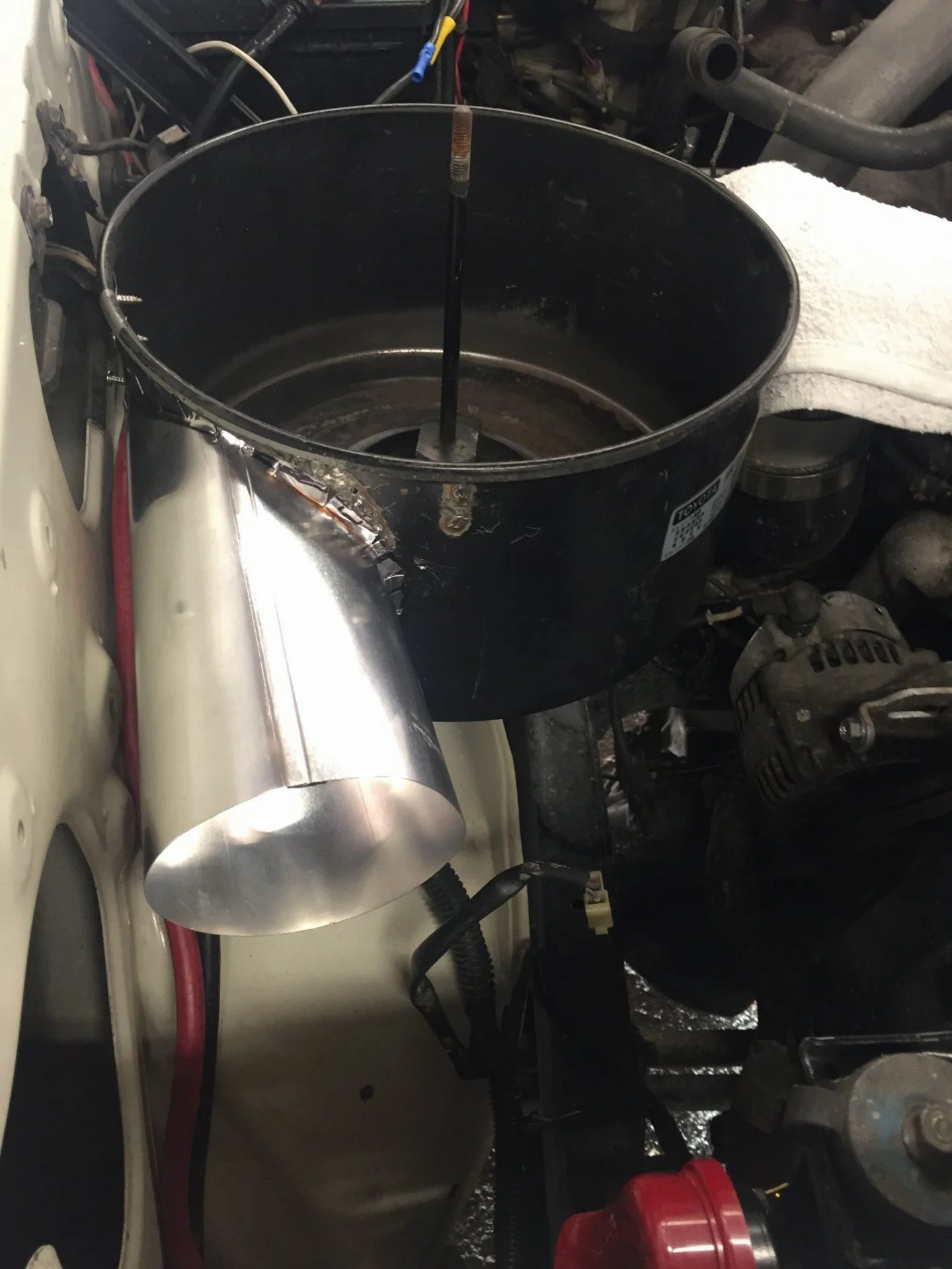

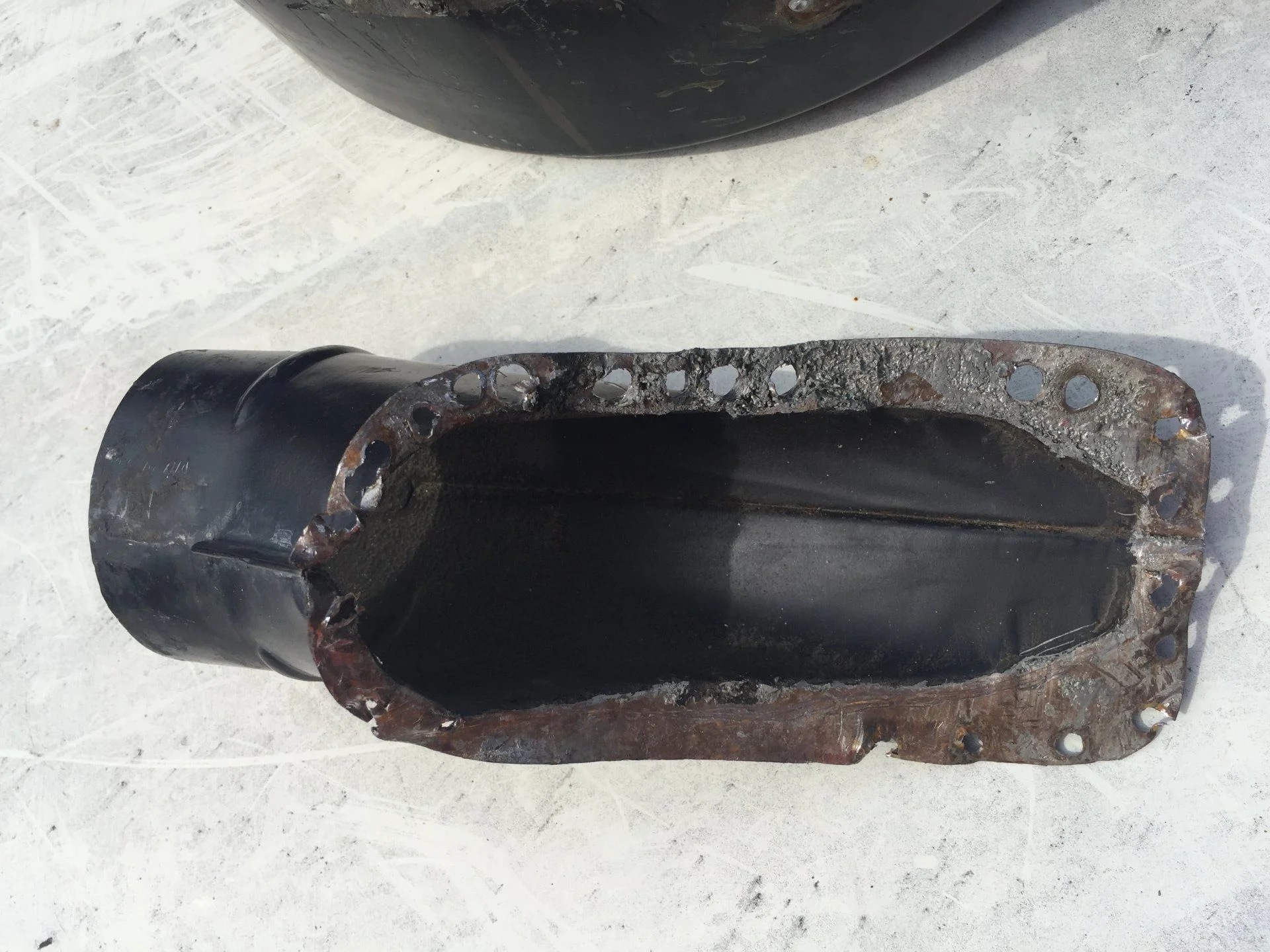

Now that I've got the EGT gauge hooked up, I've noticed that it's VERY easy to get into the +1200F to 1400F if I stay on the throttle. One area that I haven't modified is the air intake at the air clearer. Is a very small 2.5". I think this intake is restricting airflow at full throttle. Working on increasing intake size to 4". Lets see how it goes...
you could also get the top from a FZj80 1986/1987 model year, has bigger outlet and domed outlet top where the wingnut is at.
Yes, thank you. The outlet of the VM73 lid is something like 2"! VERY SMALL. I am using the top from a HDJ80. It has the 3" outlet. Working on increasing the inlet to the filter housing.

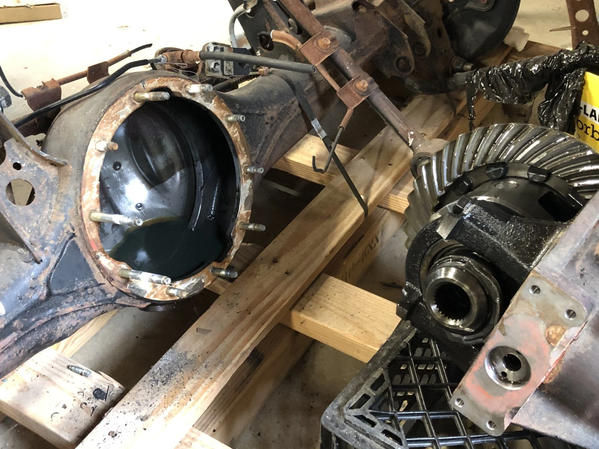

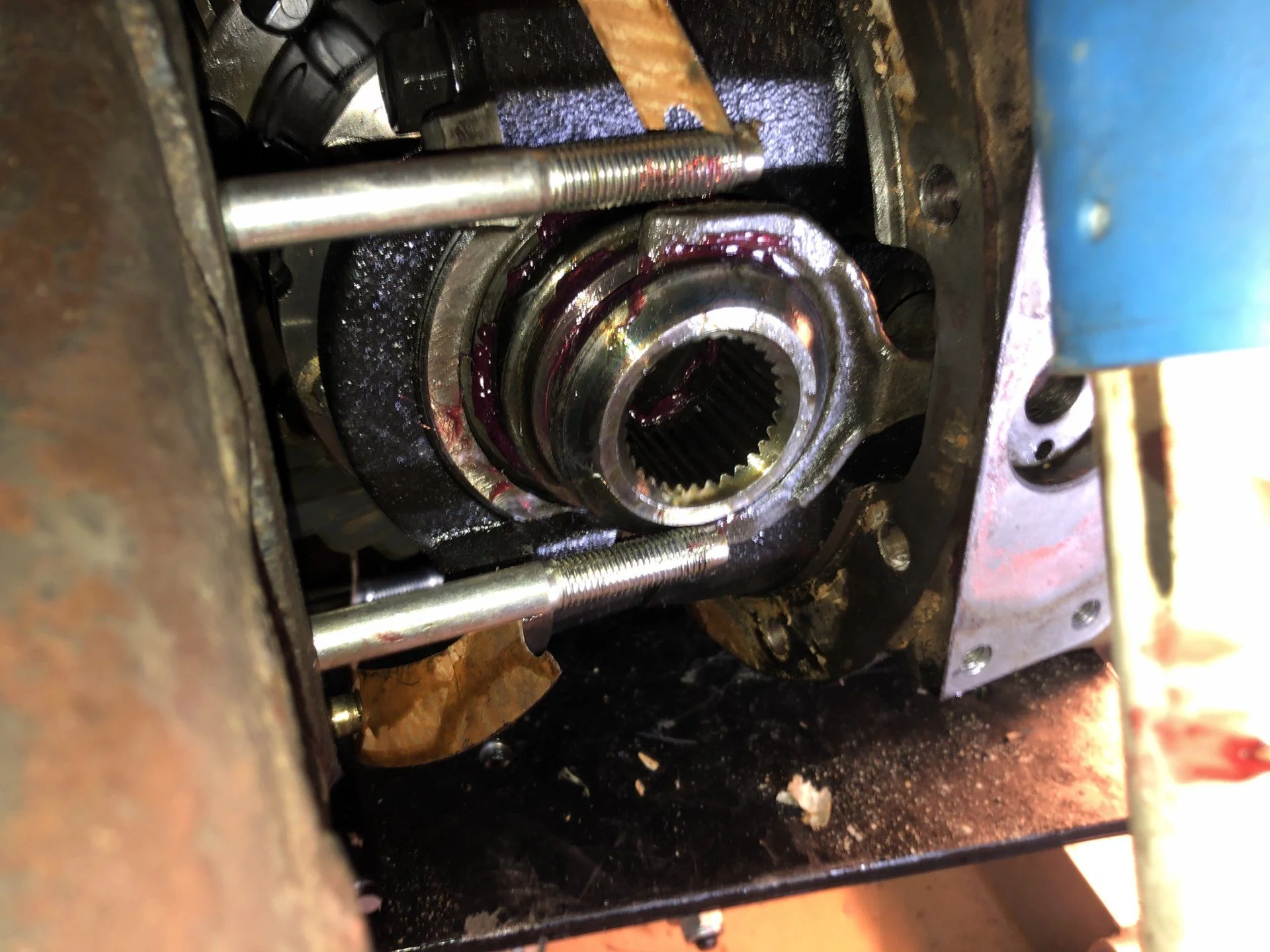

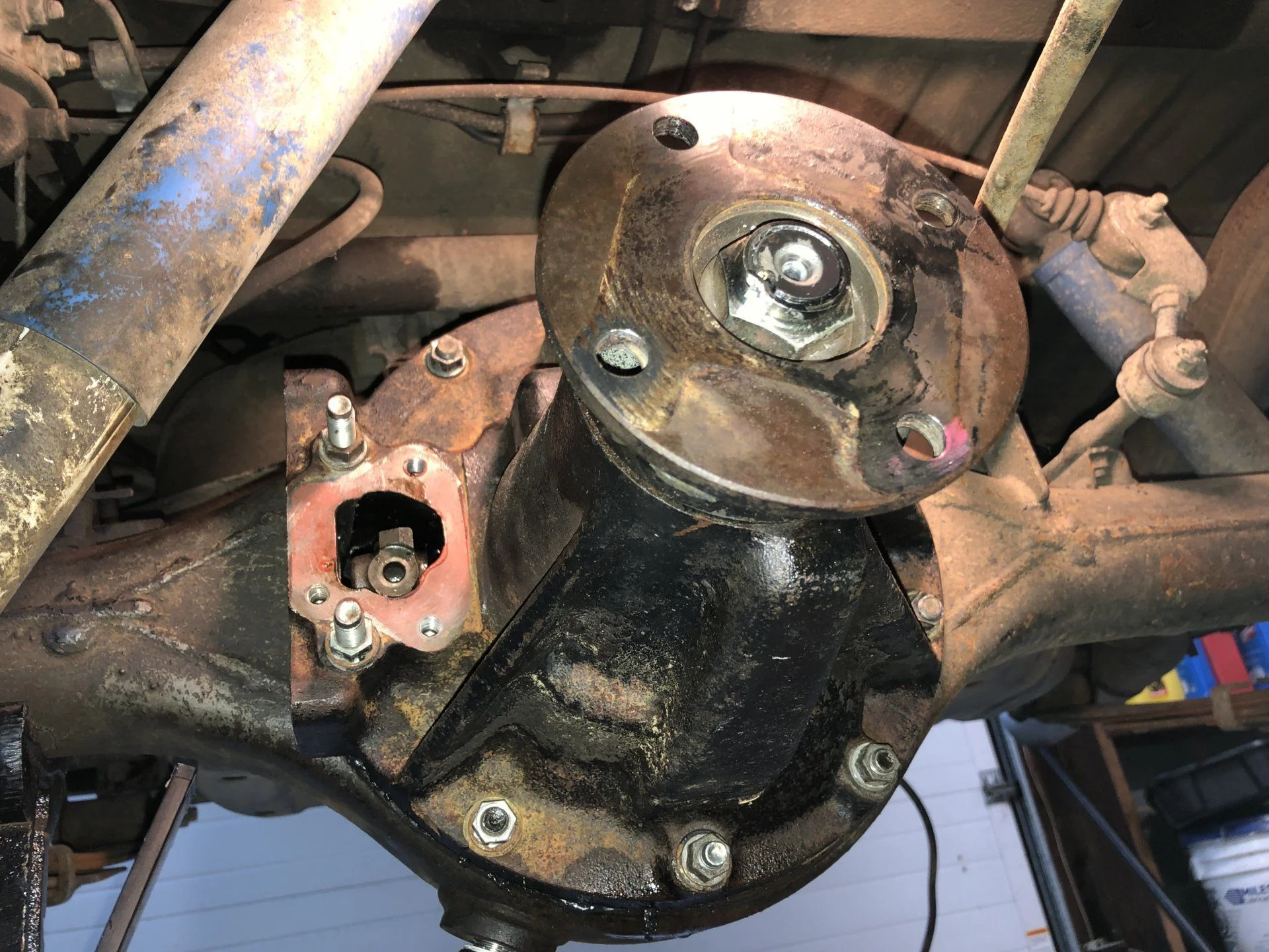

Currently, I’m working to install ALL of the various parts, bits and stuff I’ve been accumulating and getting the truck BUILT. I’m in the process of installing an 80 series elocker in the rear and a 80 series rear diff with ARB in the front. The VM trucks can with 4.56 gears, the 80s have 4.10. This is going to help drop the RPMs at highways speed and quiet things down for me. I’m not worried about power loss, but we’ll see how she drives with the higher gears.

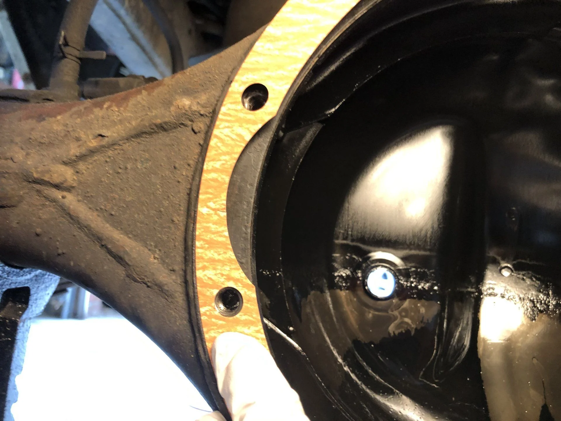

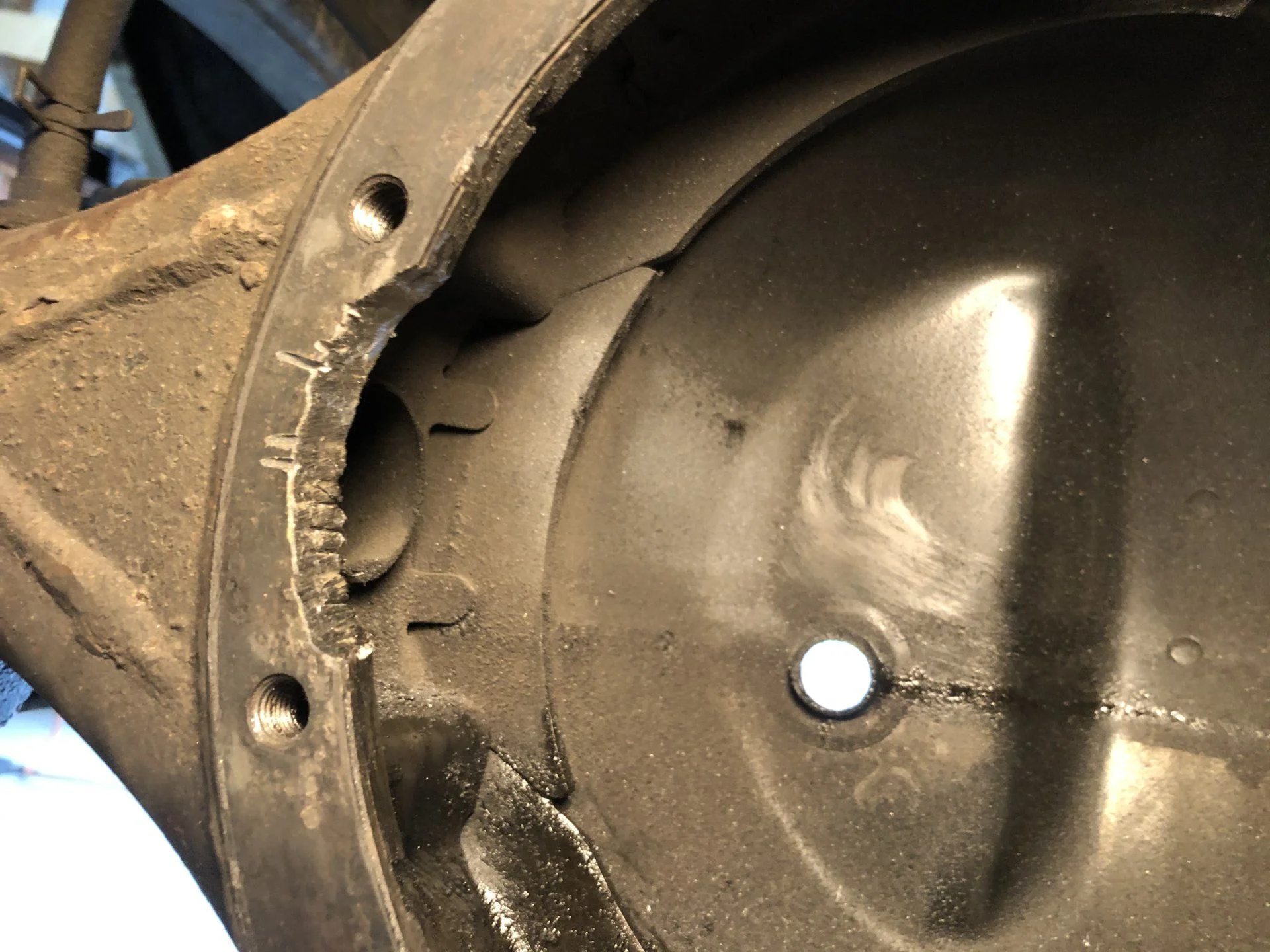

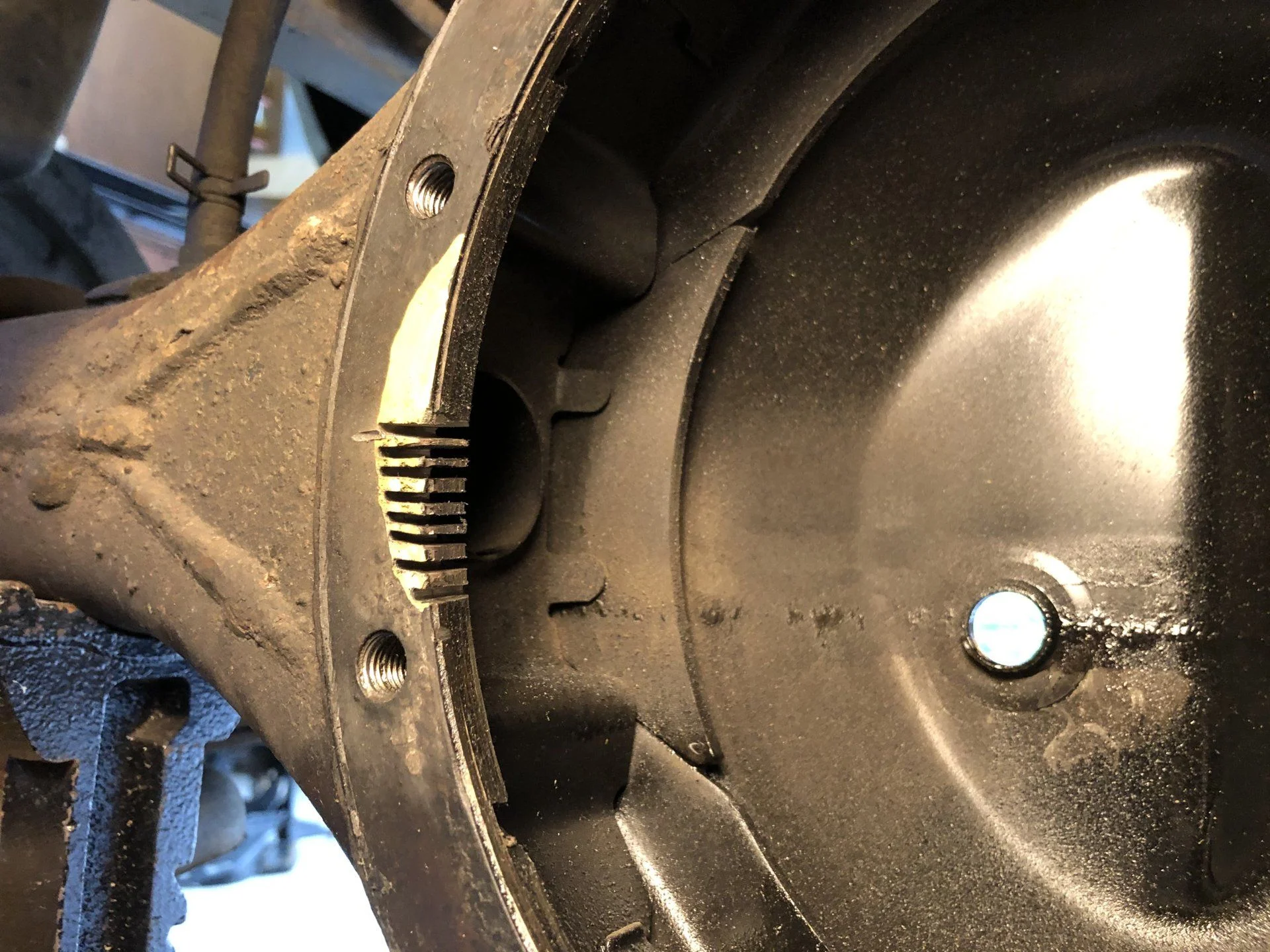

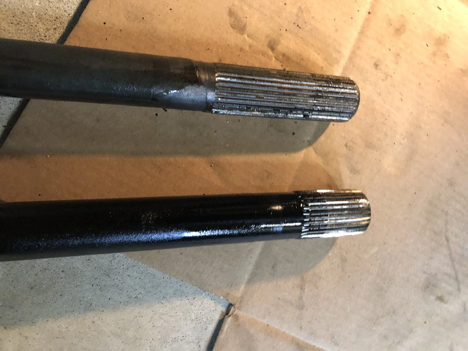

Install of elocker rears have been covered in other places. Changing to two longer studs and grinding away part of the axle housing was all that needed to be done. I used the elocker diff gasket to mark the area that needs led to be removed. I used a cutting disk to make a bunch of cuts and a grinding wheel to remove the rest. I also needed to get a short side axle with longer splines to work with the locker.
