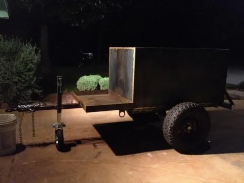

Our trailer I'm building.

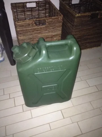

Our water jug I was thinking we would use.

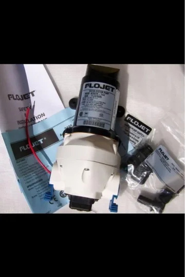

The pump I was thinking we would use.

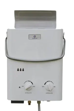

My other thought would be LP. If you are using it for anything else, you should pick up an instant hot water heater.

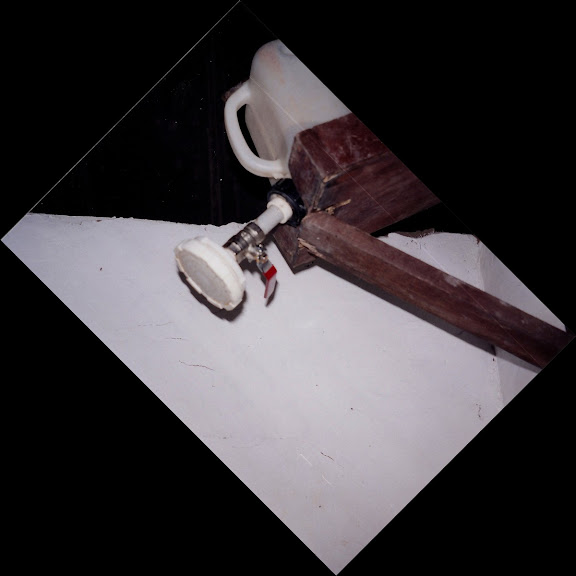

I did think about a simple setup like your friends, but when the heated waters out that's it. Also you have to shower before dark cause the water cools fast! I was thinking if we went hat route it would be a good idea to paint the container black so it absorbs heat better/faster?

LP on-demand water heater (calefón), also very popular here. Definitely bigger and bulkier than the Lorenzetti, but better heat and potential for higher pressure. The widow makers need fairly low pressure to heat properly, but you can pump a lot through a calefón.

That's the unit we use in our camper. Very easy to use, self igniting with water flow and any pump will do. Generally what I do is to heat up a 10g tank in recirc mode for about five minutes on "high". The water tank is insulated and the warm water is great for a family shower (three people). I don't like using the heater as an instant on option due to the scalding issue and not to mention the wasted water (as the temp go from scalding to warm you tend to waste the water).
The unit is not made with high quality parts so keep that in mind as you handle it. Mine is still in good shape but it doesn't move very much or very far from its nest in the tongue box. I don't disconnect the LP or the water hose at its base unless I need to do some PM. The one D size battery usually last two camping seasons, which surprises me a tad.

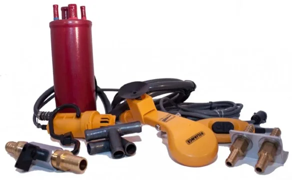

That's good to know its not super durable. I'm interested in having Helton heat exchanger as a back up or even as the main and the other as the back up. I've seen lots of threads on the Helton, but I've never been able to clearly understand the install...does it require you to tap into your coolant system? Can you or anyone recommend a build thread that's super detailed for slow folks like myself? Thanks all!

Ok so I found a good/basic article online about the Helton hot water system here: http://blog.campingshowerworld.com/?p=3
And here's a kit for sale: http://www.campingshowerworld.com/helton-hot-water-kit.html
I'm still not sure where to hook it up on our rig, but I'll take a peak under our hood. Should I buy a kit or just the heater core and build the rest up from there? I ask cause I'm wondering if the supplied pump will be strong enough to use for other things like transferring water between things or I'm wondering how far the pump could pump the water (say I wanted the shower 10-20' from the camp site). Also wondering cause i might like to pick out my own shower head. Thanks everyone!

I have that shower unit! It works well! It's hot here in Malaysia, so I have a 5 gallon water bottle in the back which is heated by ambient temps. Plug the shower into the lighter socket and away we go! It is not exactly hot water, but close to body temp and very refreshing!
I found couple of pics in this thread: https://forum.ih8mud.com/camping-outdoor-gear/543930-my-hot-water-project.html starting on post #35.
I have that same 12v shower head/pump combo as pictured above and have no complaints. To me, it's all about water conservation so a penny with a small hole is used as a restrictor in the shower head. It should work with a 25' hose I suspect. It's a very simple system and works in other situations as well (water transfer).
Should you buy the kit? Yes. It's easier to have everything at once and be done with it. Kurt also sells them http://www.cruiseroutfitters.com/helton.html
I really like the Tee fittings that are made for this kit vs buying/making your own Tee, but that's just me.
AC: I also have an L5 water heater. It works great for larger groups or maybe a base camp set-up. A couple years ago I was on a straw-bale building project and the L5 supplied 30-showers each day without a problem. We had an unlimited water source (well) so just turn it on, dial in the water temp desired and shower. If we have an unlimited water source we just turn the L5 on, dial in the water temp desired and let the shower water flow until each shower is done.
Otherwise for typical back-country camping where we're limited on water we just heat the appropriate amount of water in a Scepter water container or 5-gallon collapsible coated nylon bucket for maximum water conservation. Works great this way too...heats 5-gallons of water up very quickly. Then we just pump our shower water directly out of the water container.
I have a deluxe hand held shower head configured with my L5 system along with a Flowjet/Surflo 12v high pressure, auto-sensing, pump. I've gotten the flow down to .75gpm (drilled hole in the penny trick) at about 35-40psi. Its darn near like being at home :)
OTOH I also have the Helton Hot Water heat exchanger you have pictured above mounted to my 100-Series. I had the blue colored Helton Shower water heater prior to that but Ali wanted it so I sold it to him :D. The Helton gets used on every trip that is more than a couple days in length. It works great for smaller groups...2-3 folks is perfect. It will heat 5-gallons of water, enough hot water for 4 water conserving style showers, in about 10-minutes depending upon the water's ambient temp of course...sometimes shorter time and sometimes longer ;).
I also use a kitchen sink style sprayer for easy and quick water conservation apart of the Helton set-up along with a self coiling hose, Flojet/Sureflo 12v pump with water sensing flow shut off. The whole system is compact, quick to deploy and easy to use. And the non-Helton pieces fit into a laptop case.

Thank you guys so much for all this awesome info!!! I think I'm convinced to install a Helton in the rig and build my set-up (pump, hose, head, etc.) then also pick up the mobile LP system for larger groups and/or a backup. Now I need to just wrap up the trailer and take the family out! :D I'll post up once I get our system together.
