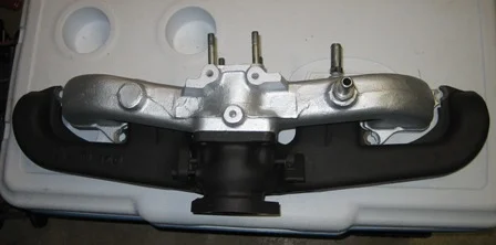

After about 60 views to this post and no replies I decided to try the POR 15 high heat manifold paint and report the outcome as time goes by. Maybe it will help somebody decide what they want to do.
Before I had both manifolds sand blasted I had to repair two threaded holes on the intake and work on the exhaust manifold where I had a crack where the stud threads into the manifold. Only time will tell if the repairs work. :steer:
I followed the instructions to the letter that came with the paint. Two light coats and wait at least 24 hours between coats. After that I took them to the powder coater that I use and he baked them at 300F for thirty minutes.
Ken :beer:
