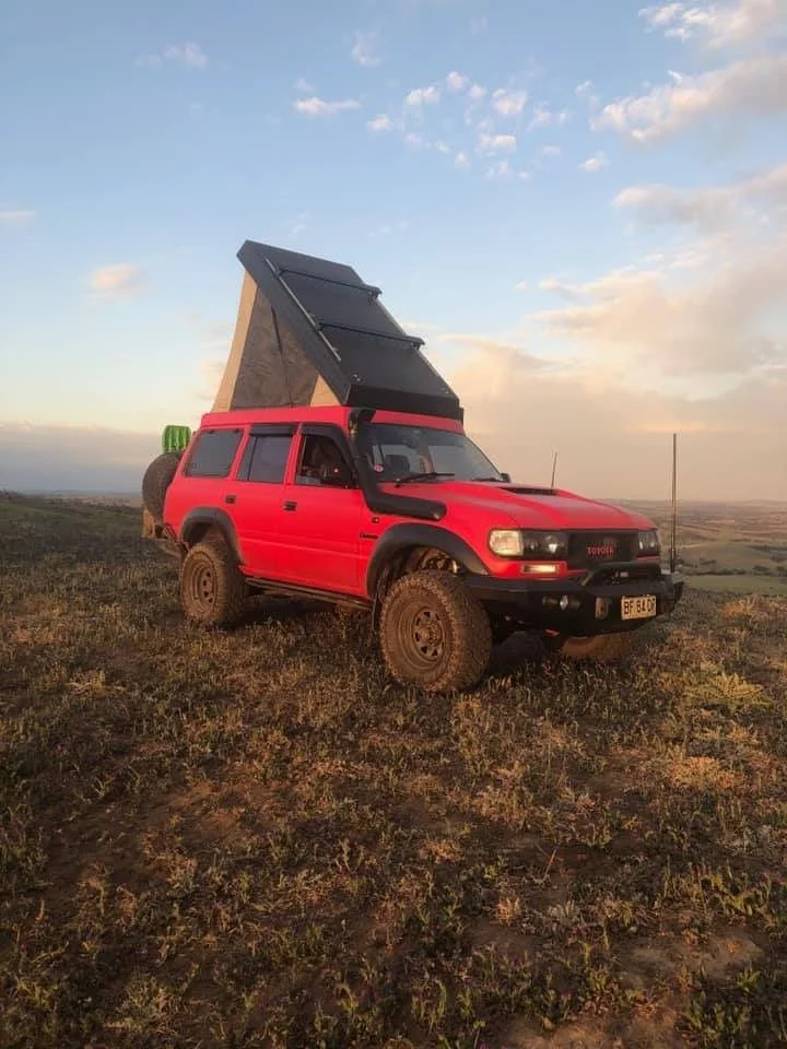

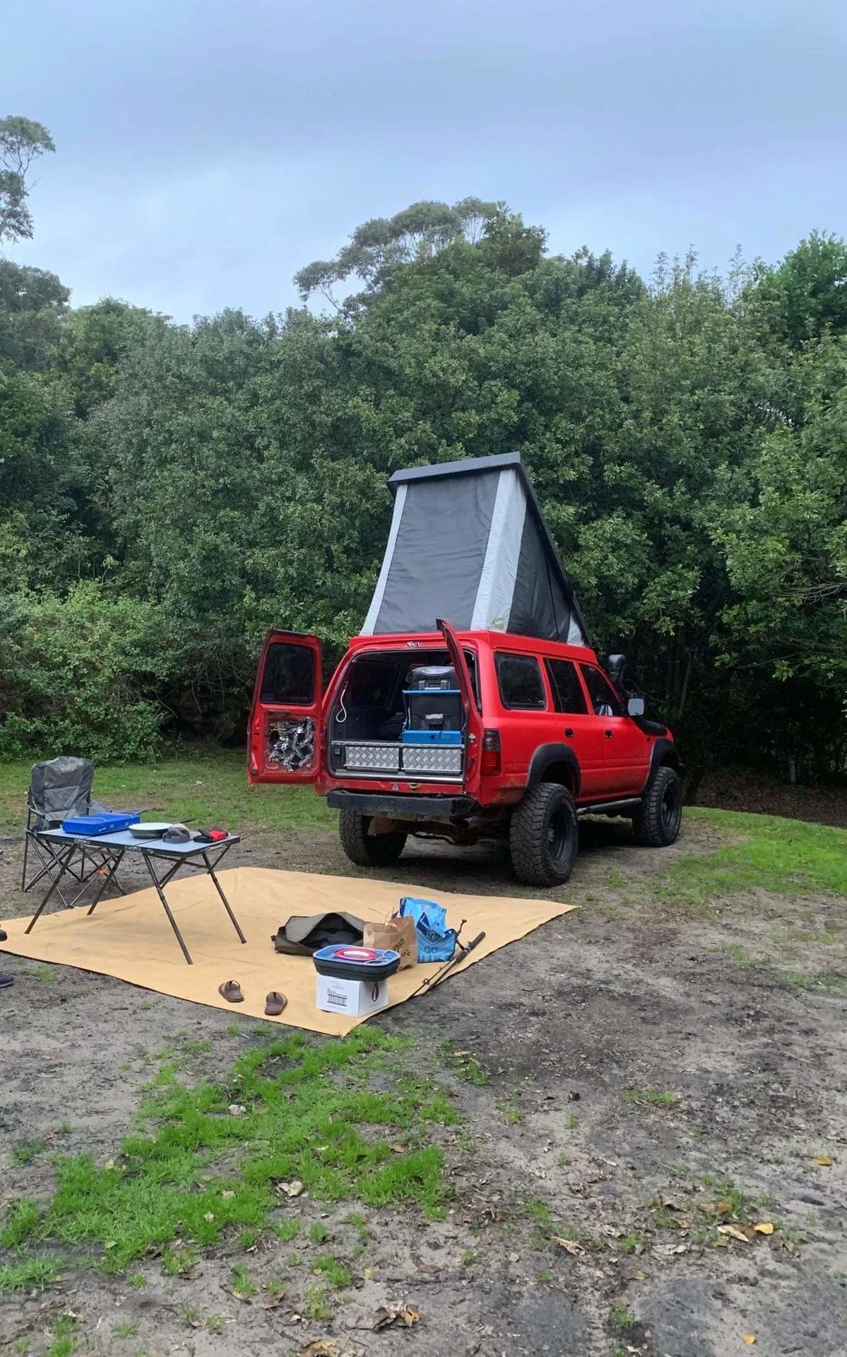

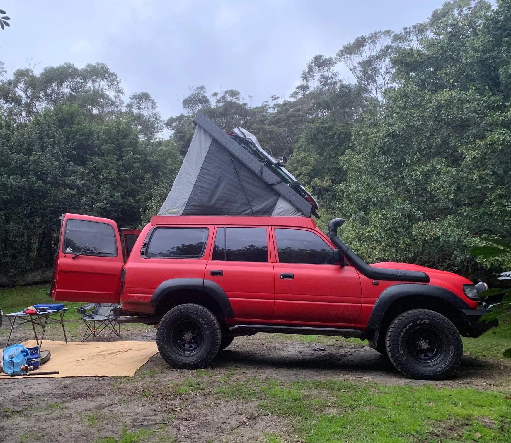

Campteq top is an option, I believe @Thecriscokid is still making them. These pictures are from when I first cut my roof a couple of years ago and made a bed platform.
Very nice work on your roof top tent install, but if you don't mind I'd like to add one suggestion. I've seen more then a few photos of 80's that have rolled over, and in all of them one thing always stands out. More often then not, the A,B, and C roof pillars on these trucks seem to crush easily, sometimes almost flat with the top of the doors.
Seeing as you've removed so much material and strength from the roof when you did your mod, For safety reasons I'd be adding an internal roll bar of some type. Just to make sure the roof doesn't completely collapse flat in the event of a roll over. Just my 2 cent's YMMV.
I totally agree with this concern, and spent some serious time weighing this out when designing this build. In fact that is why I only did a 3/4 cut as that leaves some of the roof and the larger factory brace to support the sunroof area (B pillar) I even left half of the sunroof tray ( that has a hardened steel core) in place as that supports the roof as well.
The D pillar is still covered by the roof as the cut is inboard at the back, so only the C pillar is compromised. Part of my build is using a very strong Polyurethane sealant to secure the top to the roof, I also used 8 gutter clamps to re-enforce the adapter.
Having said all of this, I am hardly forging new ground as this build has been done many times in Europe and Alu-Cab does the same out of SA with the 78 series that has the exact same pillar setup.
A catastrophic accident can happen to anyone and it is an accepted risk on my part. I do not rock crawl with this vehicle and dont drive it fast off road as that is not what over-landing is to me.
