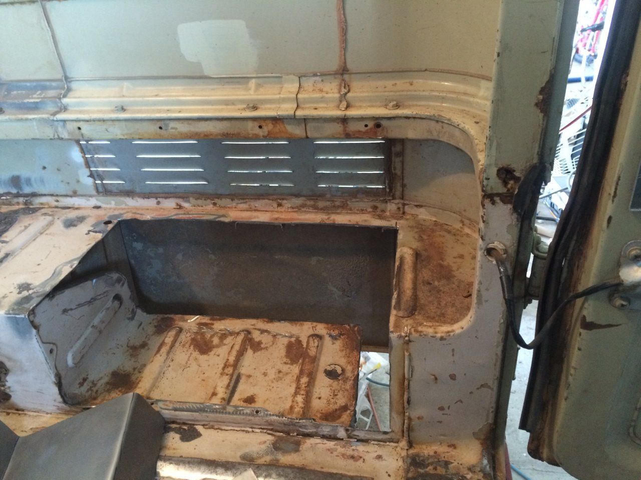

Well, my son and I decided to start looking into redoing the interior of the Troopy. The plan is to temporarily patch floor rust, do the camper interior and underside (water tanks, water pumps, propane lines, etc...) and in the future (a few years) take it apart and do the body. One problem we have, is that it leaks when it rains, it leaks a LOT. So off came the roof to be able to have the canvas part of the pop top redone, and to replace the rusty rain gutter and corresponding seals.
Now the challenge is finding a rain gutter for a Troopy, SOR has a fiberglass gutter for a Troopy, but is pick up only. CCOT has metal gutters for the 40, but not for the Troopy. I have e-mailed them to see if they can help with making longer pieces or supplying extra pieces and adjusting on my end. If that does not work, it looks like I will need learn to fabricate the parts, by following some of the threads here. The rain gutter is more than I was expecting to do at this time, but we could not re-do the interior if we had water leaks. So, here we are. We also have rust on the upper side panels (posts right behind the doors), the posts that the doors close against. We will need to get this rust fixed. Either we buy a welder and learn to make the parts or we have it done. I have not decided yet. Probably not the right location to start learning to weld and make parts. Will post photos of this area later, just noticed I don't have any with me.

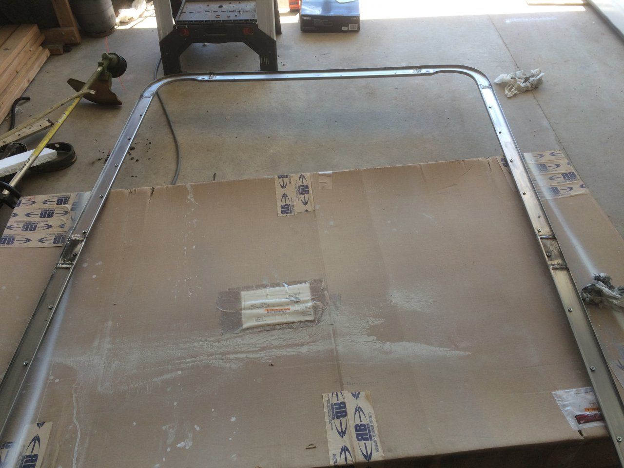

Watched a couple of youtube videos and taught myself to weld. So I proceeded to weld the roof gutter. Managed to get it primed and painted.
Next is to rivet it to the fiber roof and new headliner. After that is to re-assemble the pop-top part of the roof.
The gutter has 2 extra straight pieces (one each side) from a 40 gutter + about 5" of my old gutter that I managed to save, to make up for the Troopy length.
CCOT shipped me 2 extra straight pieces to accommodate part of the Troopy length.

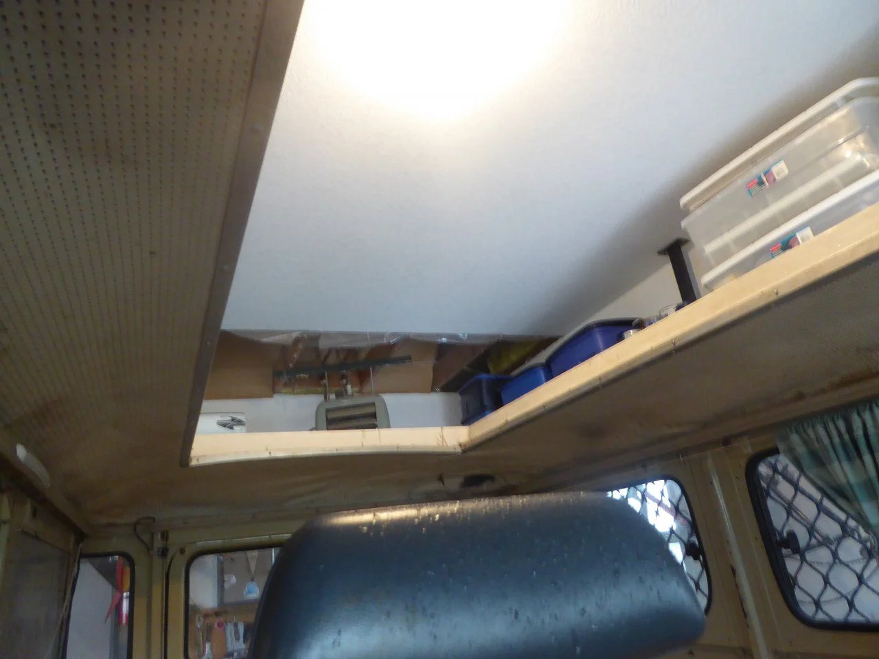

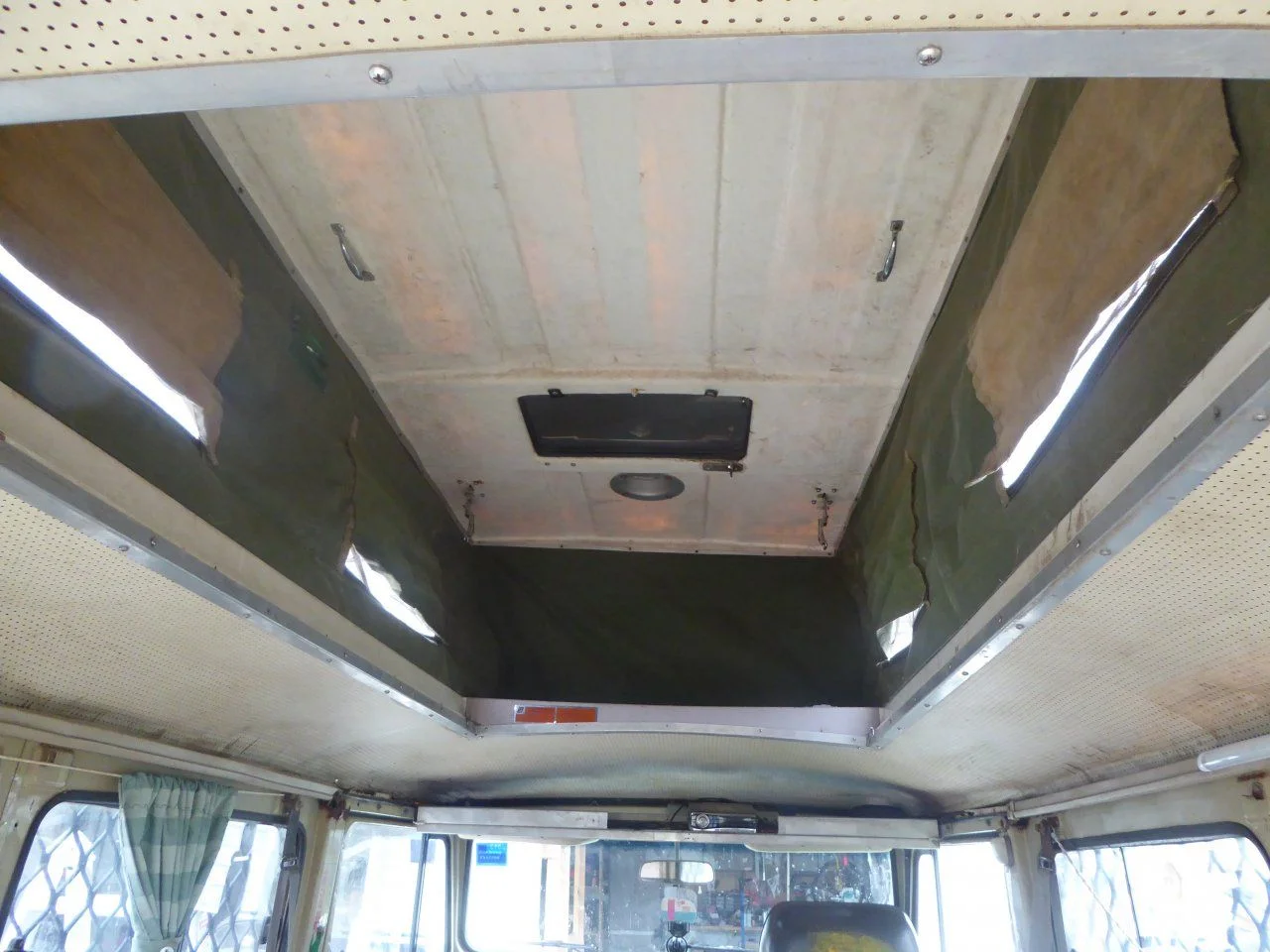

Making great progress! While you have the roof off, could you take some detailed pictures of the pop top?
I am curious as to how it is supported.
