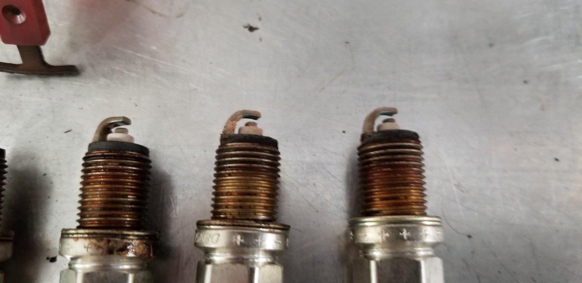

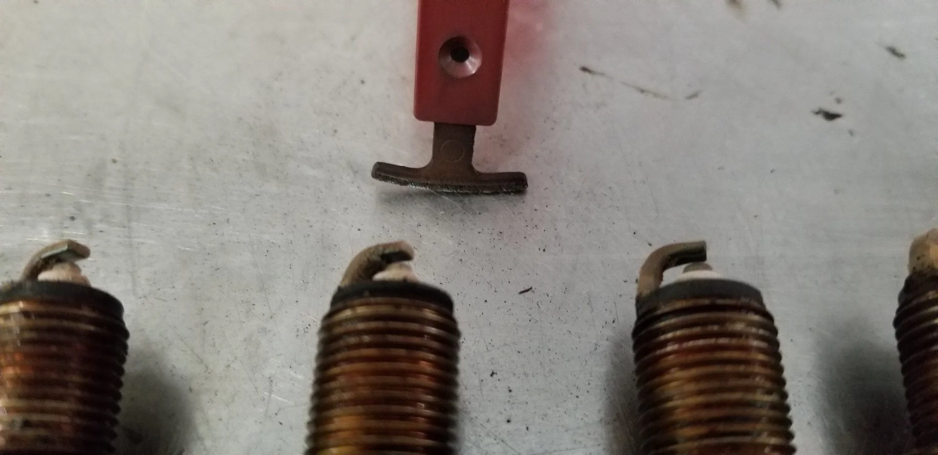

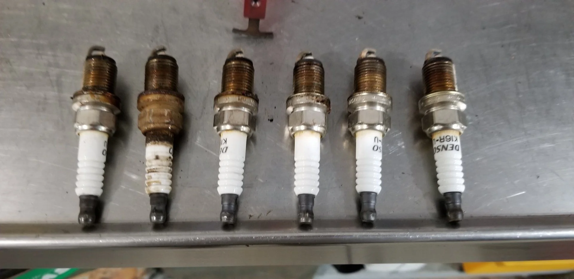

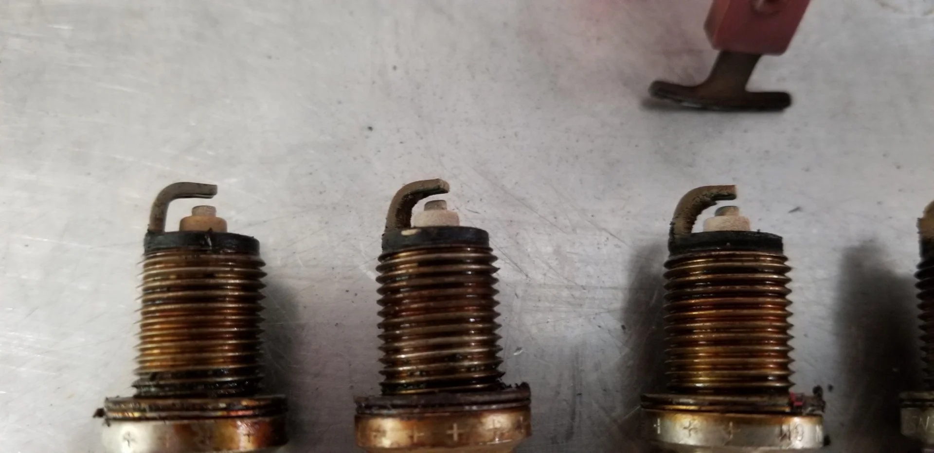

Starting with 6 at left to 1 at right and the rotor.
6 - 5 - 4 in that order ... 6 looks awful dry
6- 5 - 4 tops ... nothing unusual
Plug 5 top was dirty likely because the protective boot on the top that meets the valve cover was partially torn off ... thanks to the PO.

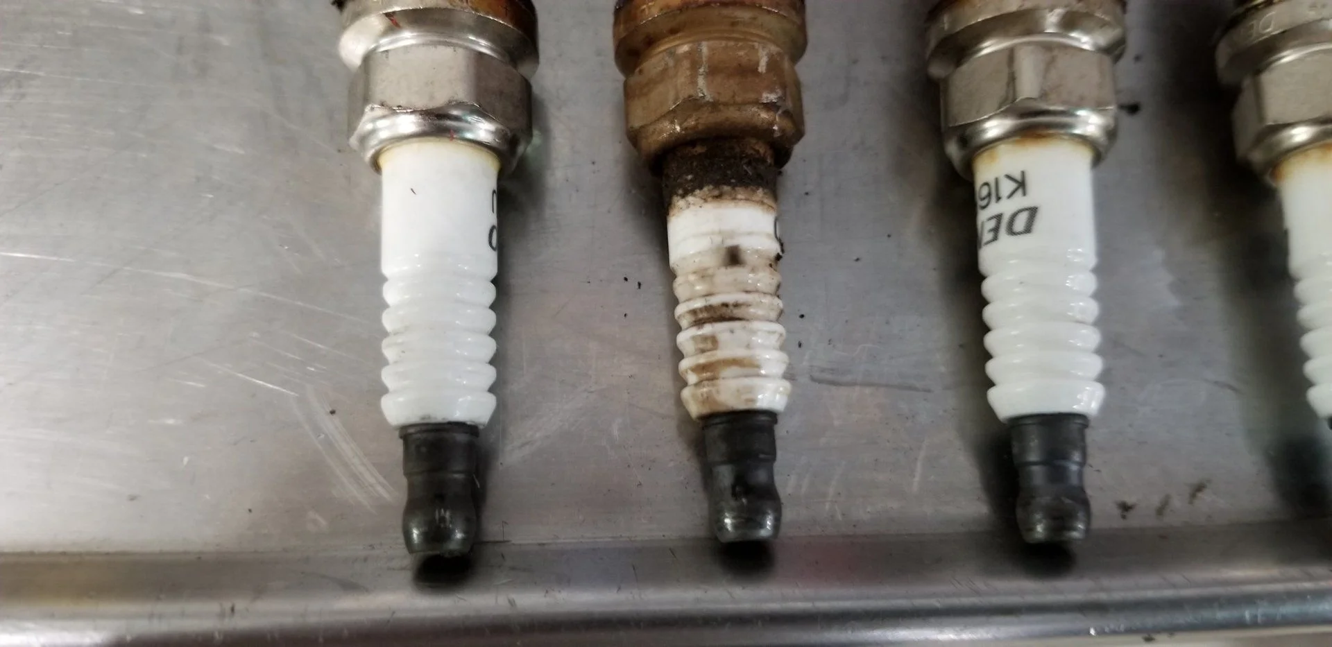

3 - 2- 1 ... 3 looks great, 2 looks like crap
3 - 2- 1 ... again all look just fine to me
rotor looks a little beat, cap had normal wear
None of the wires had discoloration that I would expect from arcing. All of the plugs looks lean to me, thoughts?
