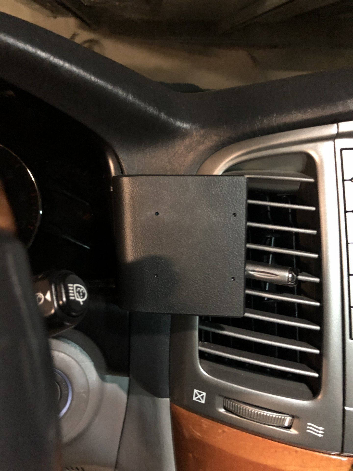

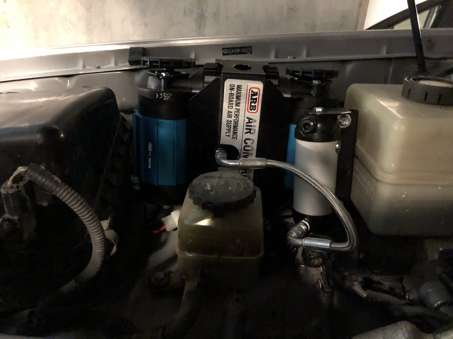

Two questions:
1) I really like how you externally routed the light bar harness. Any interference with the hood closing? Any additional wind noise?
2) The @BenCC supplied switch mount - did it fit with your LX overhead console? Mine is pretty small (with useless garage opener, I thought you need the LC version to make it work!)

Two questions:
the switch mount does not fit the small-opening overhead console

There is some interference with the wiring and weather stripping on the hood. My wiring was sealed and I added some additional loom for protection.
My LX is an 07 and has the homelink upper console with a larger opening.

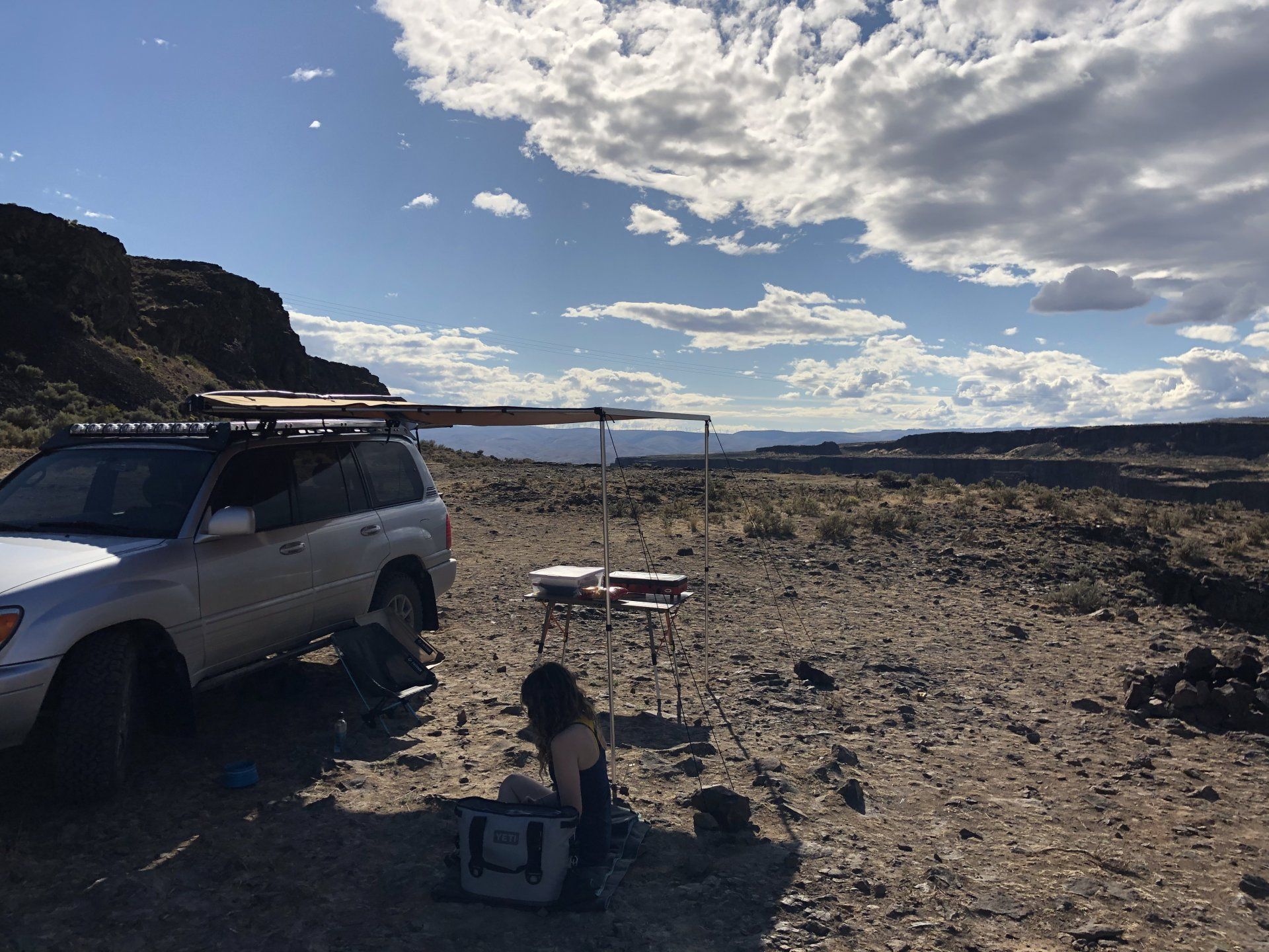

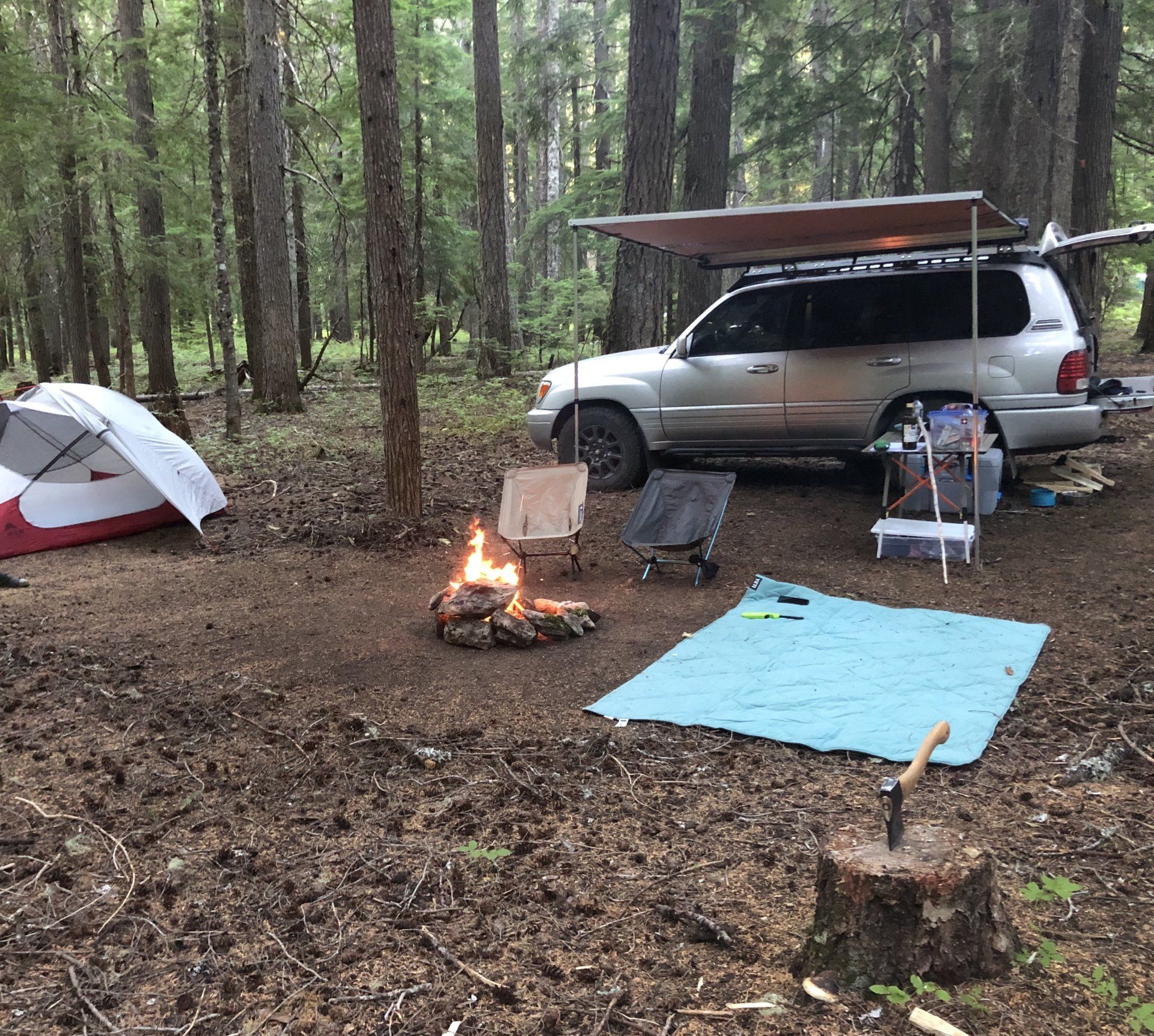

Went camping this weekend at Frenchman Coulee in the Columbia River Gorge with the new awning setup. ARB 2500 awning with Dissent high rise awning brackets. Thanks @benc!
Good stuff. As I posted on another thread, I really need to get out of Florida! Maybe I missed it but what light bar is that?

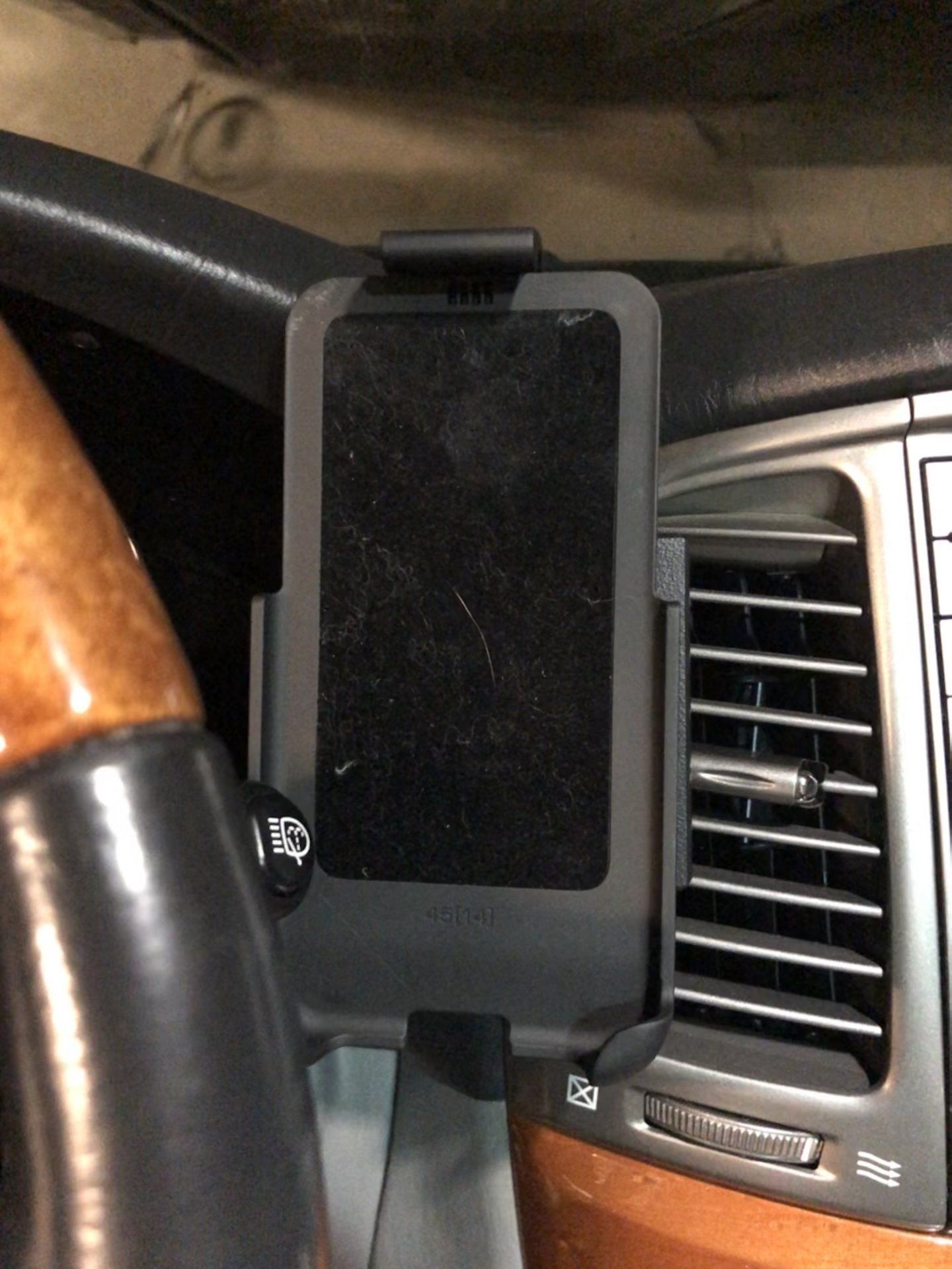

Installed a Proclip phone mount. Bought an Encase belt clip phone holder instead of coughing up major $ for a Proclip holder. Tested it offroad this weekend and it works really well. No shifting, shaking or wobbling.

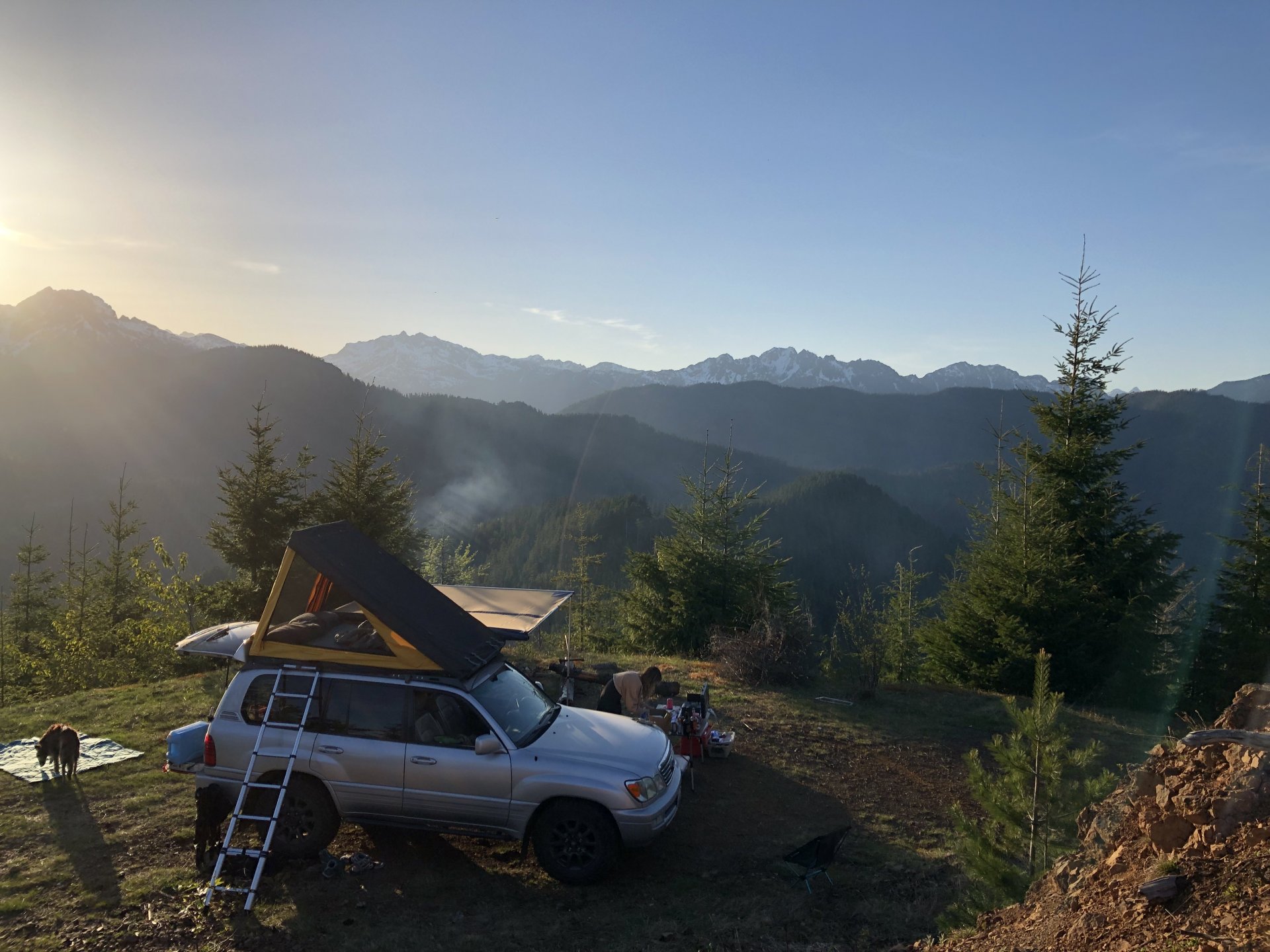

It’s been a while since I posted an update. The cruiser was coming up on 180K miles so I took care of some preventative maintenance. Full timing belt job was completed - all pulleys and tensioners were replaced, wheel bearings were repacked, diff fluids changed, Fresh AHC fluid and power steering fluid replaced.
Also added a GFC Superlite RTT. It’s a huge upgrade from the ground tent I had been using. Shots below from a campsite I found in the Olympic National Forest close to the Hood Canal. It mounted direct to the dissent roof rack with no issues.

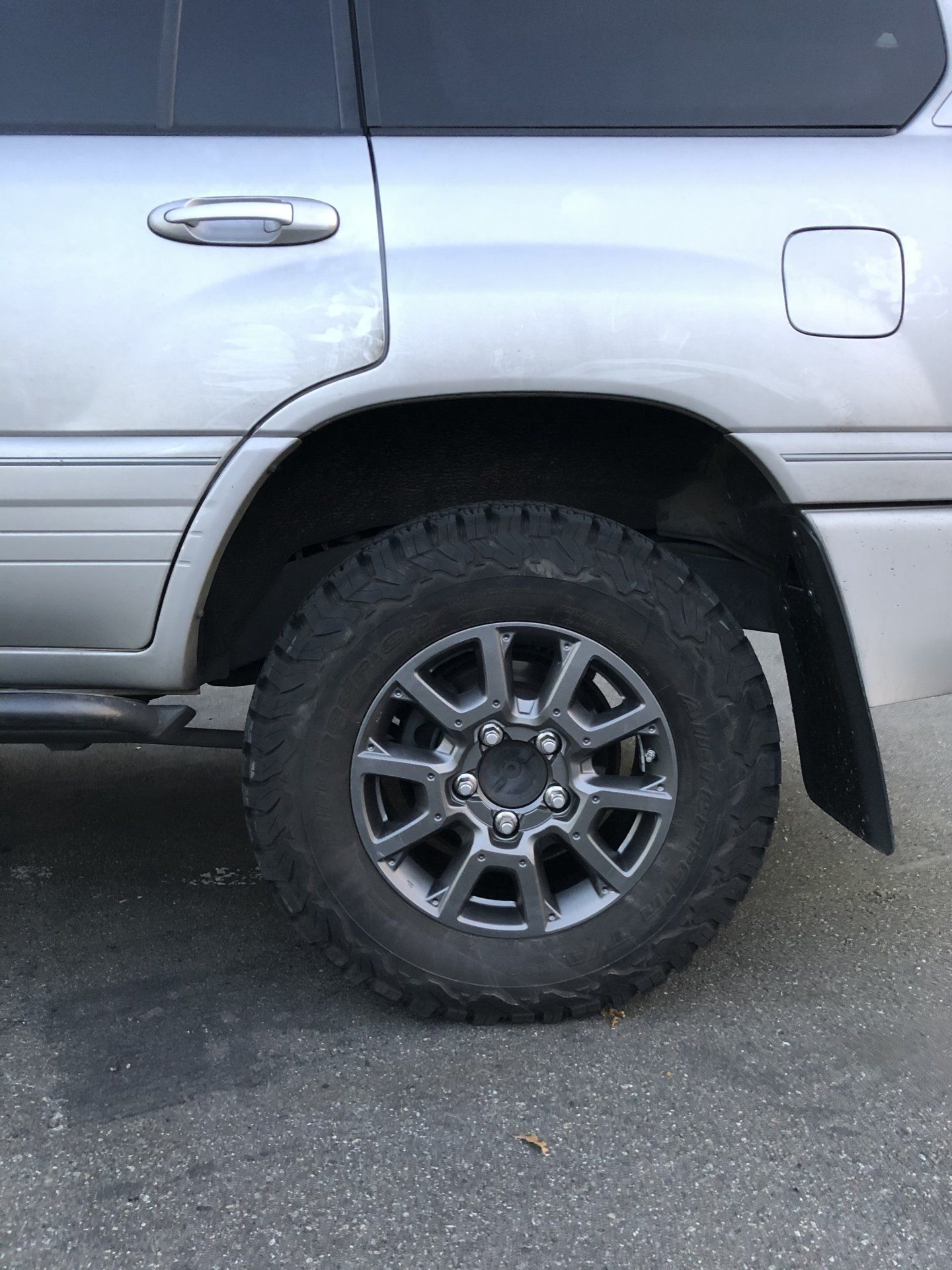

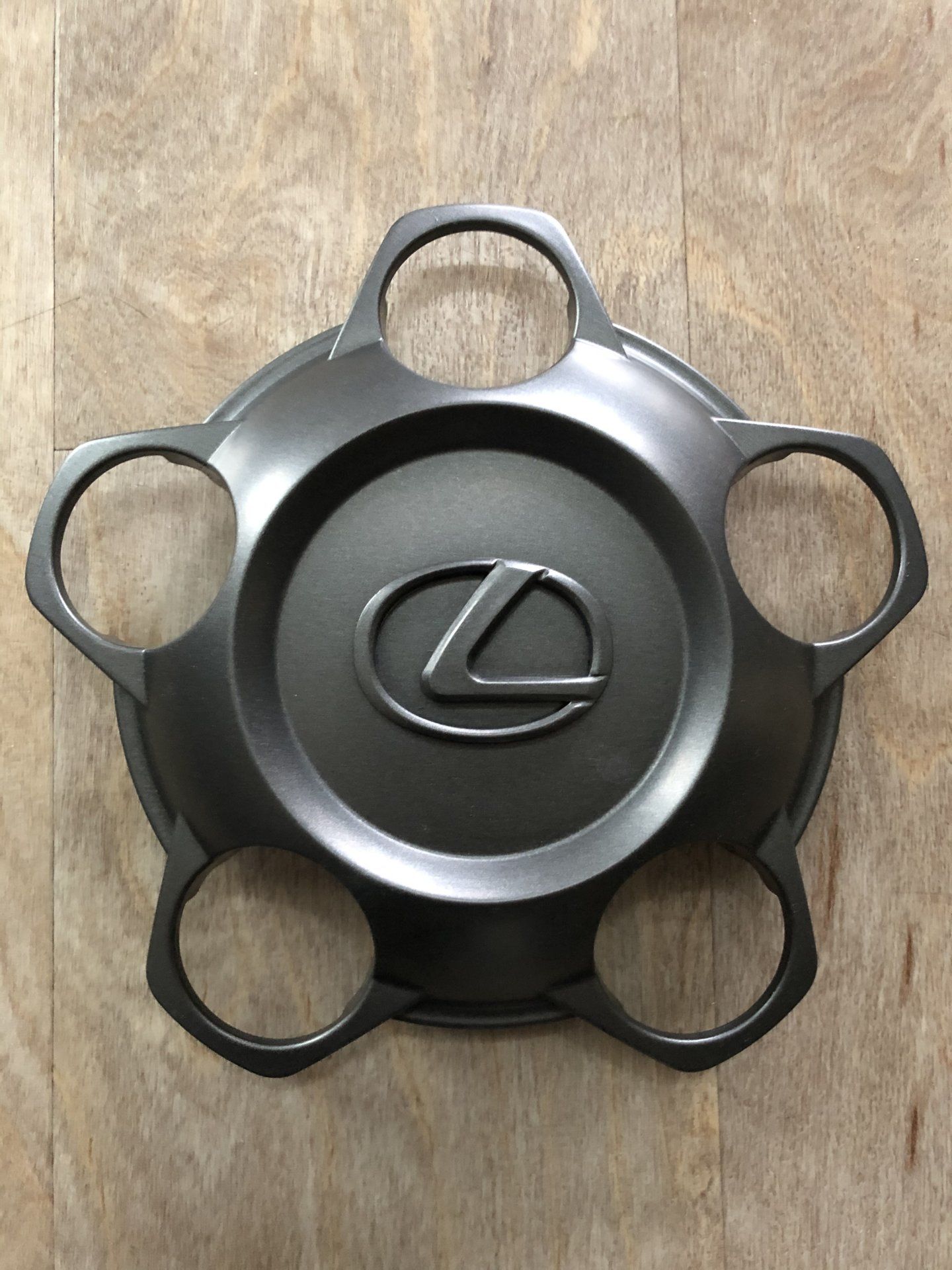

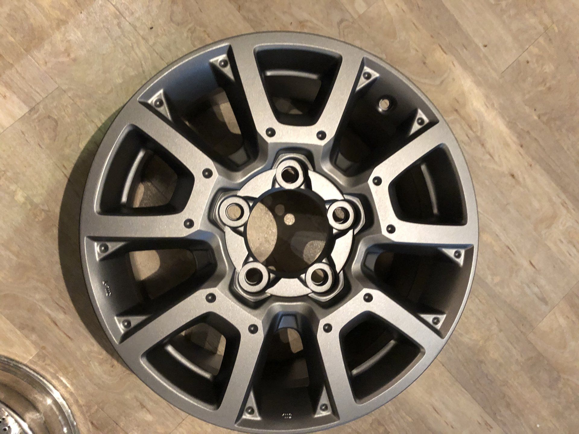

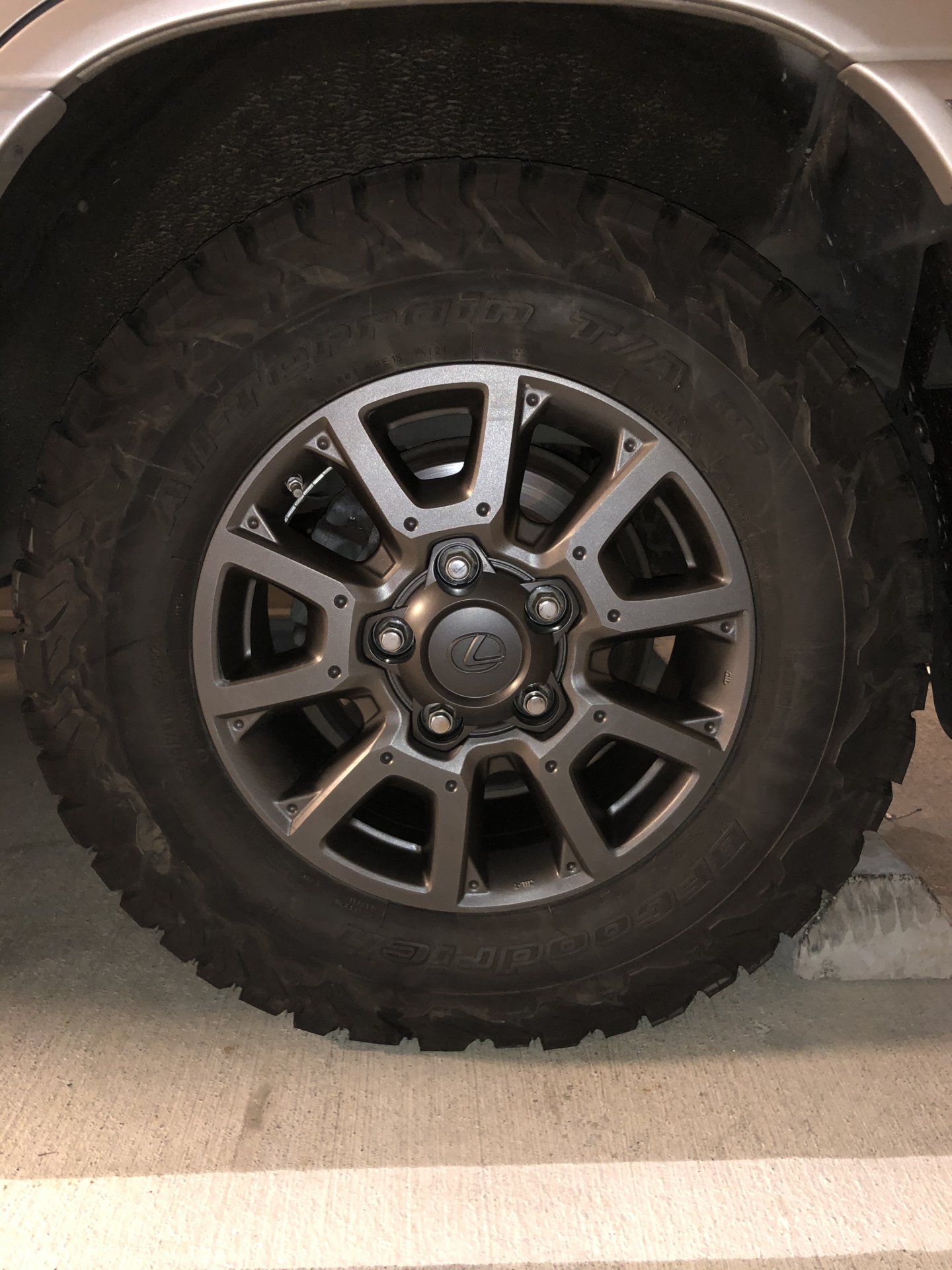

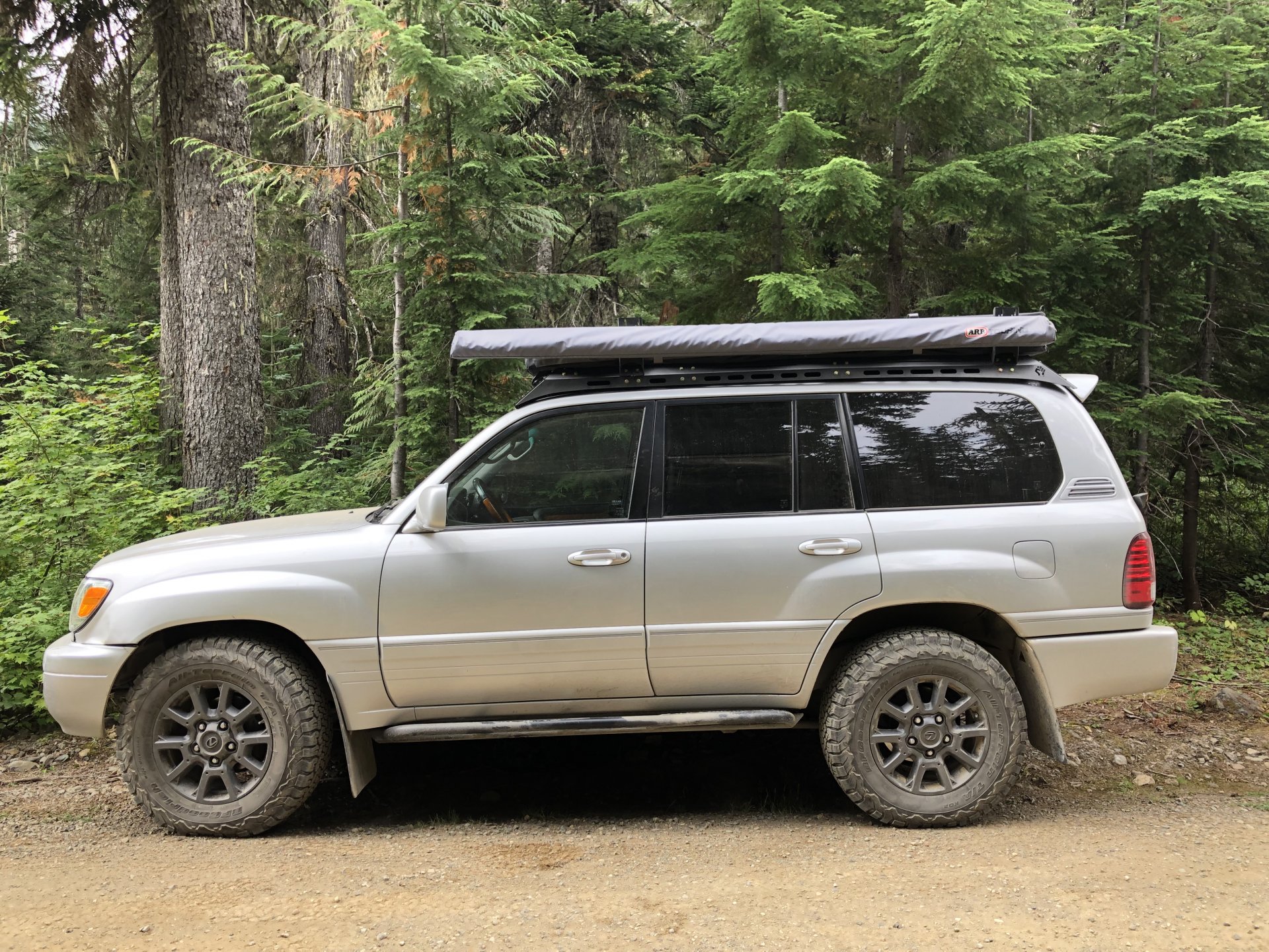

Purchased a set of Tundra wheels off craigslist and had them powder coated in a matte grey. Tried my best at color matching the center caps using anthracite plasti dip. Close enough for me. Also coated all 5 wheels with a 9H ceramic coating.
now that the chrome wheels are gone I think I need to change my cruisers name ... open to suggestions.

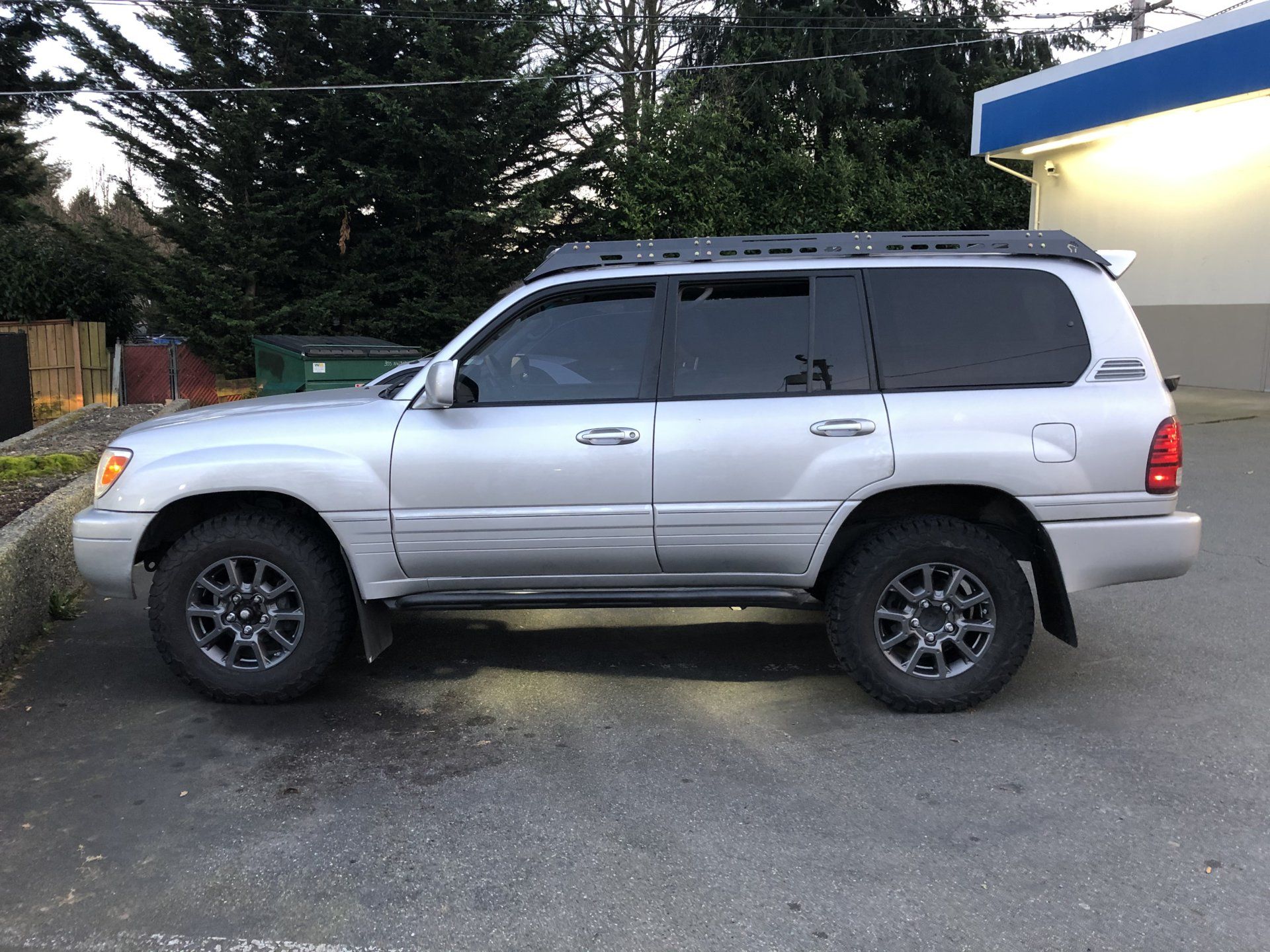

I also swapped out the tired rear springs with new LC AHC springs. The original springs were pretty compressed from 14 years of use. Ride quality is definitely improved.
View attachment 2242518View attachment 2242519View attachment 2242520View attachment 2242522View attachment 2242521
Did you have to use any spacers for these wheels on your rig with stock AHC?
No spacers needed. Only issue is you can’t run front center caps without modifications to either the cap or the front hub dust cap.
