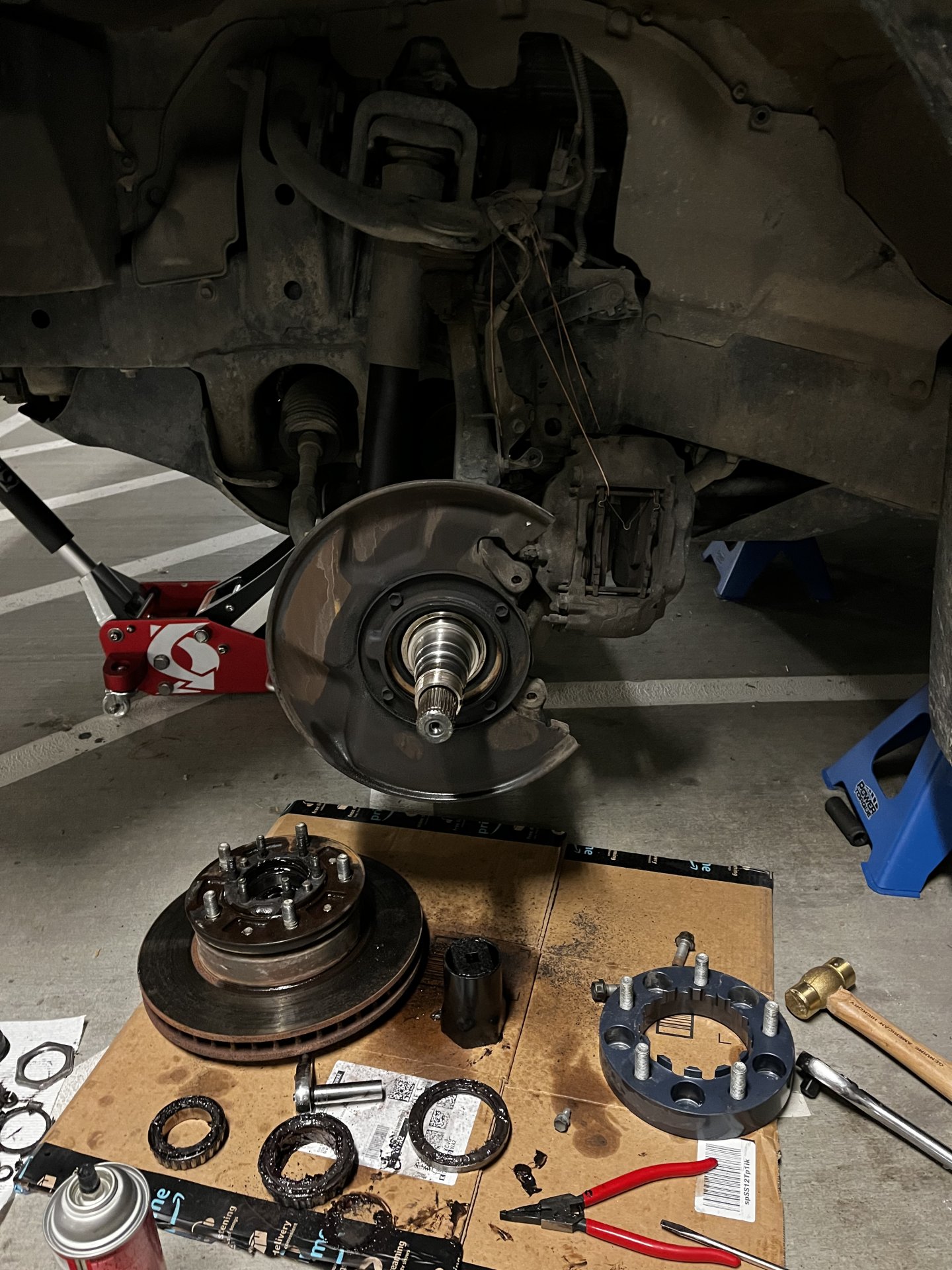

Also been taking care of some regular maintenance items. Replacing pulleys and new wheel bearings from Cruiser Outfitters.

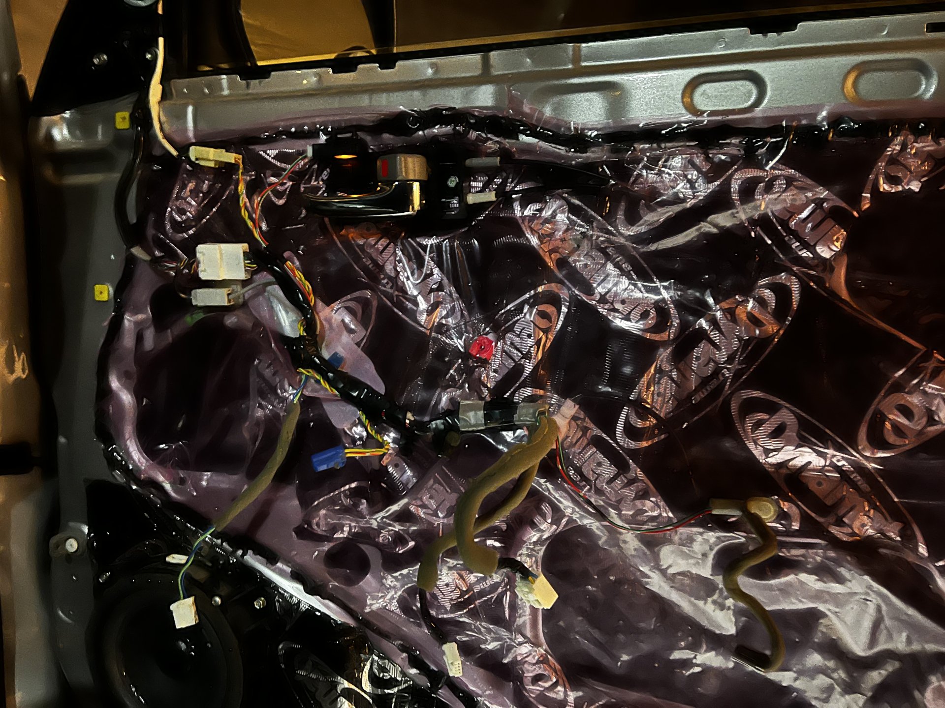

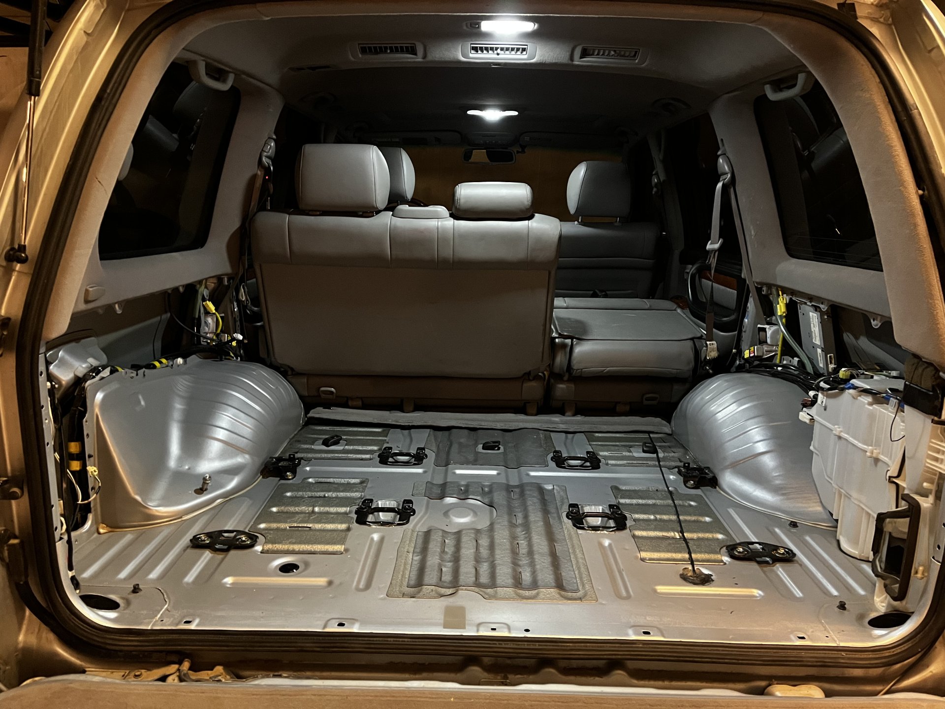

Installed dynamat extreme on all four doors and behind panels and under carpet in the cargo area. I forgot to snap a photo of the rear after the dynamat was installed.
Cargo area torn down.
Dynamat installed don front door. I applied two layers on both inner and outer door panels.

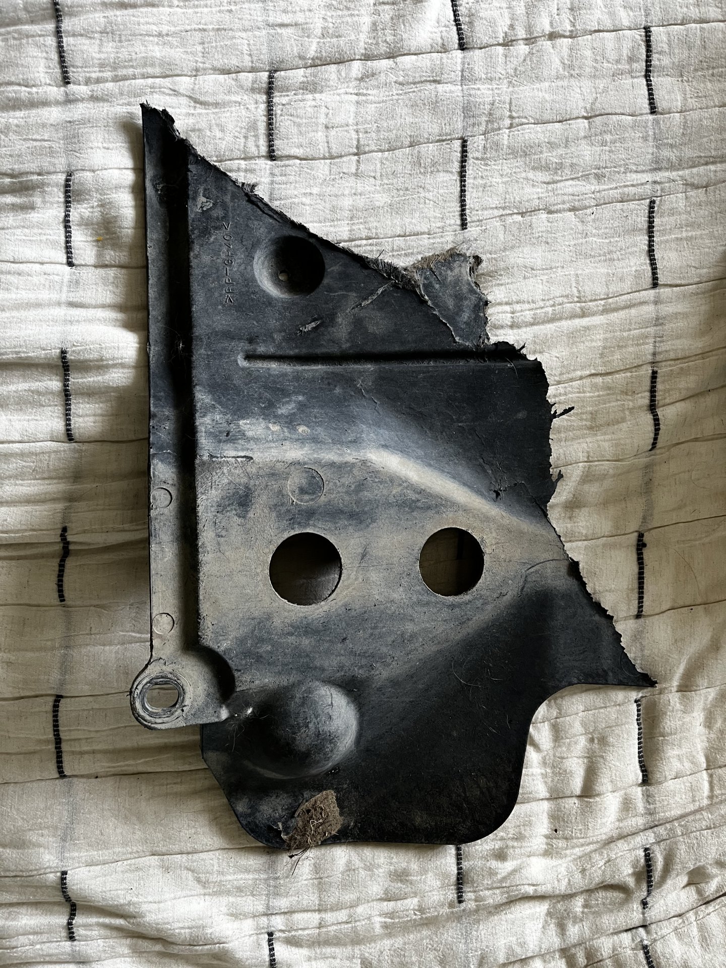

My secondary factory skid plate has been cracked since I’ve owned the vehicle and it finally gave up the ghost on a water crossing this past weekend. Great excuse to order some Dissent skids!

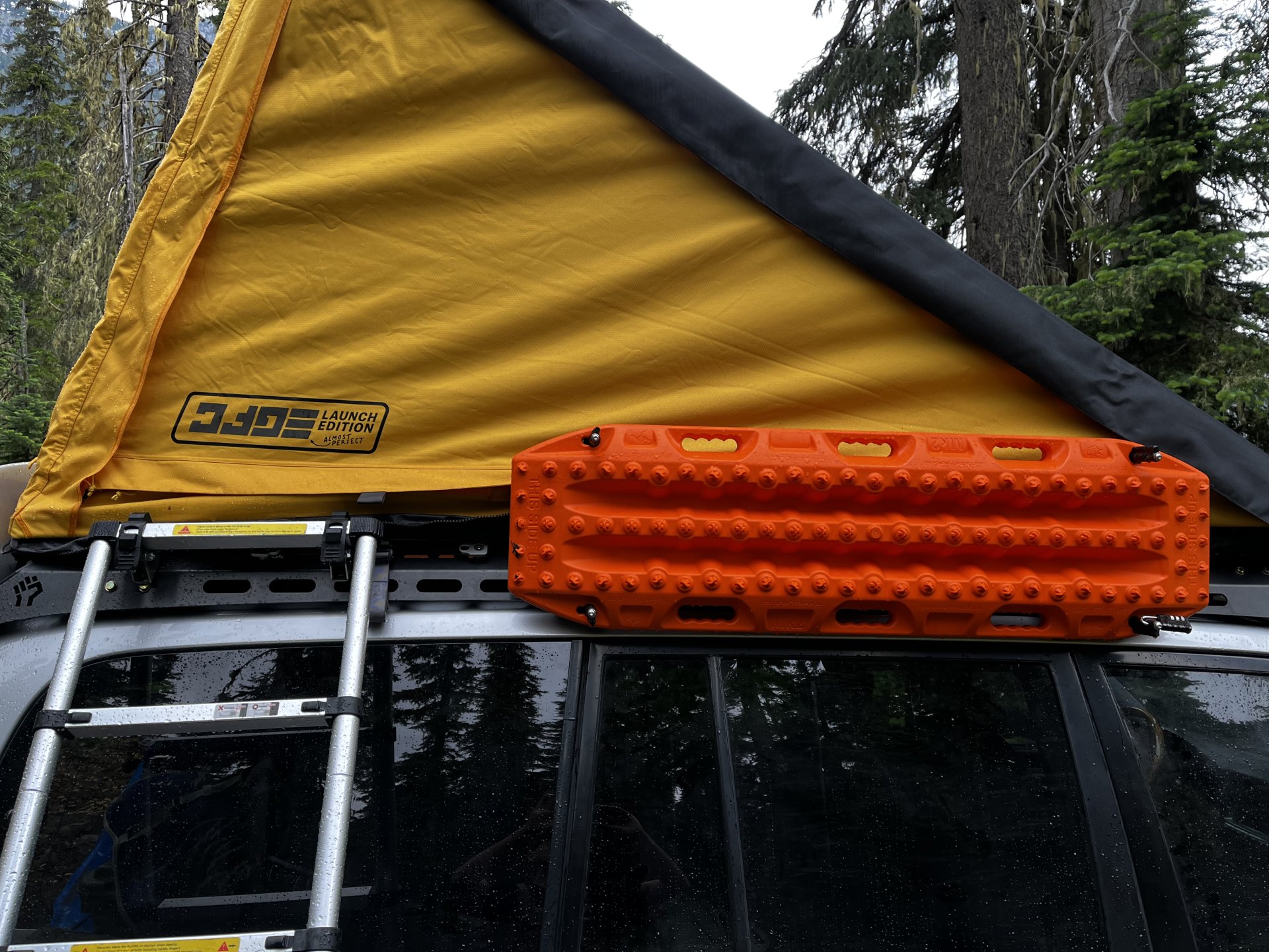

I also installed Maxtrax mounts on the dissent rack using a combo of their new design high rise awning mounts and JW Offroad Maxtrax plates. To the left of the Maxtrax, two quick fist mounts serve dual purpose to hold the rtt ladder and a shovel when in transport mode.

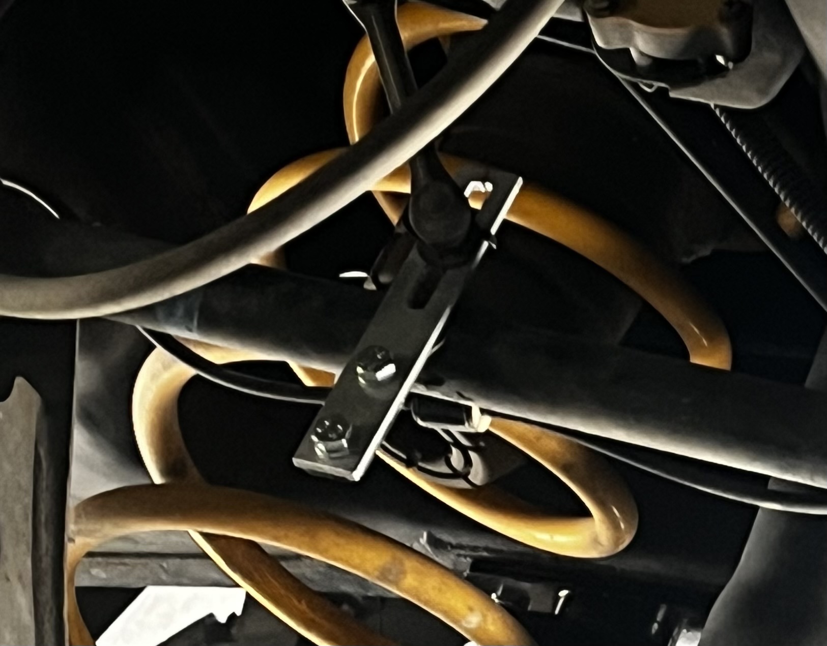

Made an aluminum bracket extension to dial in the rear lift after the AHC shock spacer install.

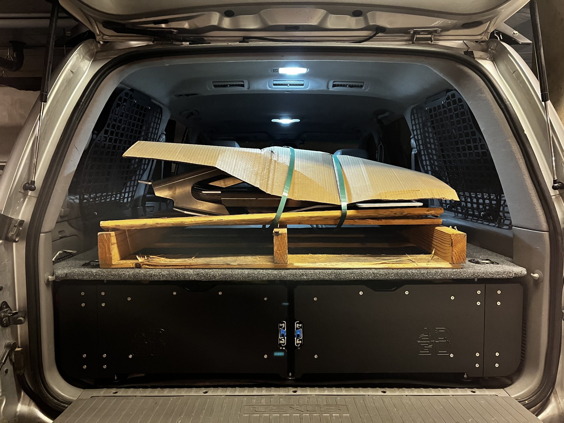

I forgot that I also added an Alucab tilting fridge slide in the back bolted to my ADGU drawers. I sourced custom length hardware with captive nuts to keep the underside flush with the aDGU platform. The XS slide fits the Iceco APL35 almost perfectly.
I ditched the strap Alucab provided and used two 2ft roller cam straps to secure the fridge. This allows for quick removal when not in camp mode.
