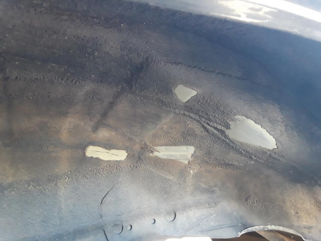

Some of you might be wondering why I'm asking about jumping a 200 series and then some of you have driven with me before. On my FJC even with 33's I would rub the upper plastic fender liner on hard landings. With 35's it ate the fender liners.

I've only had the rears rub the upper inside fender, at complete full compression with all weight on one rear tire,compressing both the susp. This was on 35 Toyo M/Ts.
