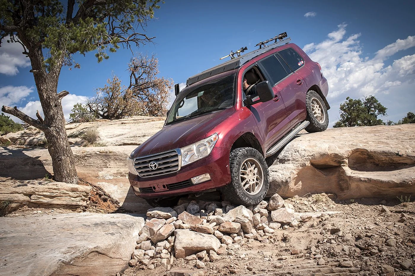

Not the stock 570 20s, but tundra 20s survived in Moab. My wheels didn't look any worse for wear than anyone else in the group. Most were running rock warriors.

That is the ARB bumper.

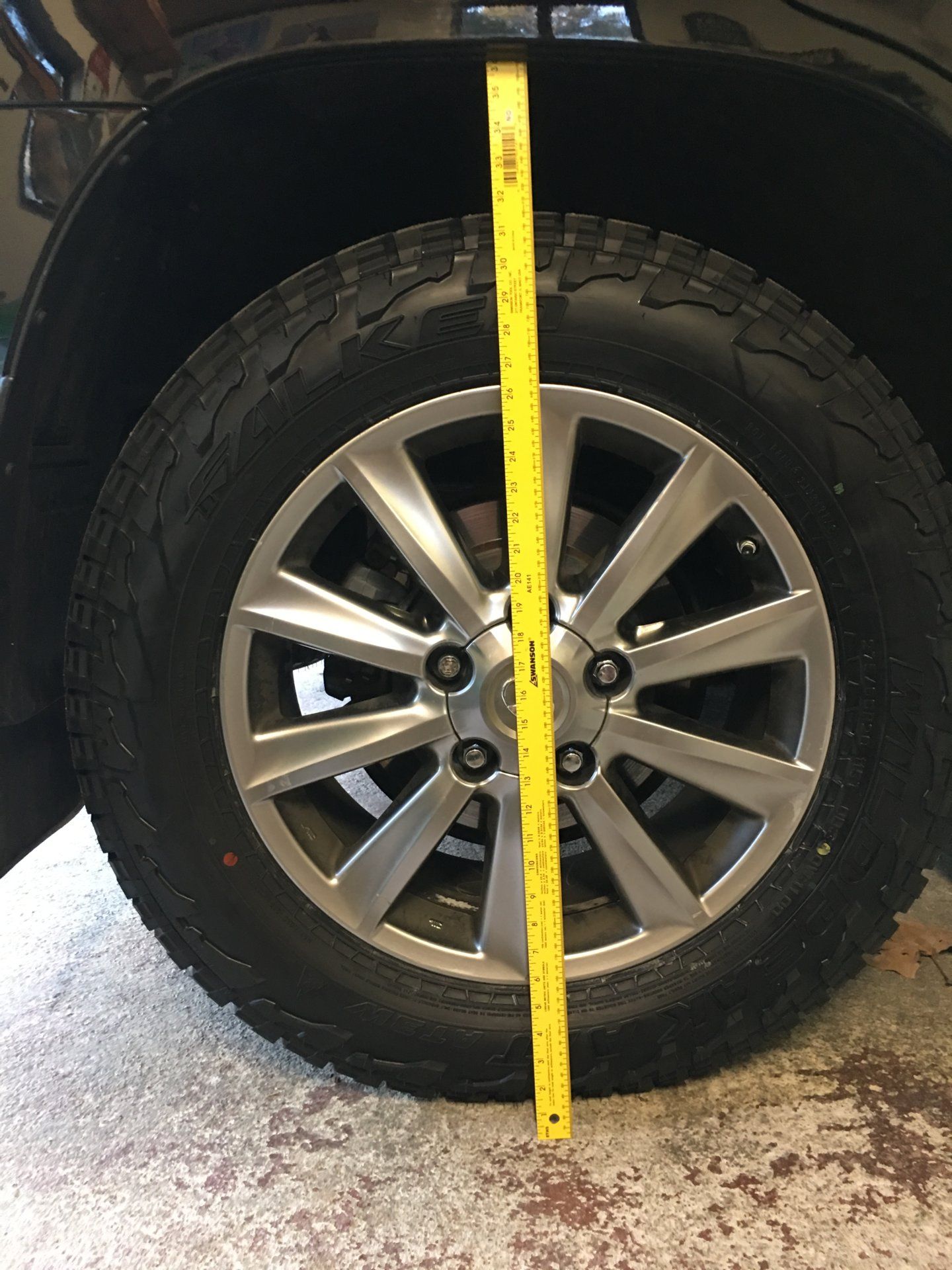

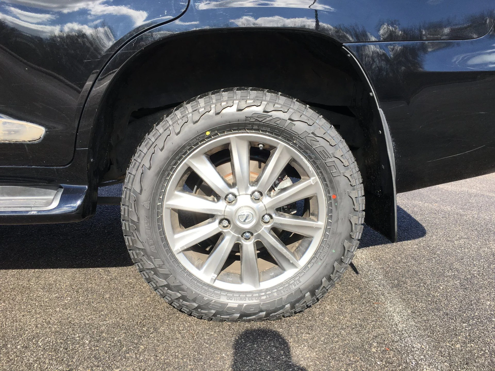

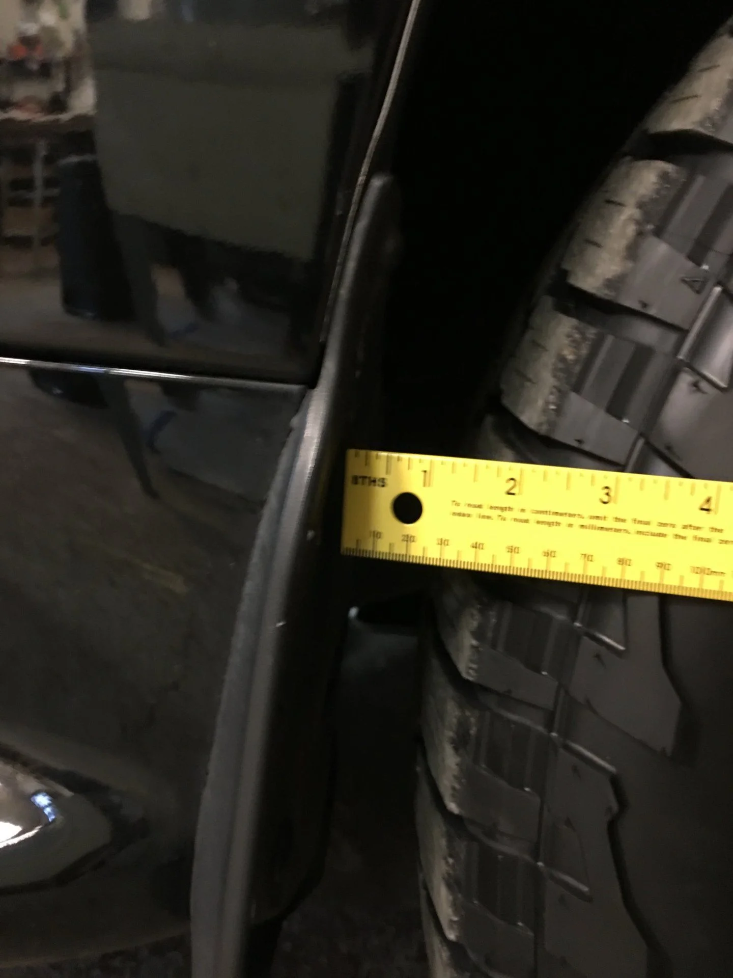

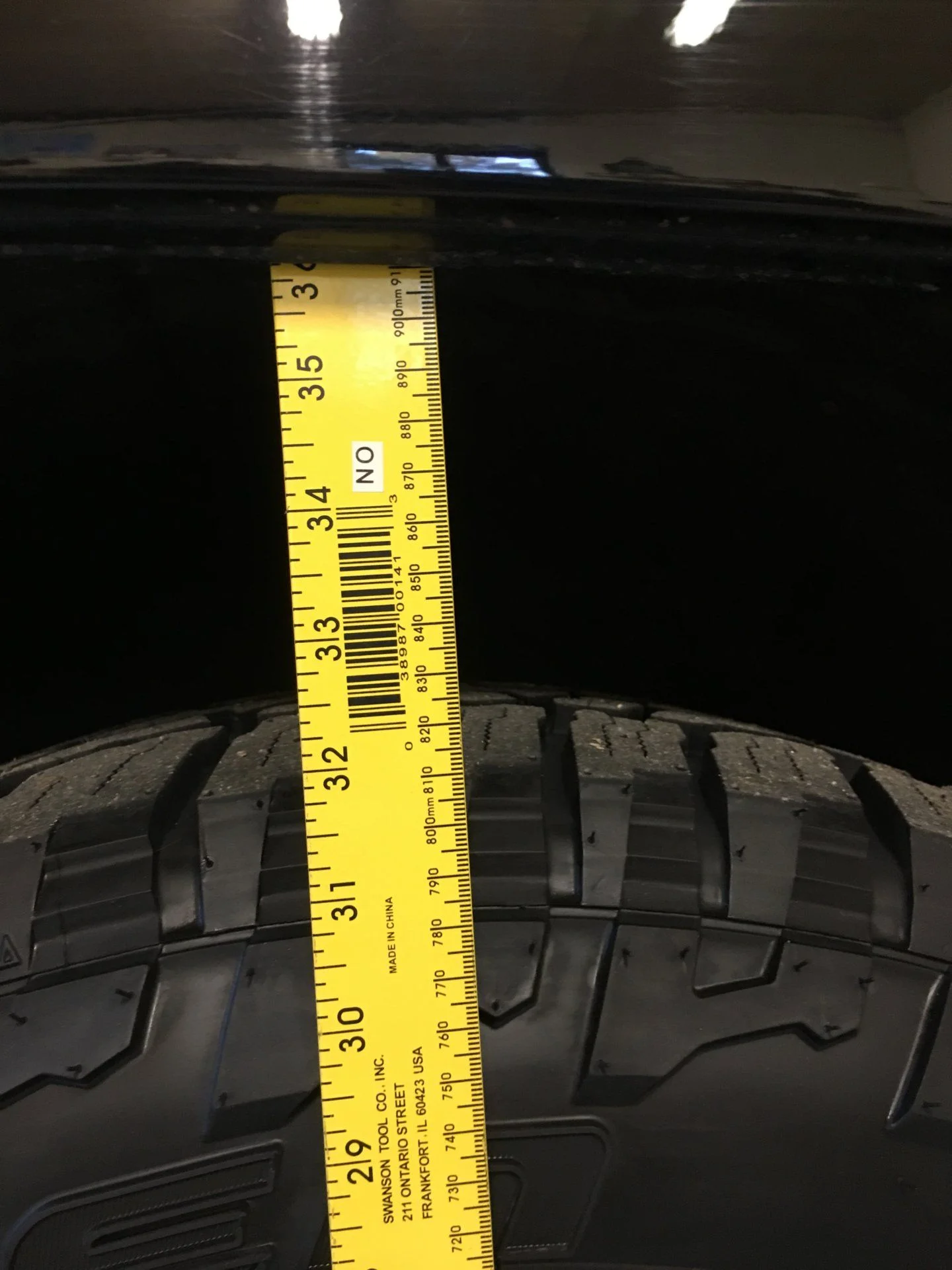

So I ended up going with the Falken Wildpeaks, not the Grabbers.
No rub, even at full lock at highway PSI (34-36), minimal rub at 50% lock in the 20's. I haven't had them under 24psi yet. I'm not sure yet what they are rubbing on yet, but it's minimal enough not to bother me. I'll be doing a fair amount of wheeling in the next 3 months. I've got trips planned to forest service roads, parts of the TAT, and the local OHV park (Windrock), so I'll have some more info to report soon. If I can get my ass motivated enough, I might even make a review thread.

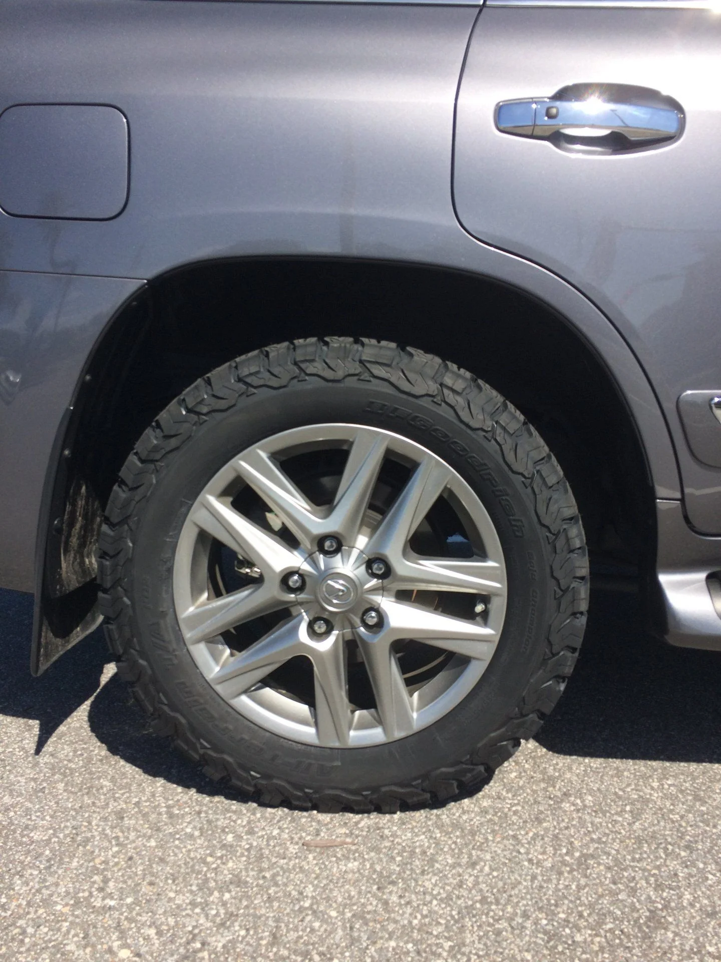

Max sidewall on stock LX would be 275/65/20. @mcgaskins is running this size in KO2s.
