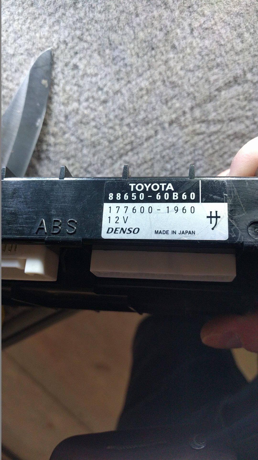

Please tell me part number of heater ac controls 03+ dial type connectors plug
you would need the pin out of the earlier model ac amplifier board. Also how are the connectors mounted to the board. horizontal or vertical and will it fit in the new box. And, would the tiny wire ribbon that connects the AC board to the heater board work right, or connect together.
take both apart and check maybe. But I think the answer is no. I'm sure it's not impossible. Some functions would be missing I think.
going off your new number I think the answer is no.
THanks I would let you know after close inspection
I meant to say "I'm sure it's not impossible"
Ohh okay and please keep me update if you get or remember some ideas as after ordering all parts and items i would be fitting my dashboard soon so i don't want to be stranded because of wiring problems thanx

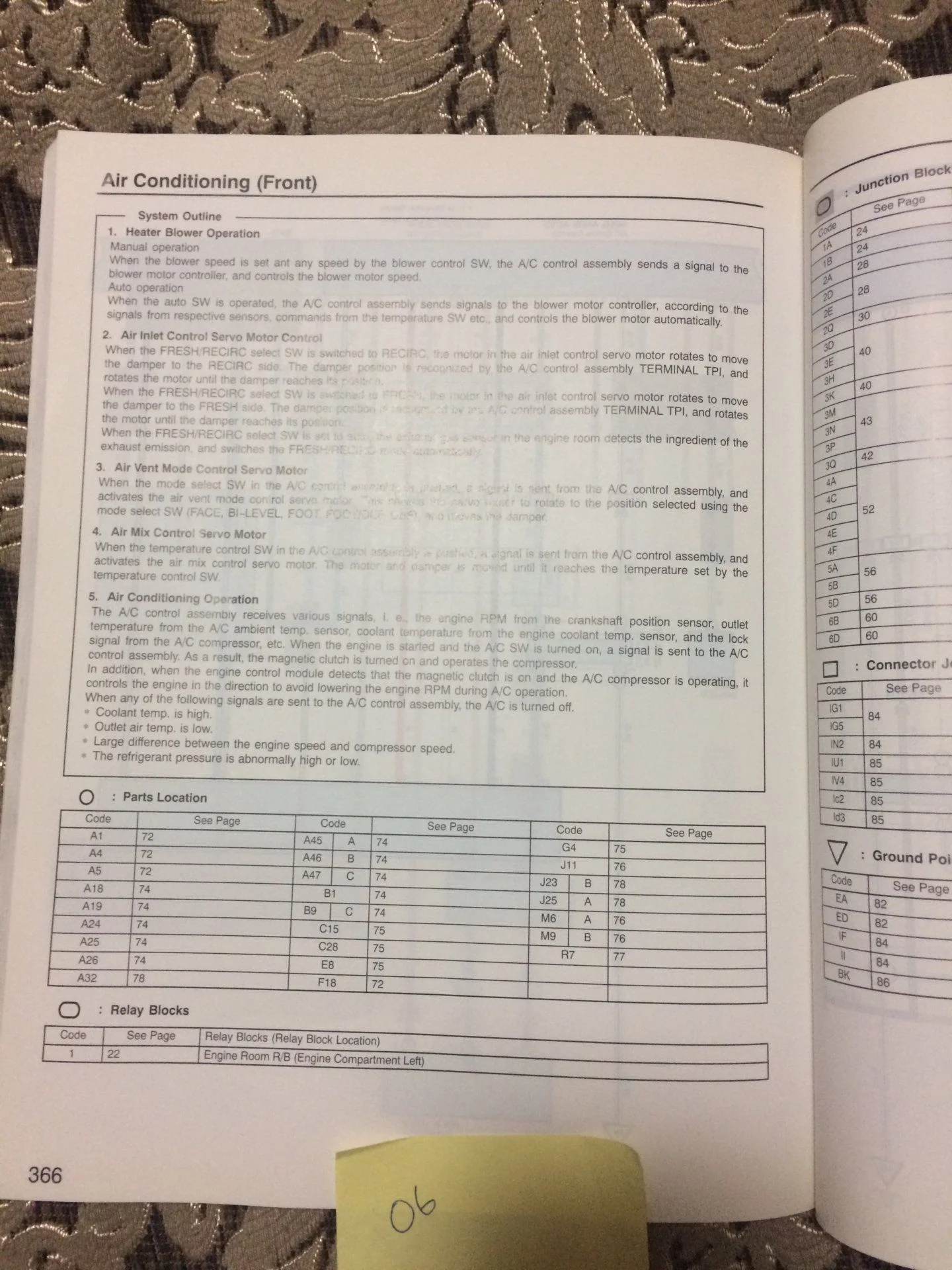

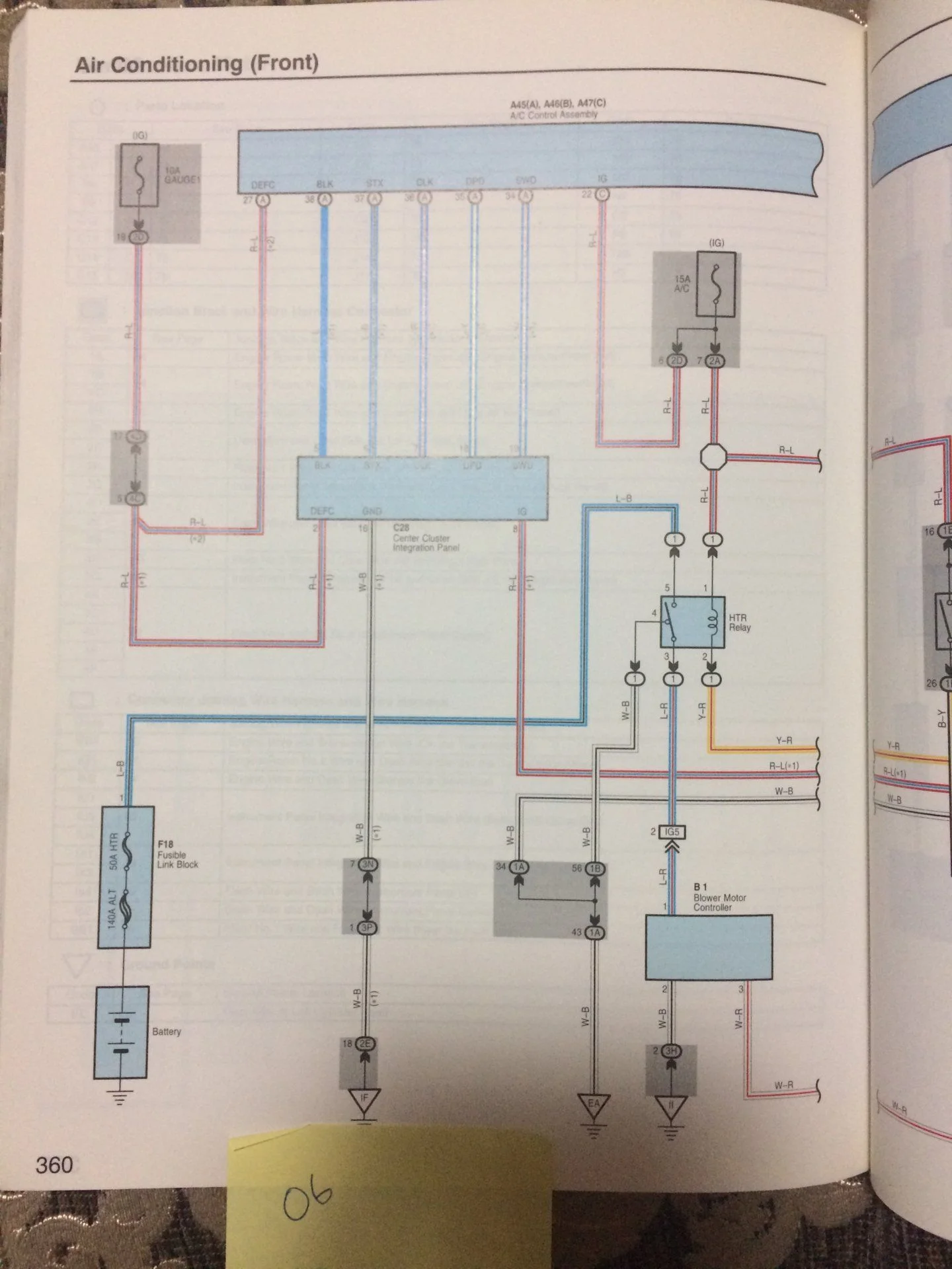

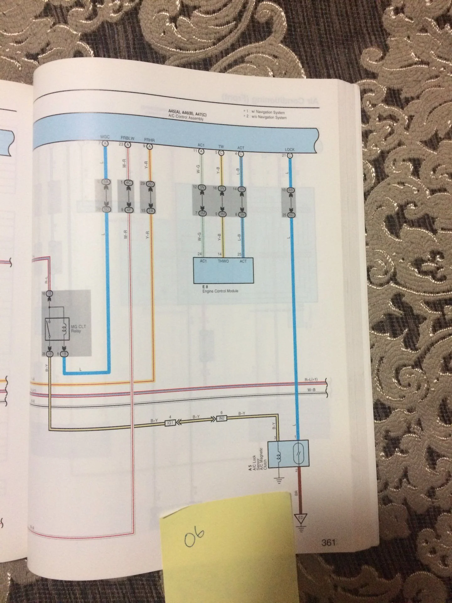

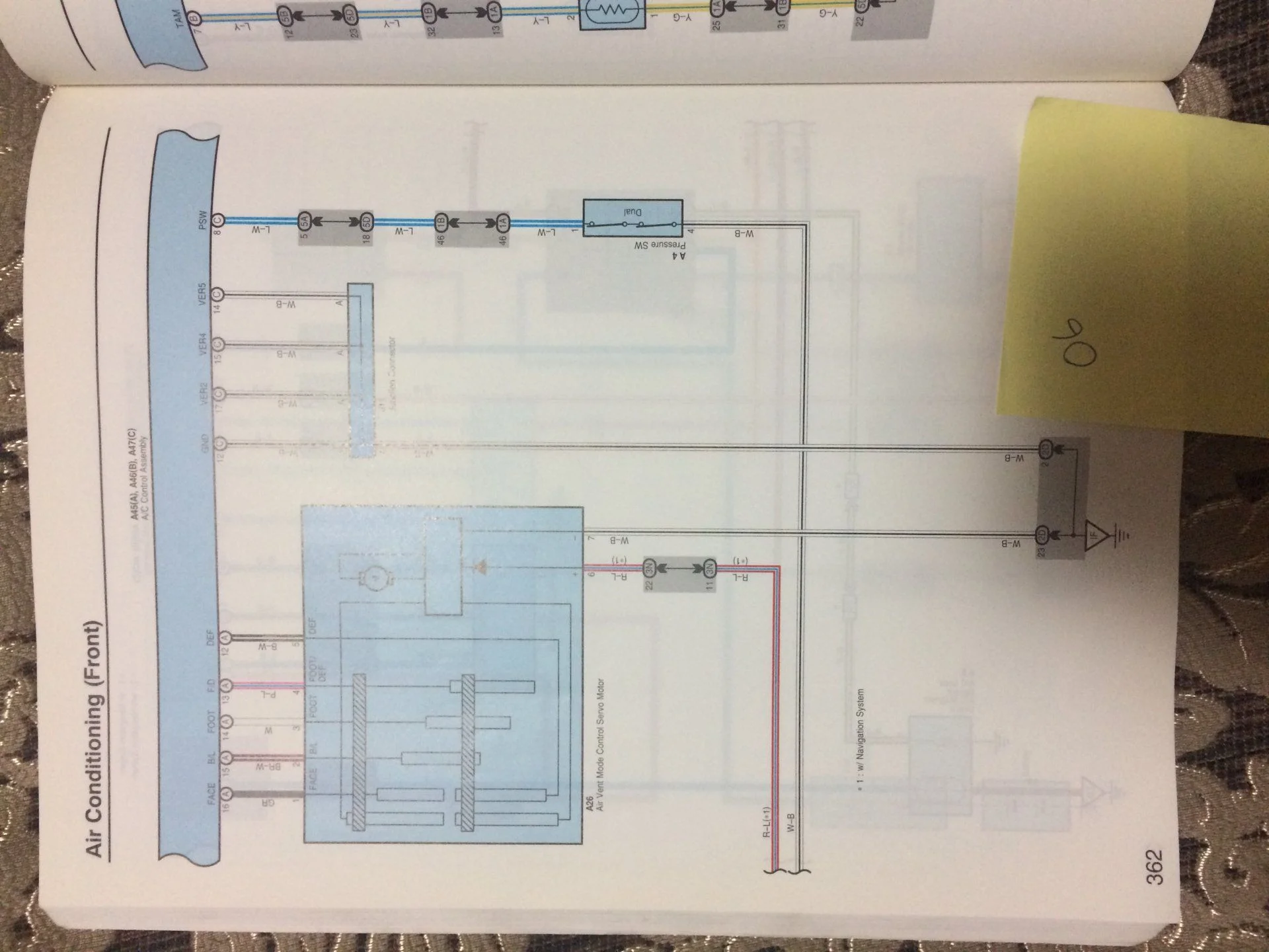

Good morning Samir,

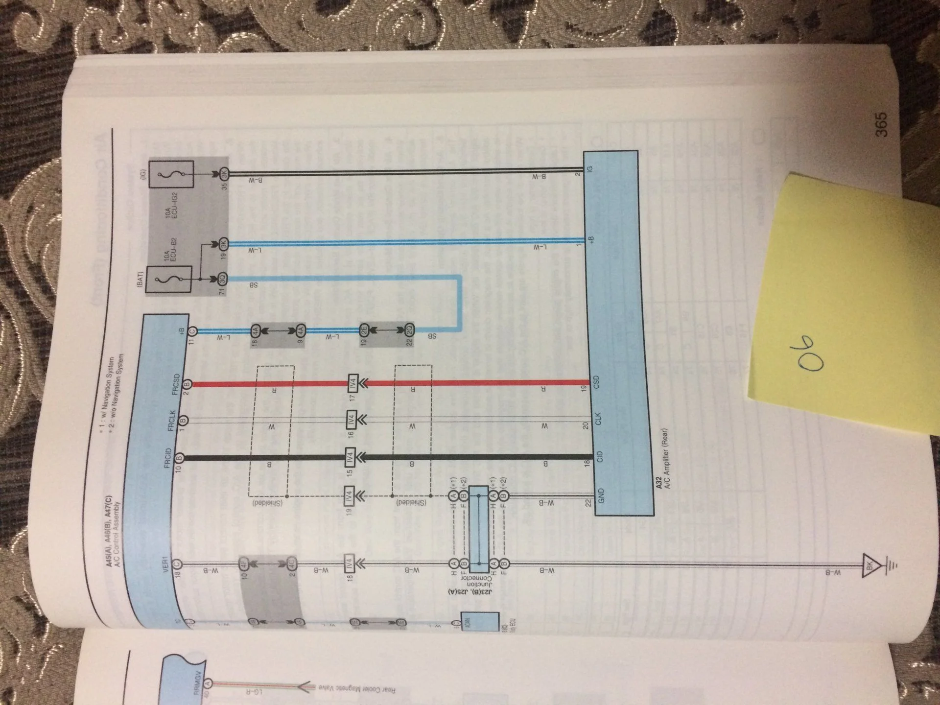

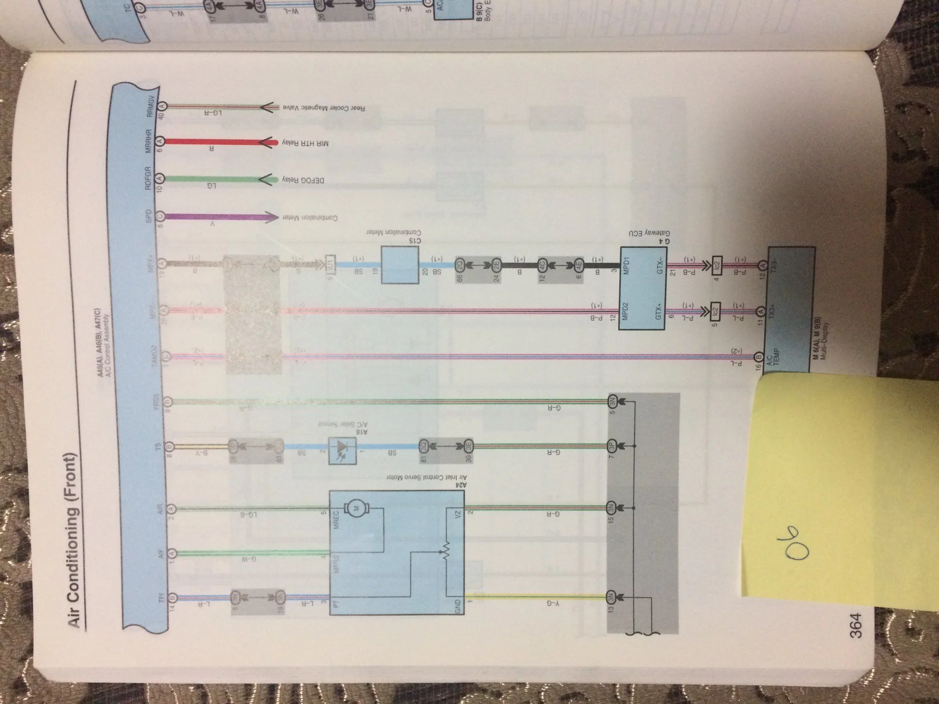

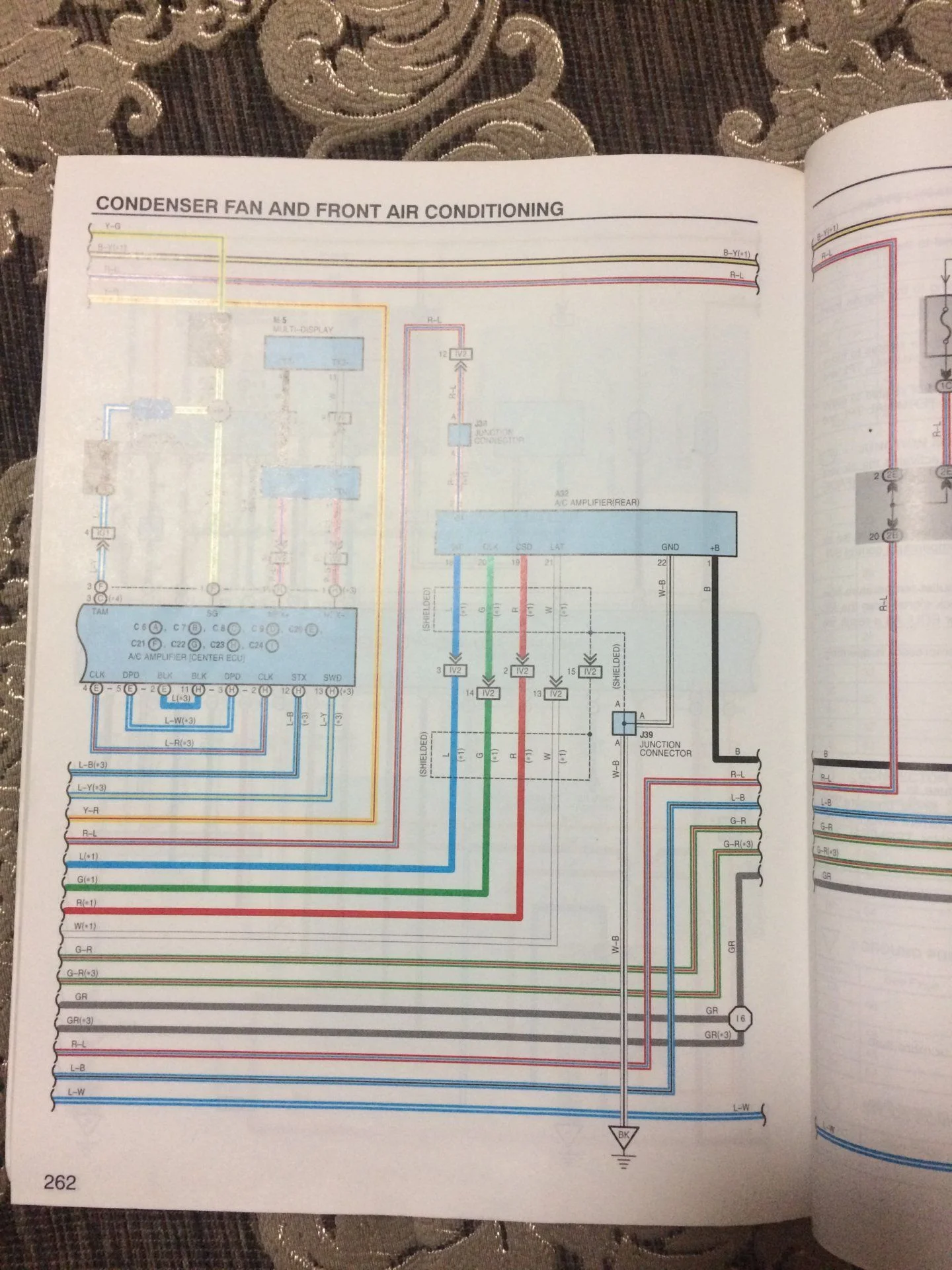

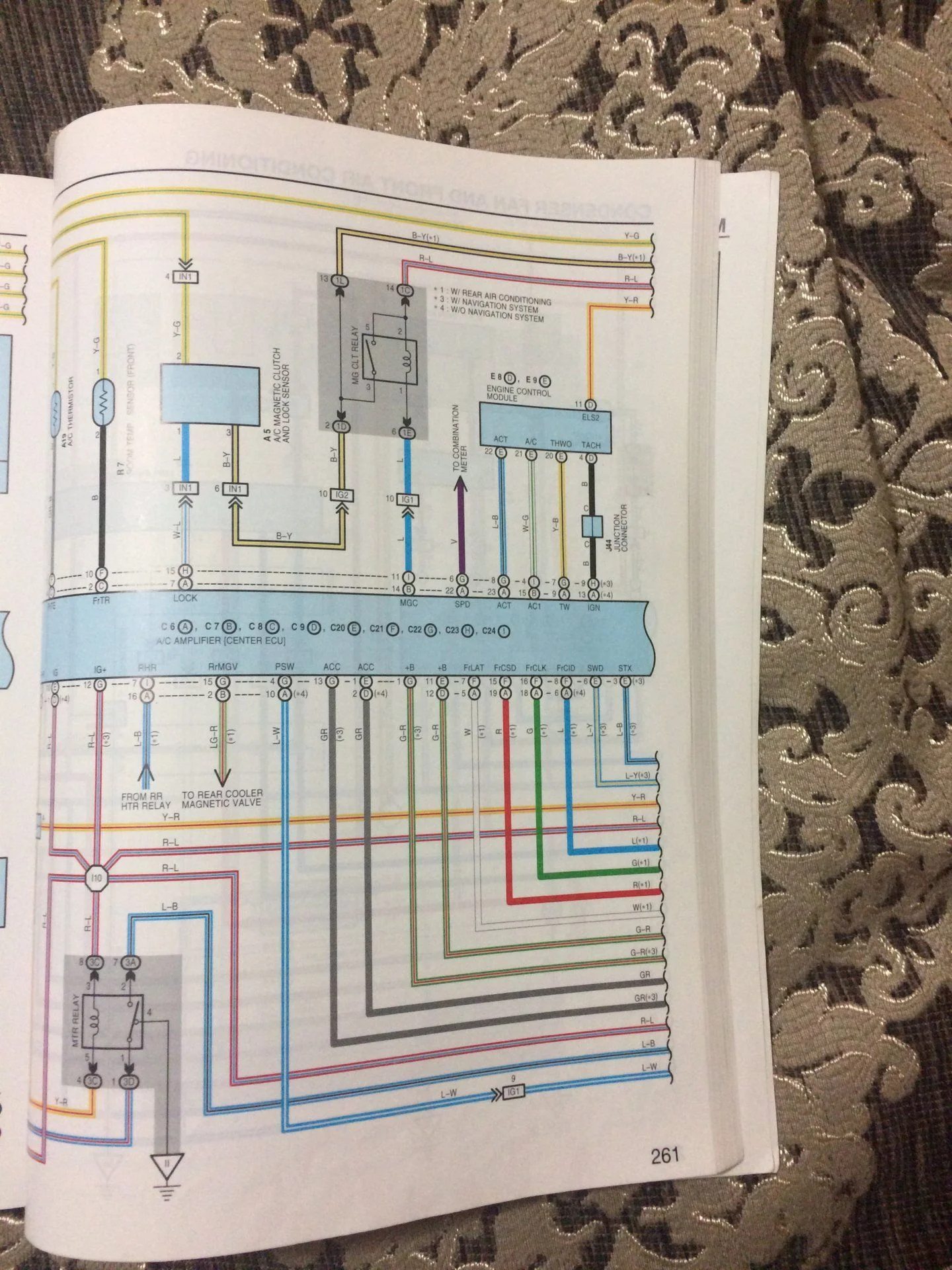

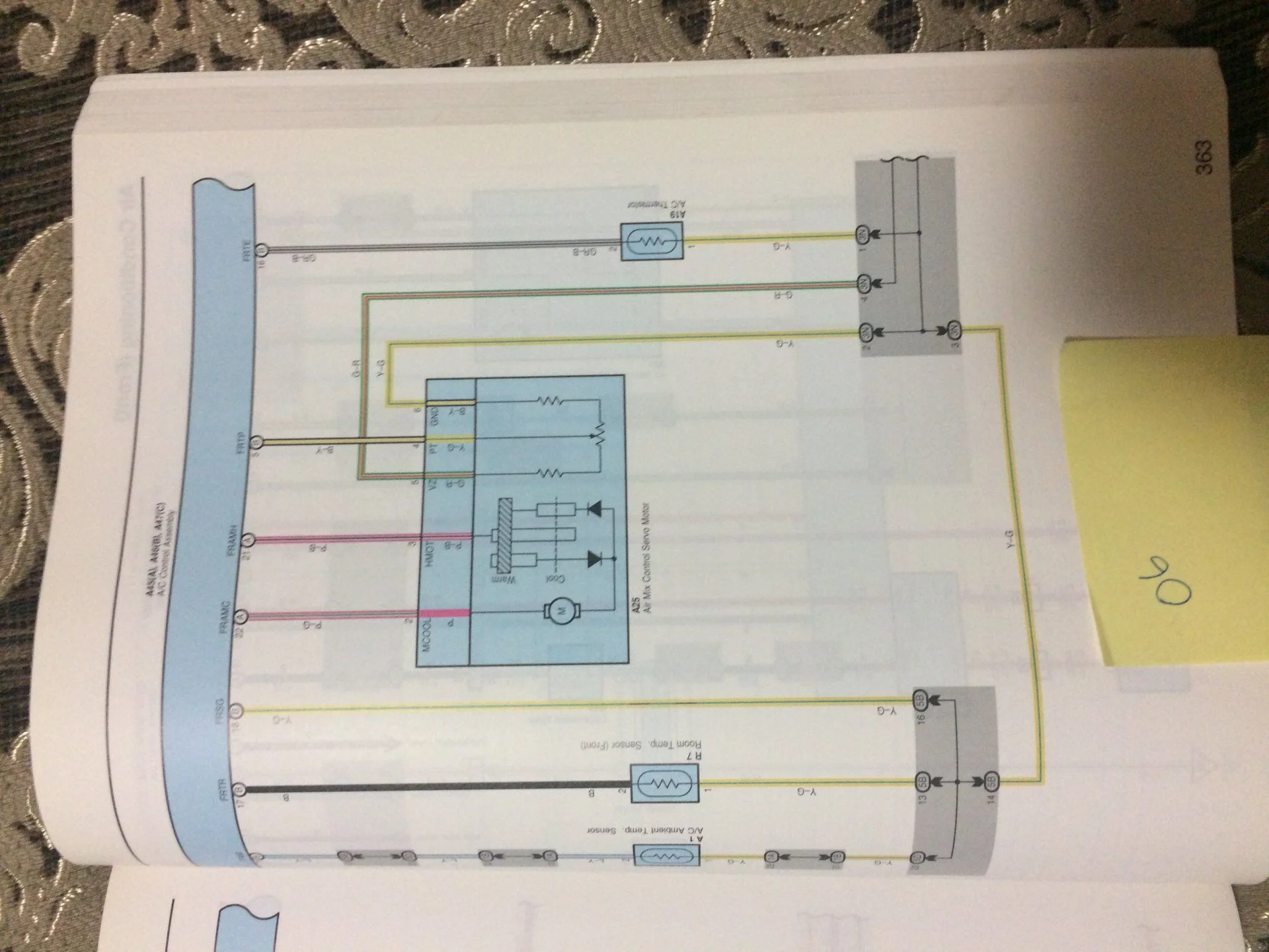

Here is the schematic of the ac controller for the pre 03 and the post 03. The post 03 is taken from a 2006 Electrical Wiring diagram. I have put a yellow note paper saying "06" so you do not get confused.
And the last page. As you can see there are significant differences in the way the controllers are wired. There also shows to be some terminals that are present on the 2002 that are not present on the 2006. Hard to say what those control.
And the last page. As you can see there are significant differences in the way the controllers are wired. There also shows to be some terminals that are present on the 2002 that are not present on the 2006. Hard to say what those control.View attachment 1674894

Hi, If i purchase a45 a46 a47 connectors and give them to electrician along with this pictures you send me will that help him make configure wiring for that new connector ?
Good,morning Thank you very much for your kindness and hard effort thnx i will have a close look at it and discuss this with my electricity specialist
once again thanks :)
I have no idea. I would say probably not. The reason I say this is the wiring is not the same. For example take the wiring in between the AC amplifier and The Engine Control Module or ECM. On the 2002 there are 5 wires. On the 2006 there are 3. The terminals on the 2002 are labeled TACH and ELS2. The new controller does not show to have those outputs. I have no idea what they control but I would be hesitant to change them out without knowing for sure. Now that I am looking at it that is the only main difference I see. It would be risky to try. Maybe someone more knowledgable will chime in.

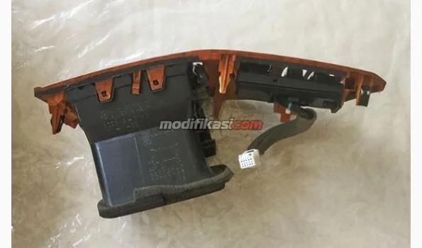

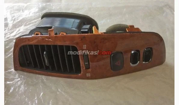

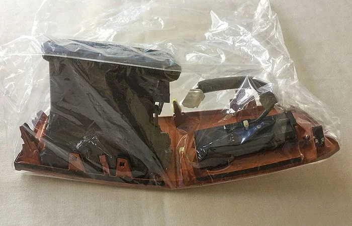

Hey how r you i just thought you could help me with this do you know part number of this connector plug for 55670-60120 register assy instrument panel no 3 and 55660-60180 register assy instrument panel no 2 please have a look at picture thnx
do you want the male connector that those in the pictures connect to? if that's the case, those connect directly to the sub assembly heater integration panel.
if you are wanting just the indicator portions of both sides, as in the passenger airbag warning light assembly with the lense cover, it comes with the male ended harness you see in those pictures.
and also the other side, that has the hazard, differential lock, and antenna control buttons, with lenses, those tow switches come with the small male connectors on them already.
if you are looking for the plastic white housings of both sides, which would be the female halves, those would be very hard to find. The reason is that they come as part of a wired assembly. They are all the same wire color. And then finding the output order from the sub assembly heater board would be serious work.
if that is confusing at all, think of it like this.
there is a circuit board with two very tiny wire sets that come out of the back of the housing. depending on if you have navigation or not, that part has two different part numbers.
the two sets of wires that come out of that connect to the parts you have pictures of. They match together.
Yes i want that both's register's female connecting part (white housing like a45 a46 a47) i want to know what thier part number is vice versa
I don't have the time to do that. It took me a week just to find a male housing to match the C28 connector in a LC witha matching AMP TYCO connector # from TE connectivity.
Also, they would be different based on your cars country and what is exactly inside that needs to be indicated, or lighted up. Also left and right handed. Your pictures of those registers indicate a right hand drive car.
It would be easier to find a junk yard place and cut them off to use. technically speaking, the white connectors in your pictures are female housings. The housings are gendered by the terminals that go inside them.
Those wont be in a part book or the toyota connector manual. If they are they are no longer available, or the part number will not exist in toyotas system.
Looking at your very first picture with the yellow wires coming out of it, that indicates a nav equipped car correct?
there is another unit that controls the lowest blank buttons, the grey rectangular buttons lined up, correct?
if thats the case, then the additional computer behind those buttons have the little pigtails that come out and connect to the side register panels.
okay thanks i found every connectors including a45 a46 a47 in amayama but i would look at junkyard there are mostly UN landcruisers 90 100 105 series but not sure they have wire harness and yes my vehicle is right hand drive here is my new dashboard
