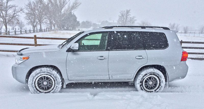

I am a big tire guy in principle:
And I appreciate your preference, but I don't see excessive rear wheel liner myself (pic is before I installed drawers and totally unloaded) even less when loaded:
But obviously, it's your choice.
Good luck with whatever you decide :cheers:
Edit to add:
After drawer install and a light load:
Is yours lifted? If not, that’s why you don’t see daylight in the wheel wells. If lifted, then I need to rethink my size.
