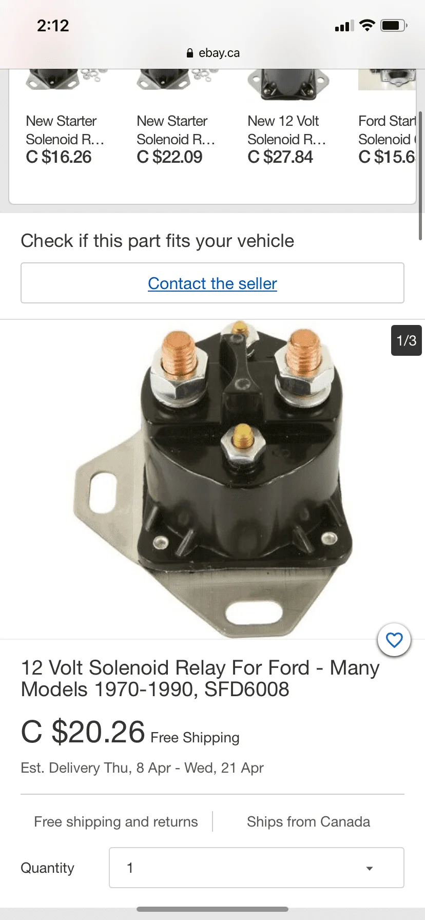

this was my problem. get one of these...
The stock wires from the igntion switch to the starter solenoid get old and lose their ability to carry enough current to properly fire the starter solenoid. You have two options...rewire the stock wires with all new wires and connectors or keep the old wires and install an aftermarket fender mount starter solenoid like @franklin40 has kindly pictured.

Can you send a pic of your set up when you get chance mate so I can see what I need to do

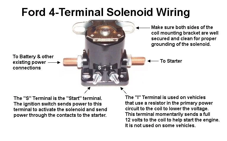

You take the stock small wire off the back of the starter and hook to “S” terminal. You then run a heavier gage wire from the bat to the main post and second post to the starter solenoid where the old wire went.

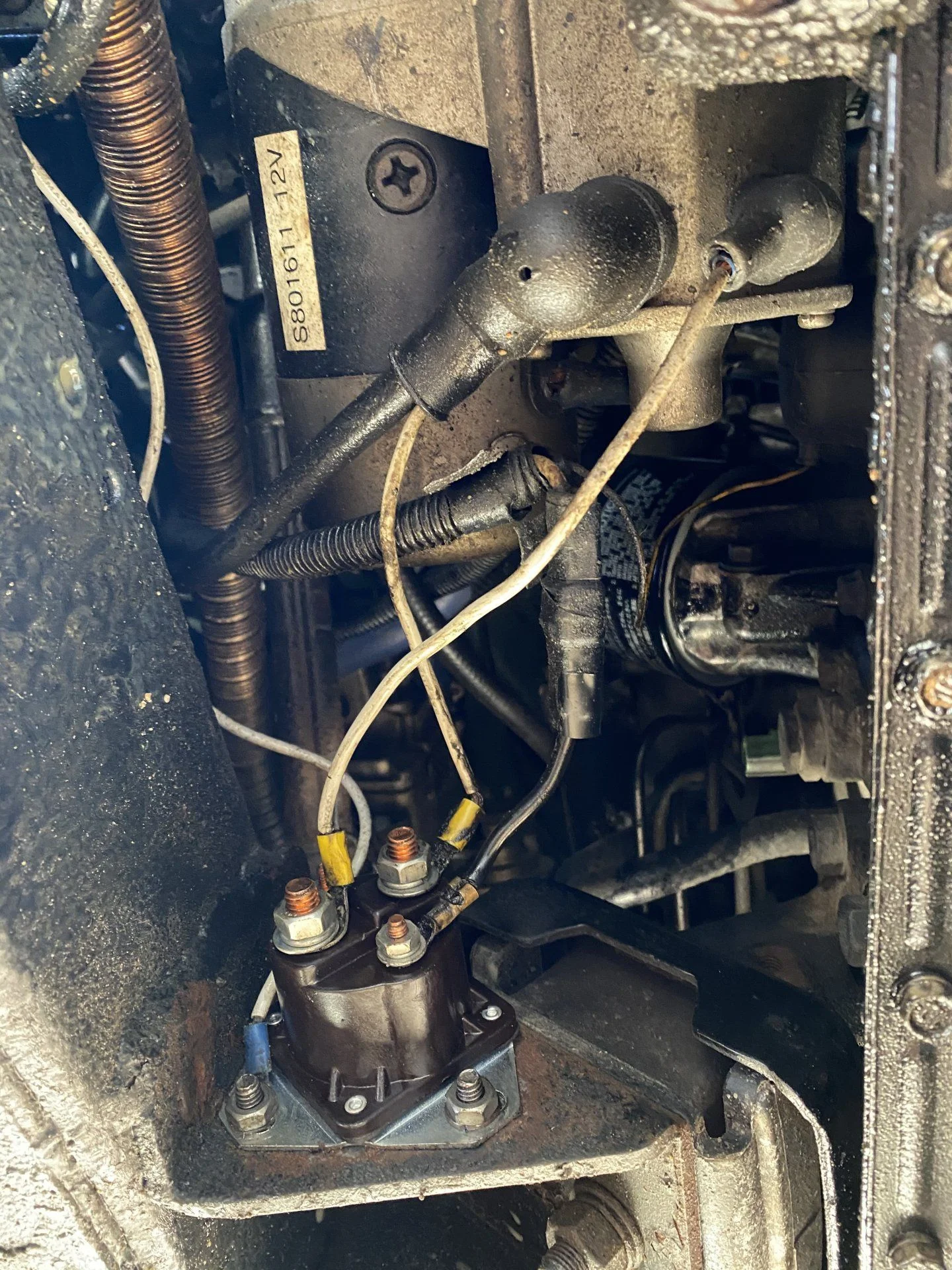

this is what i did. mine is a 1hdt so the starter wiring configuration might be a bit different but this is what my alternator/starter/battery shop game me and told me to wire it like this. there is one white wire that runs from the body of the relay to a frame ground.
