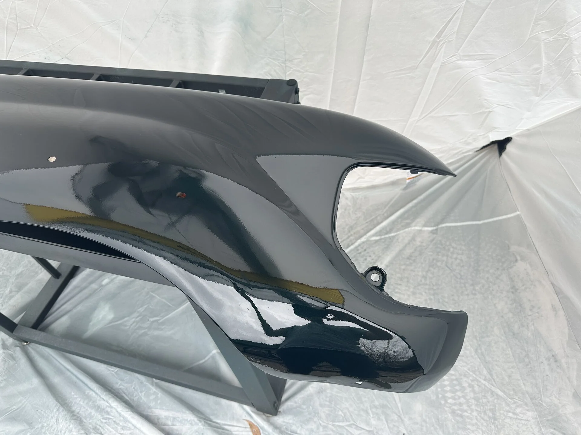

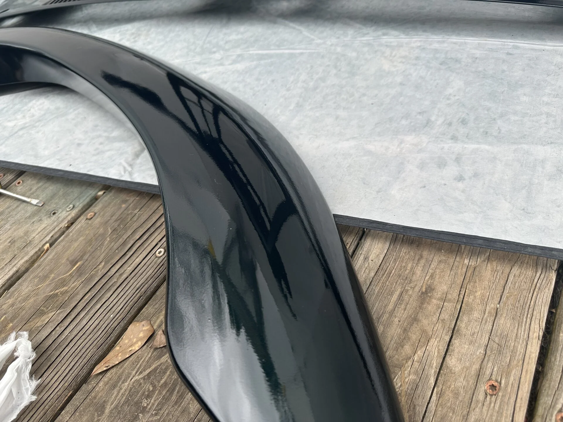

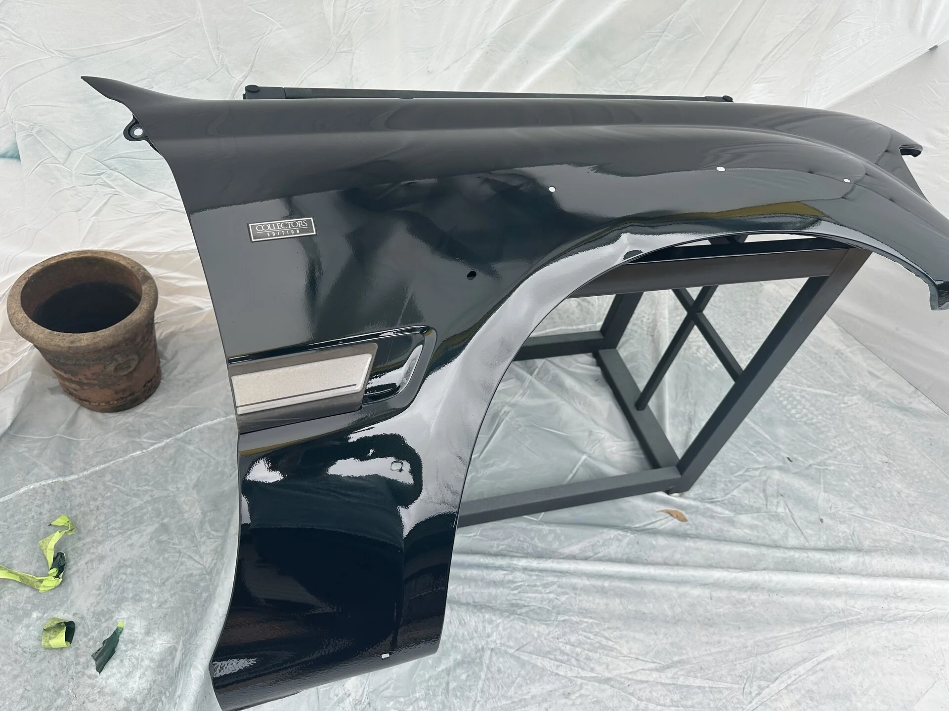

Finally got basecoat and clear on the fender, flare, and cowl. Lots of sanding, filler, mistakes, sanding, filler. Came out pretty good but needs wet sanding in a few weeks. I used rattle cans but definitely buying a sprayer for the rest. Going back on the truck tomorrow.

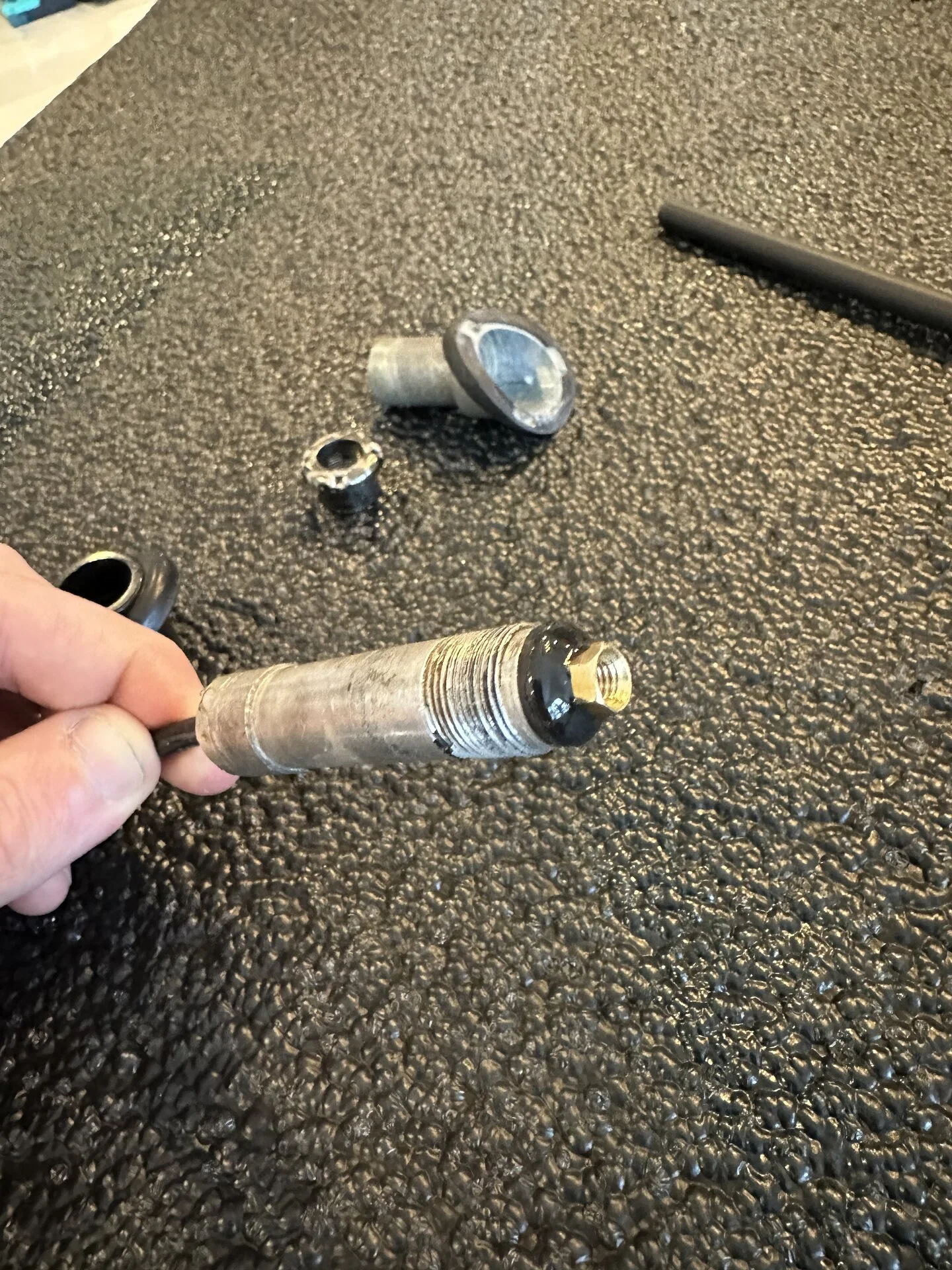

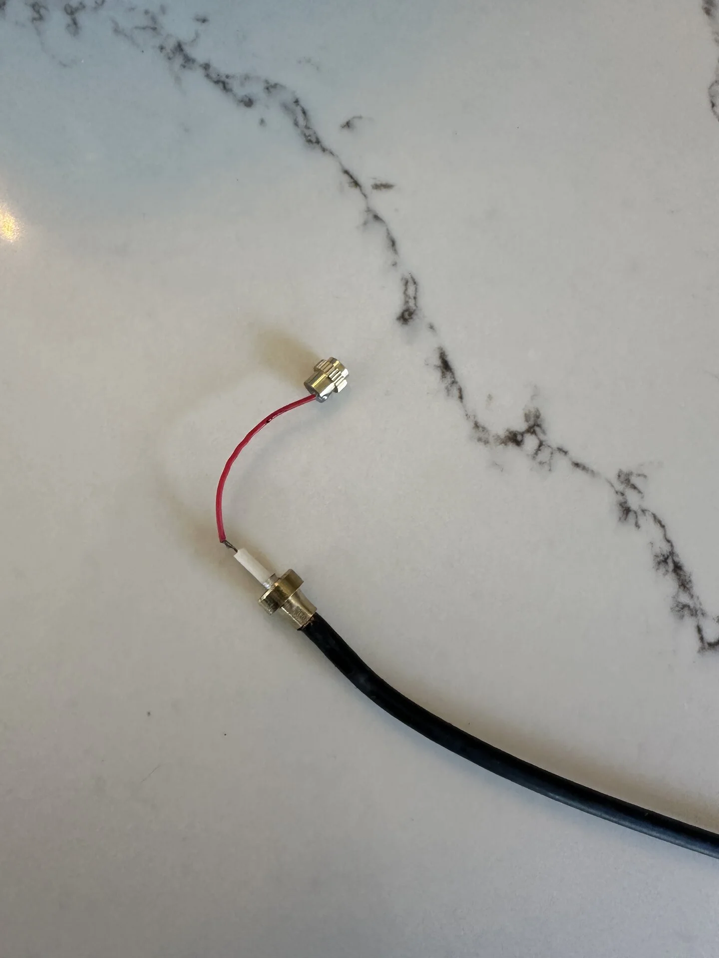

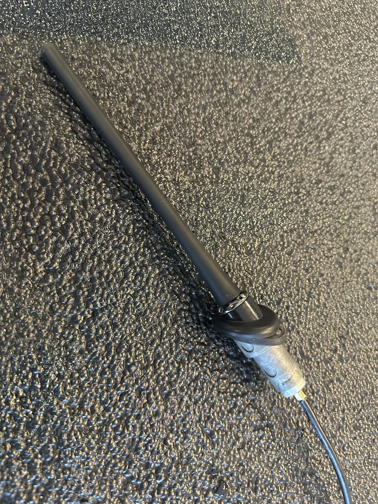

While the fender is off I decided to get rid of the retractable antenna. Going to reuse the switch for winch controls.
I chopped the oem antenna mast, and reused the mounting hardware by hacking up a cheap antenna from Amazon and epoxying the guts into the oem tube.
