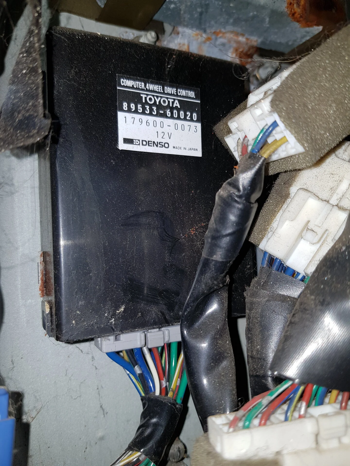

I have a 1994 1hdt factory triple locked.
I've fitted a new genuine switch and it works in high range.

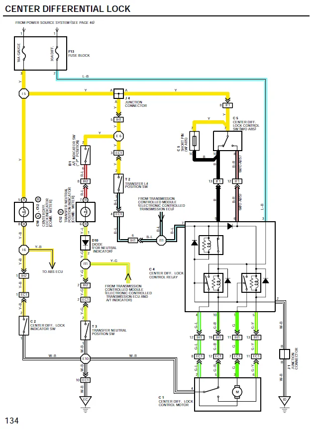

But my transmission control relay is different to all the others I can find mine says "computer, 4wheel drive control" pin 7 is a black wire with a blue trace. I backed pin 7 out but it's still engaging center diff lock when I select low range.
You're on the wrong box. That is the axle locker control, not the CDL control. The CDL control box has a 10 pin connector. Pin 7 should be black w/light blue stripe.
