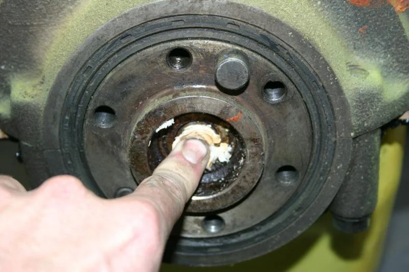

Step 1: squish bread into hole in center of pilot bearing.

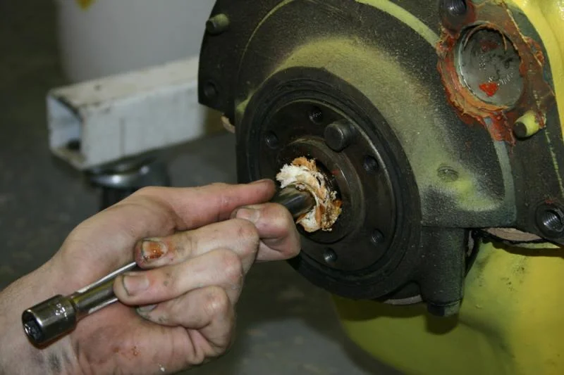

Step 2: use dowel/socket to hammer on bread in there (note: you'll have to add more and more as you compact it)

Step 3: marvel at how many pieces of bread you can fit behind the pilot bearing until it pops out!
