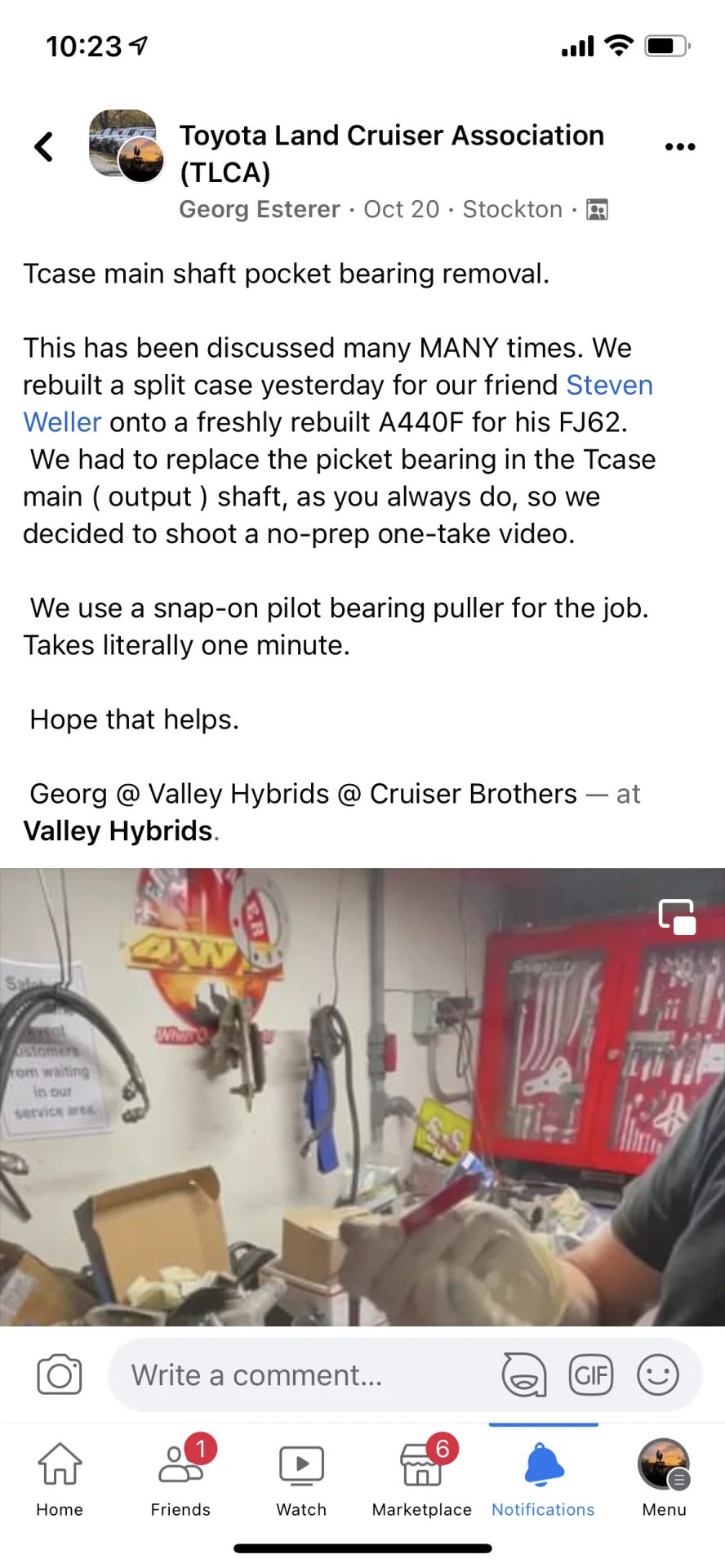

Look up this post on FB, it’s how we remove pilot bearings.
Georg @ Valley Hybrids @ Cruiser Brothers
