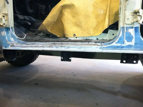

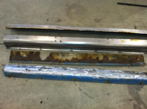

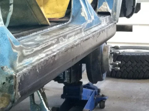

I finally got around to cutting out my drivers side rocker panel.
The upper section was in great shape, so I opted to leave it alone and remove only the lower part. The plasma cutter came in very handy for the modifications to Bob's excellent looking panel. Hopefully it doesn't hurt his feelings that I chopped it apart.
It even lined up pretty well despite my best efforts to screw it up.
Let me know what you think. Bob, keep up the good work. These rockers are very stout and they fit really well.
Jon
Jon, looks fantastic. No you didnt hurt my feelings. Each individual install is going to be different for everyone.It depends on what you are replacing and a persons skill level. Now you have left-over material in case you need it.
