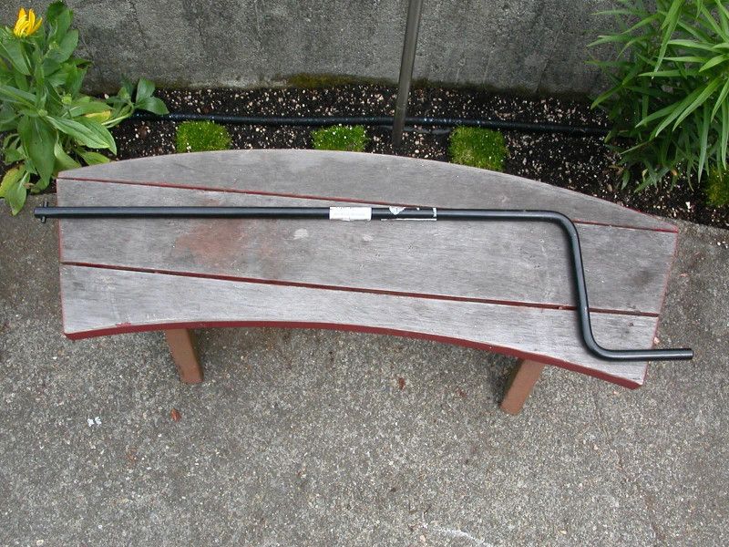

mounted on the front of my rig...red arrow pointing to hand crank
about $20 from Toyota
I didn't know Toyota would still have these cranks! I'll check with my local dealer on Monday!!! Thanks for the ideas!!
Thanks guys...i think I'll order one
