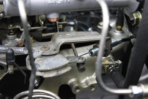

Not the best pic but you can see part of the bell crank gadget here. Look for the shiny silver spring!

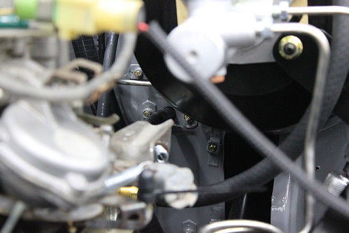

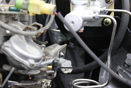

So I took some pictures today of what I have, in order to avoid 'speculation' on alternative arrangements. It's an OEM cable, and it's the same length as the one I removed.
It shows the loop, I just don't remember where it should be placed. Right now it's too close to the valve cover.
Nice looking engine bay.
Great photo @73FJ40, now I see how that works. I haven’t seen many pictures of your project, your attention to detail is incredible. Is that carb the real McCoy? Looks brand spankin’ new. Japanese vac hose?
These pics won't help you with the stock appropriateness of the loop. Before I shortened my cable the loop was similar to what you posted but it leaned toward the brake booster.
Yep, NOS OEM Toyota, non-USA but the 1973 model. It has the ported vacuum for the vacuum advance distributor as well.

I think my loop is running downward, you just loosen the two big nuts rotate it. Up works too. I wish I could remember how it was when it came off 20 years ago, but I don't even know then if my dad had altered it prior, wish I knew what Toyota intended.

I ran a ‘73 on my ‘68 for several years. Cable looped. No biggie. Never an issue.
