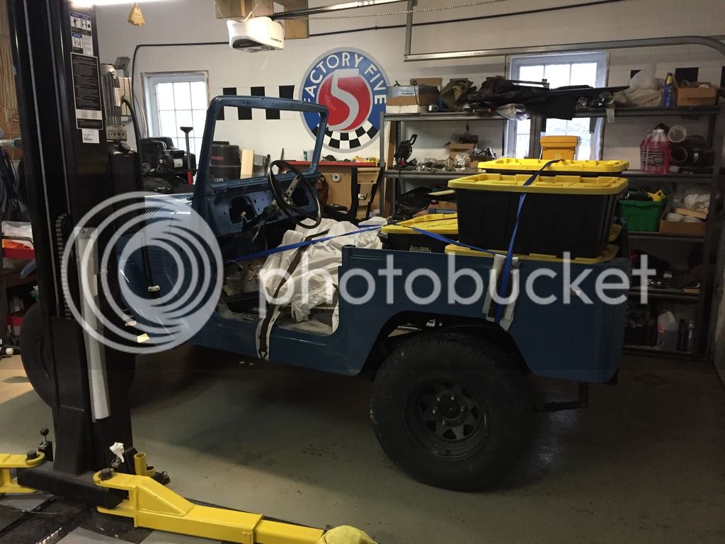

I was going to do this to my 66 (1st Pic) but after figuring out how I wanted to build my dream 40 it was a no brainer when I ran across the below 73 ... A PERFECT canvas to which I can start fresh

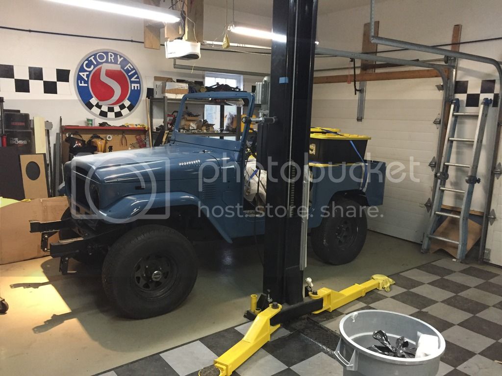

NEW 73 that I picked up from TorFab in Seattle
Absolutely mint, with Aqualu tub, also I have a solid roof, and a set of perfect 81' doors
