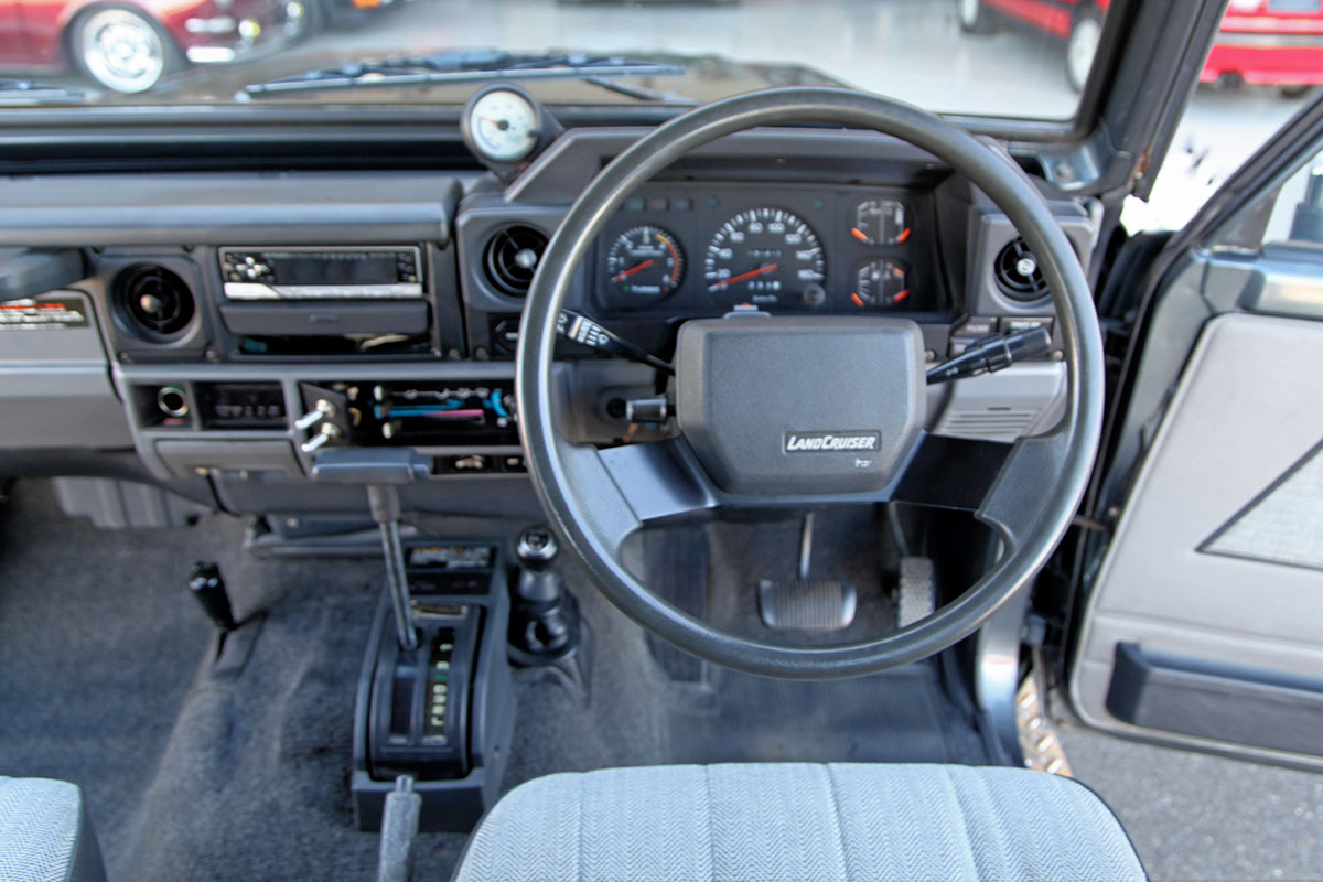

Does anyone have pics of the shifter console and the position of the shifter in an LHD, AUTOMATIC 70 series? Especially how they mount and if the base plates are different? Mine's RHD and i need to move the auto shifter over to the left to make room for my twin stick kit. anyone have pics of where it would be stock in an LHD? if it's any different?
I'm 99% sure that RHD and LHD automatic 60 series trucks have the shifters moved left or right depending on driver position
Like this one is RHD, older style shifter:
