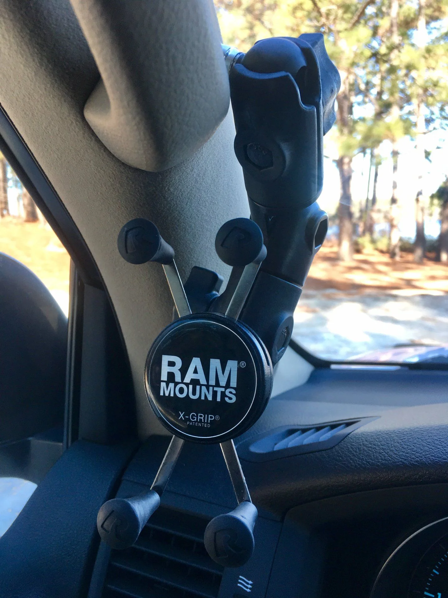

In my LC I removed the lower mounting bolt on the driver's side grab handle and replaced it with a longer bolt (which secures a 1" RAM mounting ball). Then added a triple-jointed RAM arm. The arm is adjusted to the perfect void above the air vent and slightly to the left of the gauge bezel. A RAM X-Grip holds my phone in my periphery without obscuring visibility out of the windshield.
Photo:
More info here from my thread:
I've joined the club - 2011 LC (white/tan)
There is some concern that this location could interfere with the side curtain airbag deployment in the event of a crash. I will say that the above photo makes the mount appear much closer to the A-pillar and window than it actually is. I'm confident that it would clear the airbag in a crash, but it's something to consider.

That is pretty slick...please let me know if it looks like I have the same components lined up:
Ball: RAM Motorcycle Handlebar Clamp Base with M8 Screws Unpackaged - RAM-B-367U | RAM Mounts
X-Grip: RAM® X-Grip® Cell/iPhone Cradle Unpackaged - RAM-HOL-UN7BU | RAM Mounts
I can't seem to find the arm that you have though...any thoughts on what that part number is? Thanks!

Those two products are correct. You may have to source the bolt at a hardware store. I cannot recall the length and thread pitch of the grab handle bolt. I purchased the ball separately without the three accompanying bolts (the product you linked).
You'll also need a 5/16", or so, spacer to slide on the bolt in between the base of the ball and the a-pillar. This is required to push the ball out enough to allow your arm to "grip" it fully.
As for the double swivel arm - try this part number:
RAP-B-200-2U
It's been a couple of years since I purchased the double swivel arm I mentioned above. I was able to find it with only two adjustment thumb screws, the center joint is secured with an Allen bolt - which I like as it's less bulky.
Good luck, you will like the setup.
