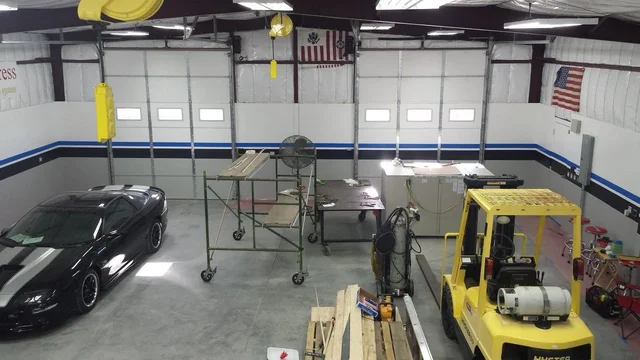

Doors are up (two up front,one in back and a roll up on the side) and dried in. For those wondering about the front doors we rusted them prior to install for the South West flavor. People actually pay for rust in Arizona hahah.:p
Operators are Lift Master 8500 jack shaft type. Very cool design and quiet as well.

12' of stripes down and 230' more to go. I think the blue will compliment the miller equipment.

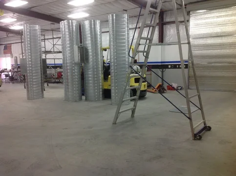

Its getting hot in the Old Pueblo. Meet SWAMPZILLA! a 12,000 cfm unit that mates to scheduled spiral oval ductwork.
Hopefully get this baby installed and operational. 20140407_164952.webpIMG_0437.webp IMG_0439.webp
Swampzilla is in operation. Had some issues with setting the correct amp load. It seems they sold me the wrong motor sheave. Motor is pulling three extra amps and squirrel cage RPMS are slightly faster than needed. But overall the system is quiet and the building gets cold fast. I had a 32 degree pull down yesterday with outside temps around 94 degrees.

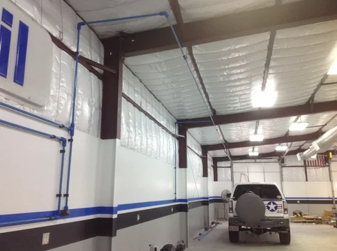

I have installed the correct motor pulley, and have the system dialed in. With temps in the 104-108 range this past week its woking real good. I should be receiving the air system within the next day or two. I ordered the fastpipe commercial airline from rapid air. I plan on 1" loop refrigerated air with 8 or so drops. Copper would have been the same cost with added hot work and time. I spend a lot of time during the week working alone and would really need a fire watch working on a ladder next to the insulation. Fastpipe is a proven commercial system and it looks awesome.

Newest arrival..FASTPIPE by rapid air. Its 1" extruded Aluminum 19'-8" sections ,(seamless) powder coated in blue. Heavy poly fittings and bomb proof QDC's connections.
Start hanging tomorrow.

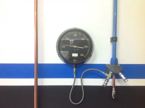

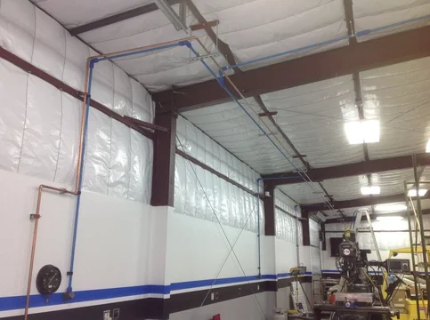

The 1" Fastpipe is in and operational. Hung on trapeze type brackets and looped to handle high air demand.
Supply air is set at 125 psig with no pressure drop at far end of compressor. CNC Plasma table requires a good dry ample supply hence the loop system.IMG_0495.webp
