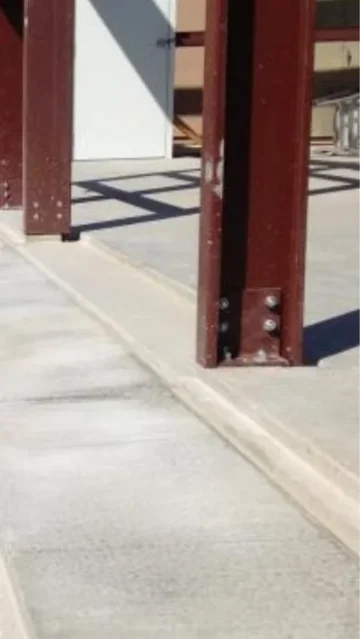

Stripped the forms on the west end trench drain system today. Came out the way I wanted, clean 1.5" X 1.5" notch. The notch will support bar grading (12" W X 3'L) sections. the bottom of the trench still needs back fill and slope to the south end dumping into a leach field type set up. I will pour the trench when I pour the last of the 17 yards of concrete for the west end driveway.
Formed up the ends of the trench drain and layed down some re bar. pouring tomorrow.

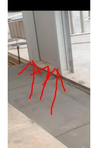

I'd fix the block outs on the OHDs now, otherwise they'll never seal right and always leak around the jamb. Most commercial doors are a 2" track, minimum, and should go to the bottom of the door block out.
The bottom angle adds another 1".
The inside edge of the block out should be 9.5" from inside of form, 8" from steel line.
Also, all metal building walk doors are designed to swing out and will leak, swinging in, plus I believe it's a national fire code. ;)

I was golfing at a fund raiser when the OHD where formed up and never caught the error. Your absolutely 100% correct 8" from steel line or 9.5" from form. I decided to leave as is and mount door right to edge of notch and dry pac the end around the c perlin.
The man door had to swing in due to close proximity of existing shop side door and cooler. As far as fire code, not as issue as this is my private home shop. The build prints indicated Right/left/in/out. I'm not sure why this would leak as it has a tight seal. No driving rain will hit this door as the existing building is 14' high and 9" away.
I do thank you for your feedback tho.
Obviously, my input was unsolicited, but have encountered issues from both circumstances and relaying experiences.
To further the unasked for....
The door block outs aren't that big of a deal to notch and grind with a quickie saw and grinder. About a two to three hour job with the right equipment and skilled operator.
That said, I understand the aversion to, and there are high density rubber thresholds that'll seal, provide a slope, and extended to the outer edges of both door jambs, giving a finished appearance and weather tight seal.
Door company may be privy to, or have something similar, but what I've used literally appears it was made for this circumstance, came in 7" longer lengths to be cut around a typical 3 1/2" jambs.
At the very least, notching out behind the door jambs so the tracks can extend to the bottom of the threshold, might be a consideration. The bulbous seal at the bottom on the door may seal to the inside lip of the block out.
The walk door looks like a Premier brand door, ever typical to metal buildings. If you'll look at the threshold, if installed correctly it will funnel water, in. Caulking the base to the finished floor height concrete will be a continual maintenance item as well, because there are but a few sealants that adhere well concrete for this application.
As for IBC egress requirements, it's really dependent upon how savvy code enforcement is, and how they interpret the building code, so may be a non-issue in this circumstance, but there are very few circumstances where a commercial door swings in due to the perceived hindrance to open, in a fire event.
In no way, shape, or form am I trying to rain on your parade and I pray that's understood. I've encountered both these issues, along with a plethora of others in the twenty years I've been in the commercial/industrial metal building industry.

These areas are an impossibility to seal.
And the sidewalk appears to be ~36", so I'd think it'd swing out, no problem.

I respect and appreciate your input. I will look into renting a concrete saw to remedy tho OHD issue. I was planning on skinning the building next week. Still need to install the base angles prior. I will take a close look-at the threshold.

Poured the trench drain today. slopes 3" in 45'.

Laid in the bar grating. I still need to "band" the sides of the sections, but at least I won't fall when drinking and walking:beer:
The drain system is rated for 10,000 lb. load.
I would Love to have a drain system like that around my shed.
Looking Good!
Thanks, It should shed the monsoon down pours we get on occasion. The shop addition came years after the existing slab and location of house resulting in the drain system requirement. I started "skinning" the new shop over the past two days. Two of us where able to put up 180' worth of walls. Remarkably the weather (wind) was very calm :clap:
