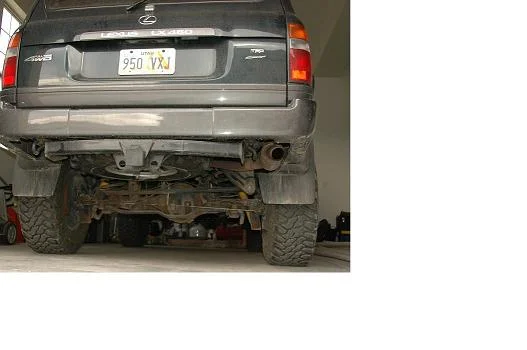

I finally found the perfect spare tire for UNDER your 80, with 35 inch tires..
It is the Interco M21 or 9/34 16. I put it on a 7 x16 inch toyota steel wheel, as you can see it sits way higher than stock... and yes I have done the spare tire mod.

Very well done! Have you done any other changes other than raising the assembly? There is a bracing bar at the rear of the cavity... did you remove that? Anything to change the angle?
-B-
I only raised the normal stuff, I did 2 inches in the front and 1.5 in the back (just about max). I stuffed it as far up as I could and still use the hand crank.

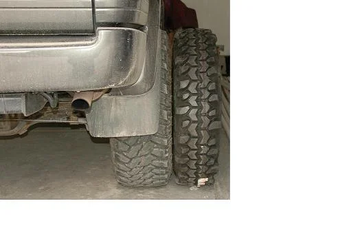

Is the swamper the same height side by side? It looks that way. I hope not. It shoud be a taller without any weight on it so there is room to sag.
Keep in mind the Swamper will drop 1"-1.5" after the weight of the truck is on it.
That would not be good if you are driving on a smaller tire because the spider gears and the VC at least on the street will get a workout, and worse, locked on the trail, 2 tires at unequal heights would not be good, either.
The tires are very close to the same size with the spare off and the other on the rig. I have 50 psi in the spare to keep it as big as I can, the sidewall on the Interco is so stiff that the tire mounting machine had to be helped with a sledge hammer to finish putting it on the rim, with the weigh of the LC on it I will adjust the air in the other tire on the same axle down until we they are the same height.. If I need to drive a little slower because of the lower (20-25 psi) pressure in the 35x12.50 i will gladly do it..

Manufacturers specs on that tire are:
SAM-21 9/34-16LT 6ply 27/32 8"tread width 33.8" diameter 9.1(C.S.) 16x6.5 45psi 2370max load
Not quite 35" but probaby good enough as most 315's measure closer to 34" when they've been used for some time.
