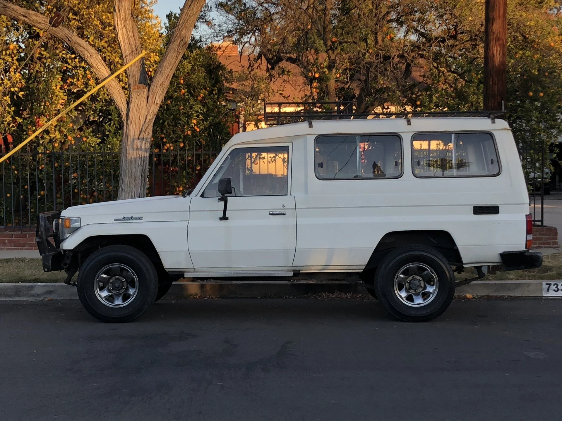

Took a while to start a thread but here goes. BTW This is going to be a slow build...
Have no garage...yet.
Bought it from a member in Cali.
1990 FJ75 Troop Carrier

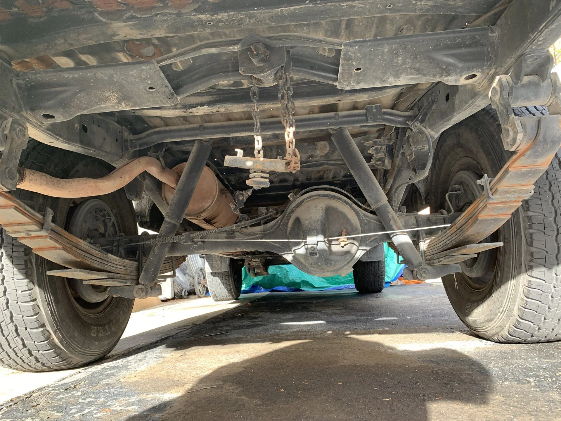

Has a 20+ holes on the rear floor due to riveted in floorboards that need to be welded up.
Has rust on the drip rails.

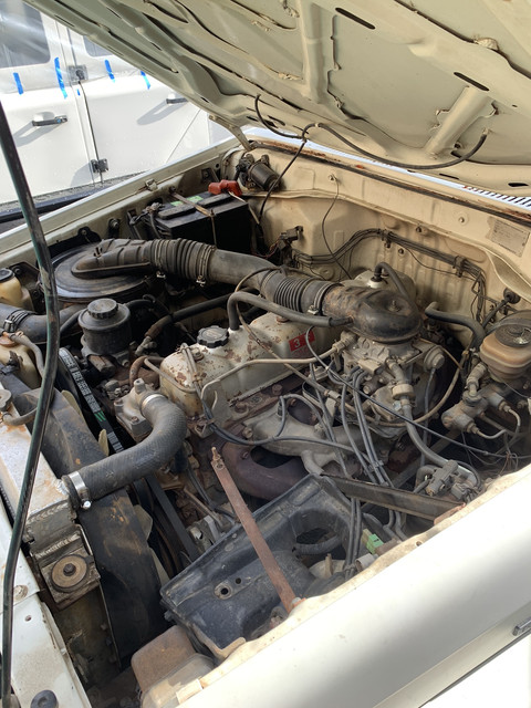

First thing I did when I brought the troopy home , I did a full inspection on engine / tranny / driveline.
Had a lot of caked on oil , and dirt/sand. Decided to clean the engine bay to make it easer to spot leakes/ cracks.
Before photo of engine bay. ..Had seen better days ...

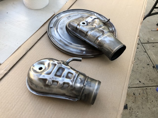

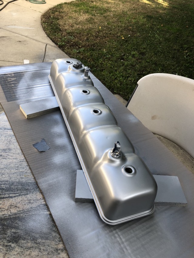

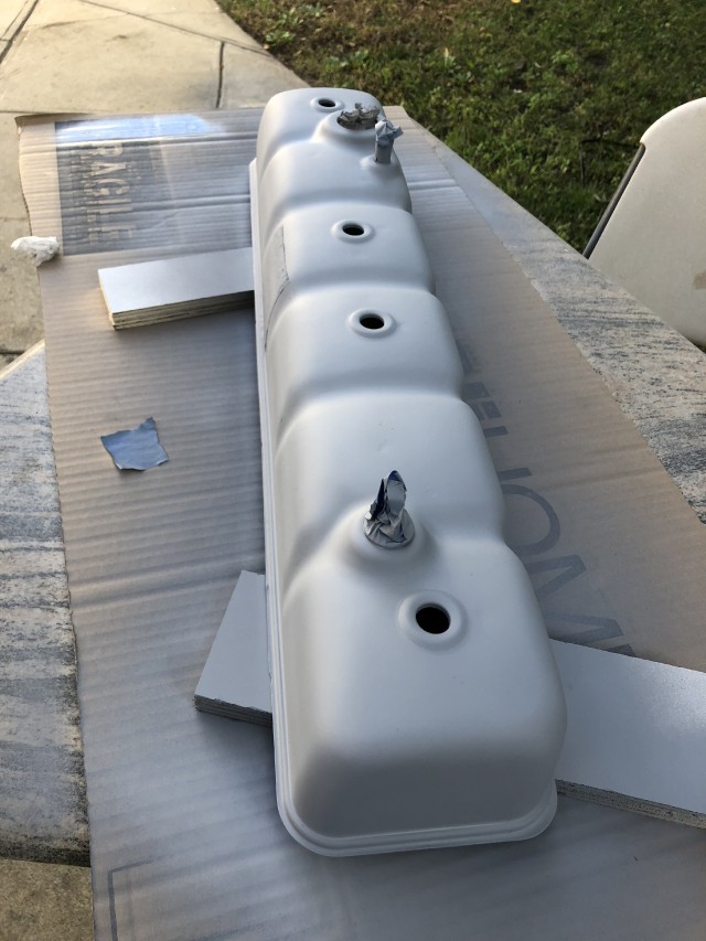

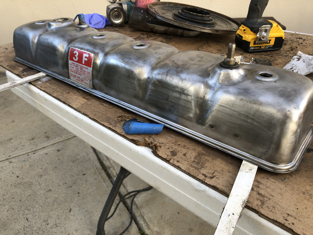

OCD kicked in and decided to paint the valve cover and air intake pieces while I waited for parts to arrive.

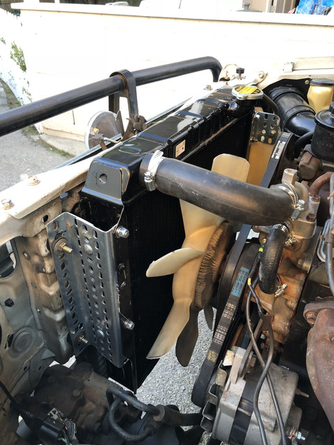

Installed a new one along with new radiator hoses . Started the car, let it warm up.
Now the radiator springs a leak. A big one.
I was in a crunch to finish the mechanicals to drive it from Los Angeles to Portland, so I needed to act fast and fix it. Luckily my friend and FJ fanatic said he had a new radiator that he Justin installed in his FJ40.
It was Toyota OEM unit. Product number 16400-49356 not sure what it’s for but Toyota still makes it and is available at the dealerships in the SoCal area.
I knew it would take some fab work to make it fit, but I decided to take it off his hands and get to work.
The factory 75 series rad mounts and fan shroud weren’t going to work. I found some brackets at Home Depot that worked perfectly for a temporary mounting system.
Will fab some steel mounts later when I have some time. For now these work.
I’ll try to find a OEM FJ75 rad ordered to keep on hand when this one goes out, or my friend wants his back for some reason... lol
