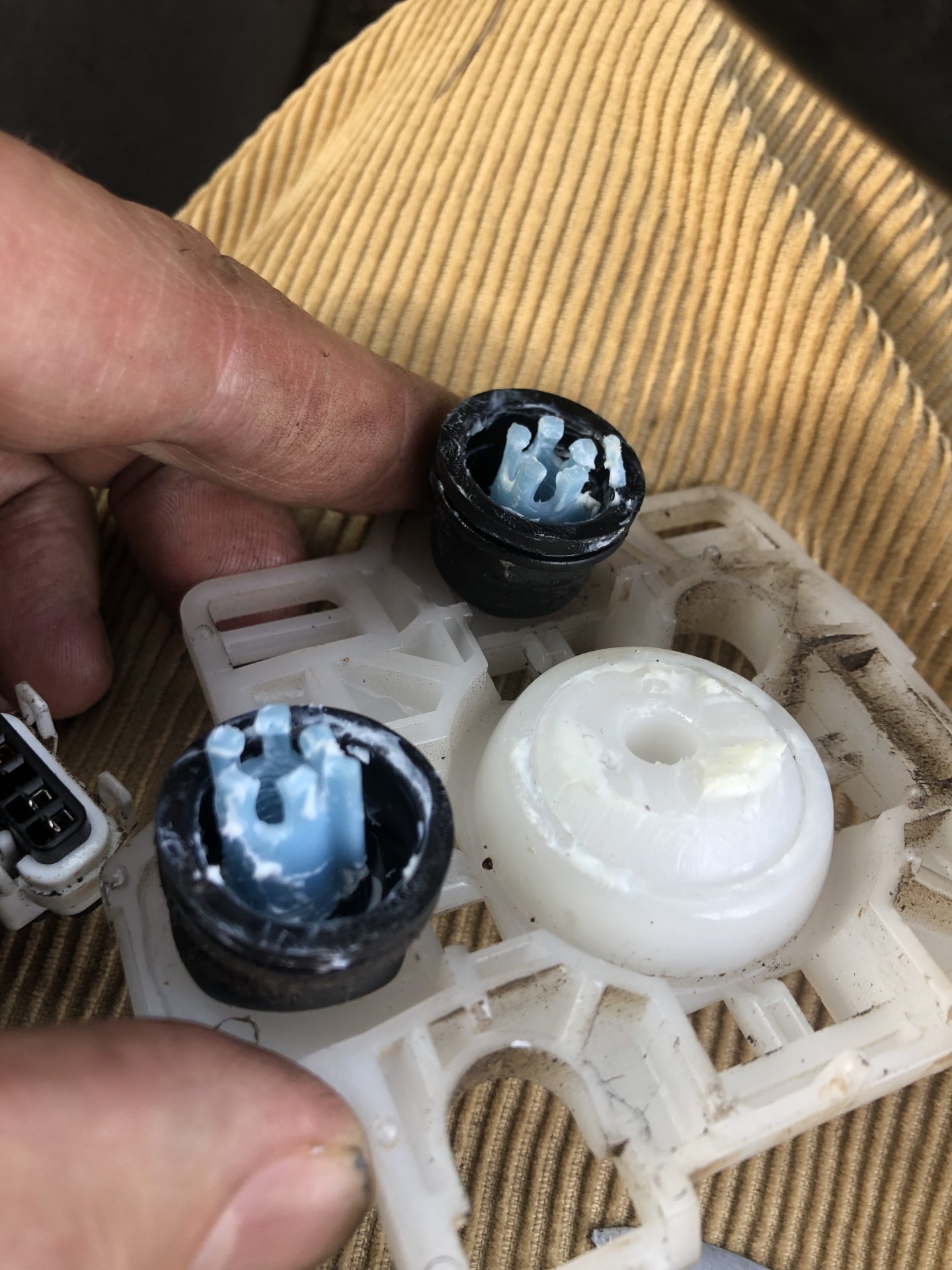

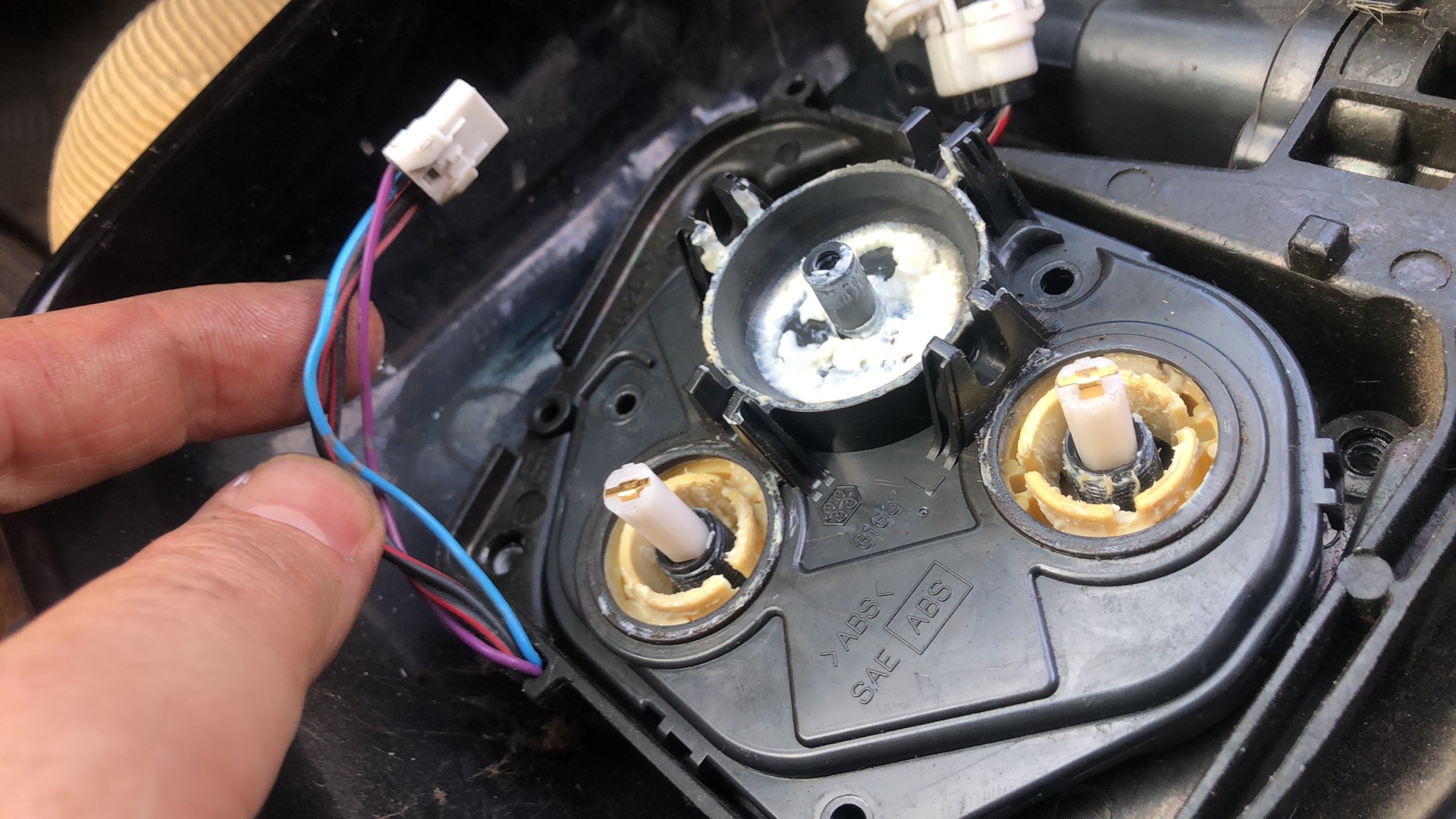

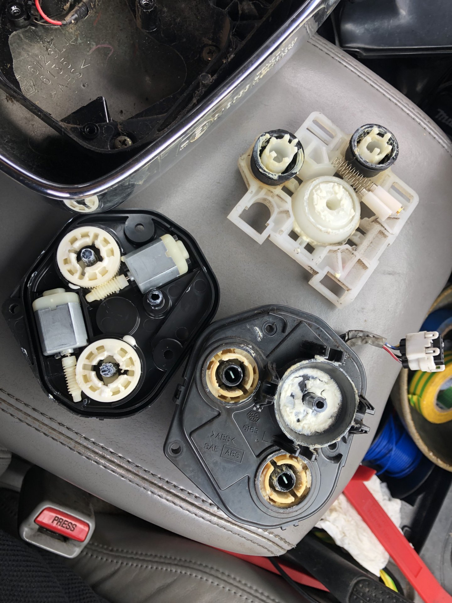

fixed mine, so I’m going to update with my findings.
There are a couple of things that went wrong with my passenger side mirror. It wasn’t the switch.
When you pull the mirror apart there is an adjuster mechanism/plate thing. There are two motors and worm drives and gears in each adjuster plate. I had a dud motor.
In the process of pulling it apart and putting it back together again, I think I also broke a small very important bit of plastic, or it was also already broken.
The motor drives a worm gear, which drives a gear, which has a male thread on the inside. The bit that pushes in or out to move the mirror plate has a corresponding female threaded tube that is seperated into segments so it can stretch and jump threads when you push on the mirror too hard and it makes that grinding noise. On this female threaded bit is one locking tab of plastic which slides into one of 4 potential slots in the motor gear—this stops the top female threaded adjust piece from just spinning in its ball joint and makes the whole thing work. Break that tiny bit of plastic and it either won’t work or will stop working once’s the remnants of this locking tab move out of the groove as you adjust the mirror too far.
Anyway, I had removed Landcruiser mirrors and my wanted LX470 mirrors. The adjuster plates are similar and different. The motors swap, the worm drives are the same, but the gear is different and the female adjuster is different, as is the rubber boot sizes and a few other things. Also the LX470 mirror has a complicated 4 wire and circuit board and probe sensor system which detects mirror position for mirror memory function.
the good news for me is, that I can swap the entire adjuster plate from a Landcruiser into the LX470 mirror. The bolt pattern is the same, and the clips for the LX470 mirror is the same. I don’t have or want memory mirror function, so there is nothing lost going to a Landcruiser adjust plate inside a LX470 mirror for me.
The take home message is, some parts are swappable thus The mechanism is repairable with parts at hand, but many parts are brittle plastic and you have to be super careful pulling them apart and putting them back together. Be particularly careful when pushing on the female adjuster into the male adjuster, to make sure that locating tab is sliding into a groove or you will snap it—it’s a fairly violent process, and you have to make sure it is lined up first.
If your mirror won’t adjust in a direction but you can hear the motor spinning, then I suspect the broken plastic tab, or some other plastic part in there. If it won’t adjust in a direction, and you can’t hear the motor, as mine was doing, then suspect the motor. I‘m keeping this spare set of mirrors for future harvesting of parts!
not sure if anyone will read this, but hopefully if someone goes googling one day for help they might find this old post.
