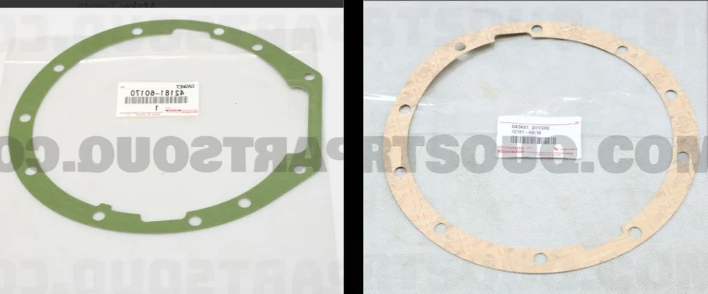

Front Locked centre gasket on left, unlocked on right.
The bolt pattern to the right of the ring gear relief is different.
6 bolts for locked, .
5 bolts for unlocked.
bolts at 2 o'clock-ish and 4 o'clock-ish are in a different position
