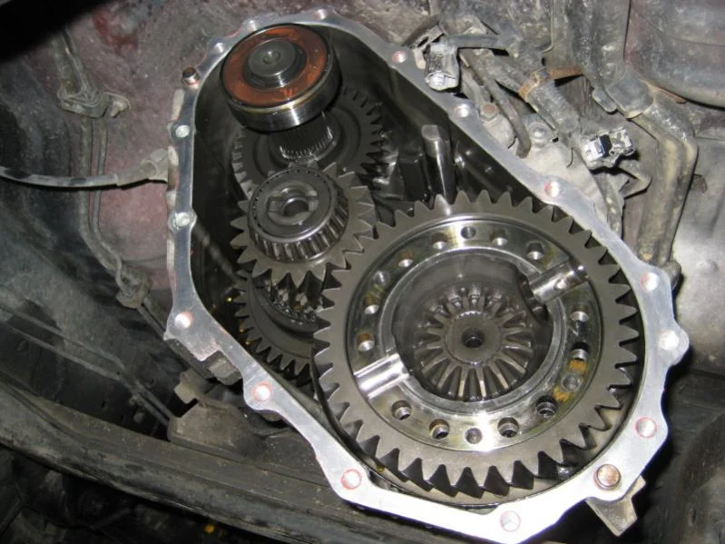

Today I was messing with my part time actuator .. and a question jump in my mind when you do a part time kit in a full time t-case ( HF2A and HF2AV ) with the part time kit the CDL button came to work as my H4 button .. engaging the front DS .. ?
Page,
Forgive me,was your post a statement or a question? In essence the CSL dash switch does become the 4WD switch provided the hubs are locked.
As a side note there is quick wiring mod for those interested in the ability to lock the lockers (primarily the rear) in 2WD. Locate pin 15 (forgot color) on the locker ECU connector, cut the wire a few inches from the connector, splice in a pigtail with a 6mm ring terminal, connect to the ground stud just aft of the ECU (can't miss it), cap & stow the harness side of the wire. Close everything up and go for a drive, you now have the ability to lock the lockers whenever you want so long as you're going 5 mph or slower.
yes that what my question .. and thought it's the same actuator that we have in the HF1A t-cases .. this actuator move a gear that move the fork that engage the front DS ..
Does anyone know how t works ..? ( the actuator ) maybe a thread about that .. coz I identify a pin that have 12V and have continuity with the oposite comming from the main harness and all other ( in the 5 pin actuator connector ) seems to be ground ..
