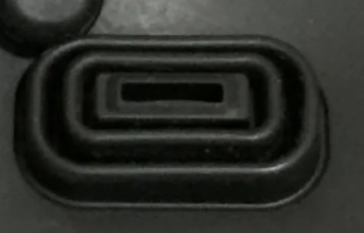

I'm looking the the flexible rubber boot that covers the hole in the floor where the shift linkage passes through.
It looks like it may be a part of a larger gasket between the plate and the floor.
Assembly:
Zoomed in here:

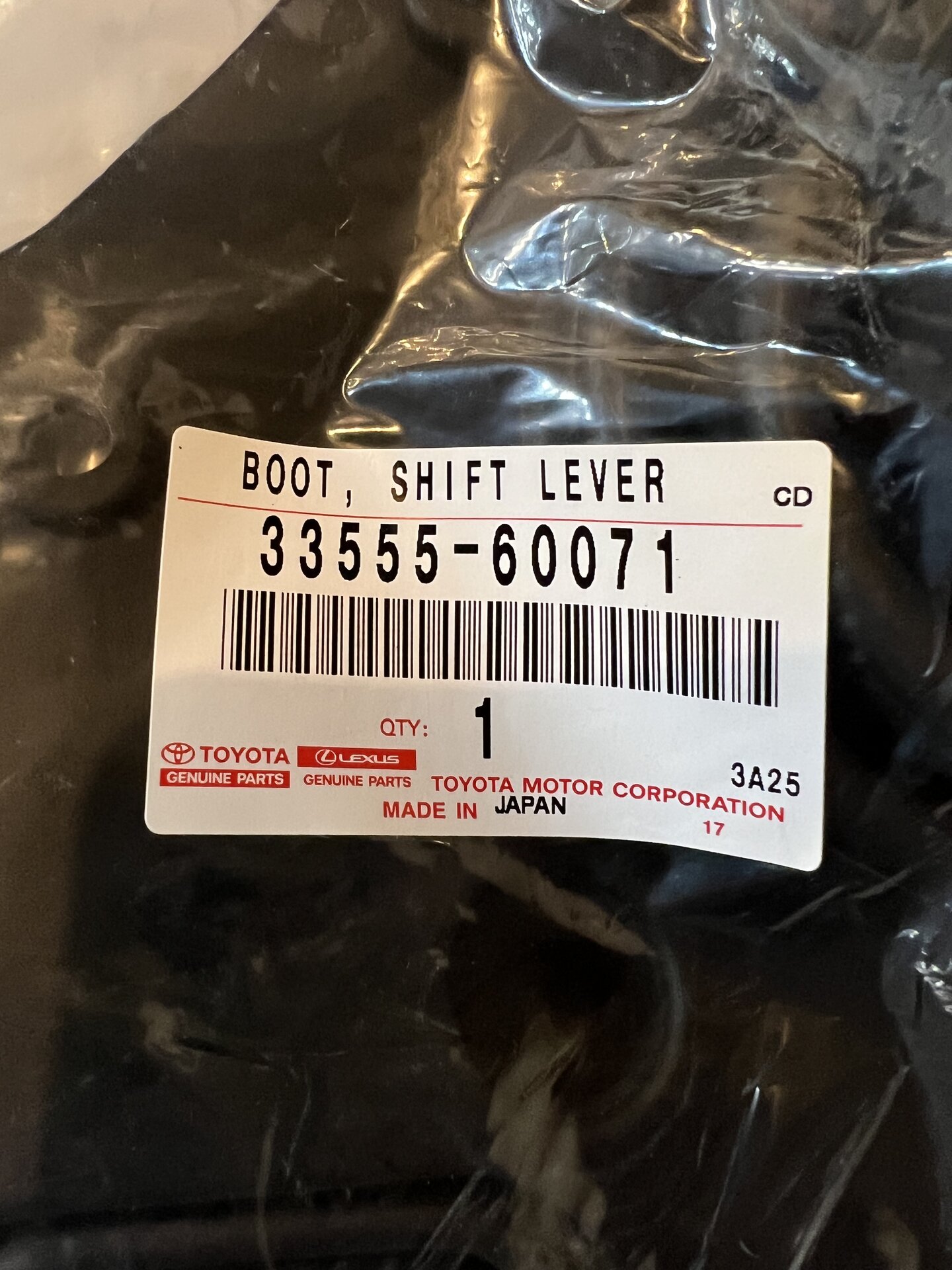

I think it might be 33555 in this breakdown:
33555BOOT, SHIFT LEVER
33555-60071
I'll start sending you a parts technical invoice every time I have to pull up a part number for you. Will that work?
33555-60071
I apologize if I'm being too needy.
Although in this case, it seems like I might have looked it up myself and posted it in the thread above before you posted it just now. :)
33555-60071

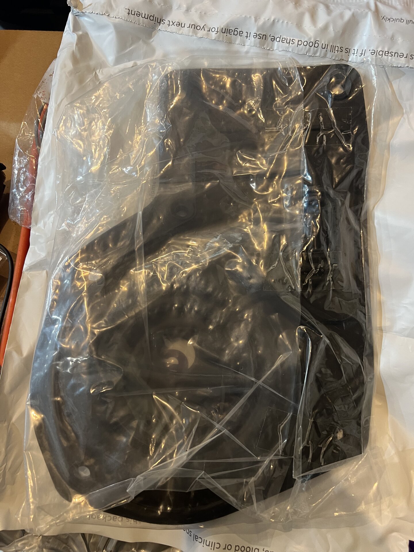

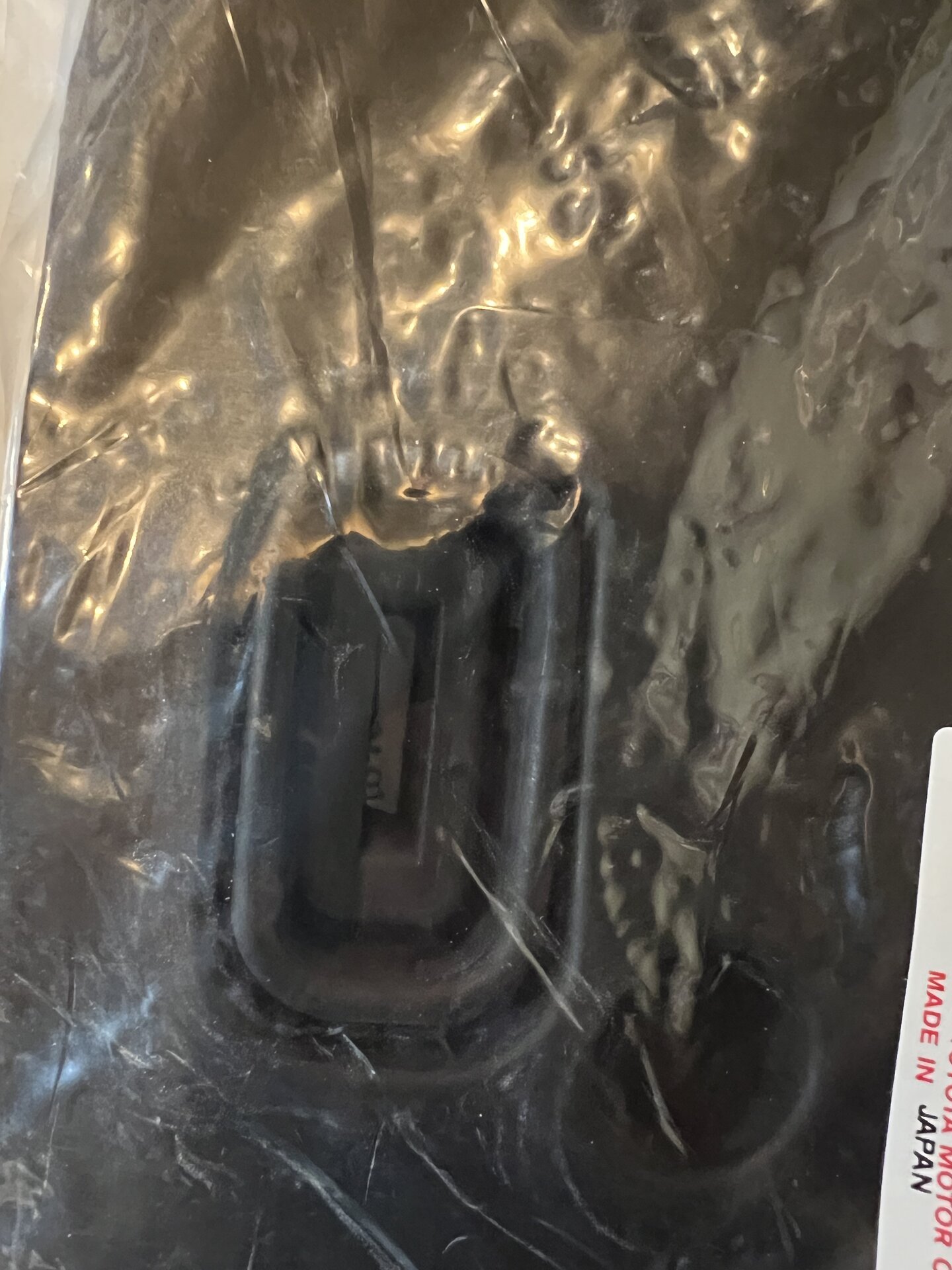

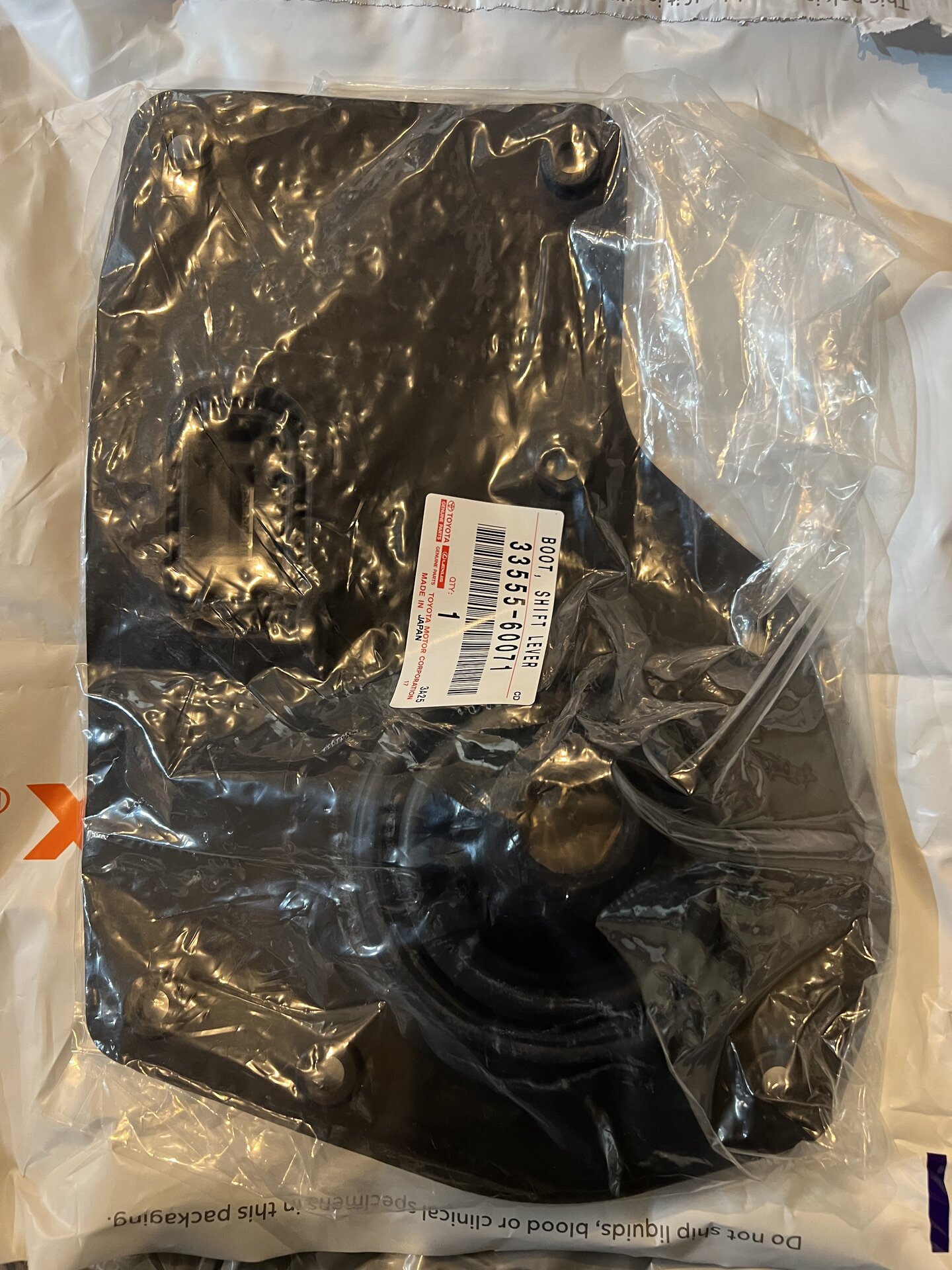

Confirming that that part number is correct. I received the parts fedex today, from japan, free shipping, faster that I get most parts I buy in the US. And a lot lower price...

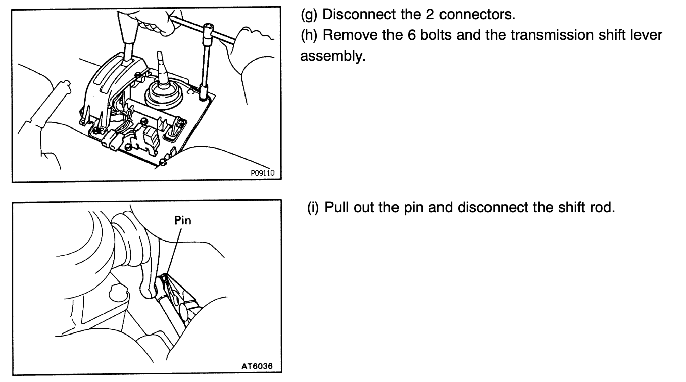

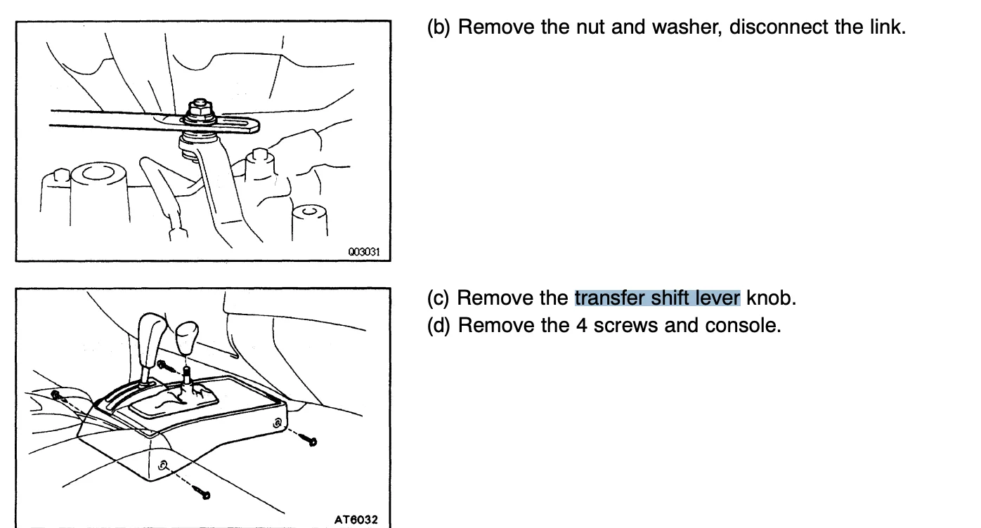

I think the FSM calls for removing the linkage from the top by removing the cotter pin rather than by removing the linkage from under the car by unbolting like the referenced post above did. Either way seems possible. (I was wrong)
Edit/Updates:
I was wrong, the FSM calls for the shift linkage to be removed from below at the other end of the linkage like in the video.
I had it confused with this part (which is disconnecting the transfer shift linkage from above).

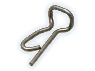

However, I will say that I was able to disconnect the shift linkage from above with needle nose pilers by pulling the pin (like below) with a pair of needle nose pliers with zero drama.
Toyota 90468-14017
Clip
1984-2022 Toyota

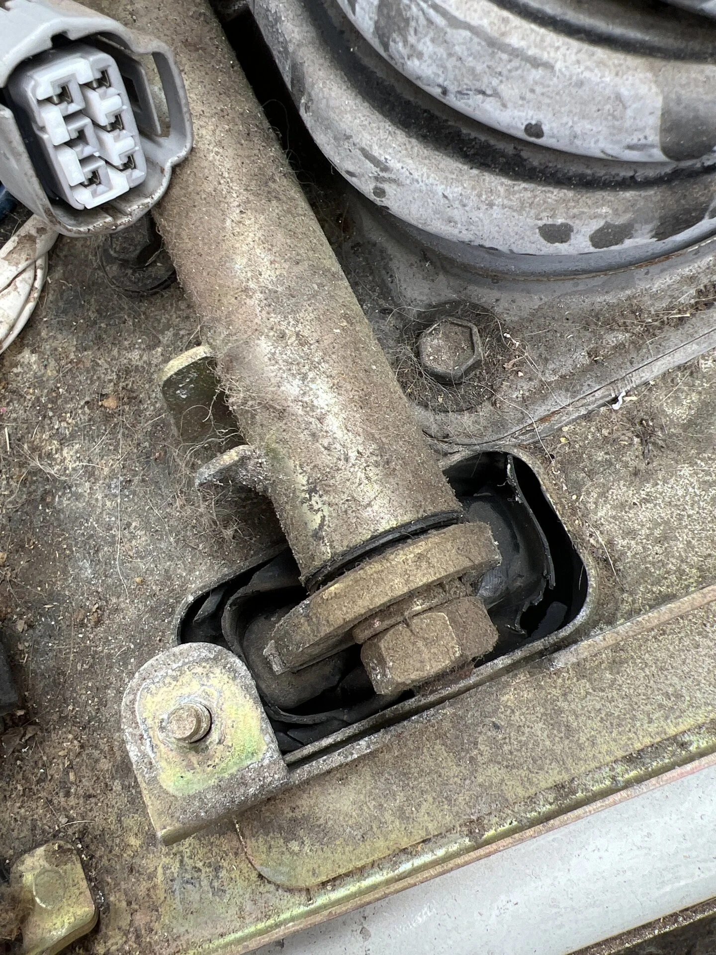

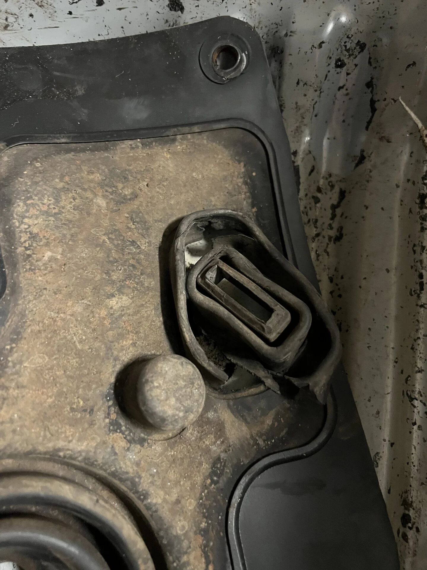

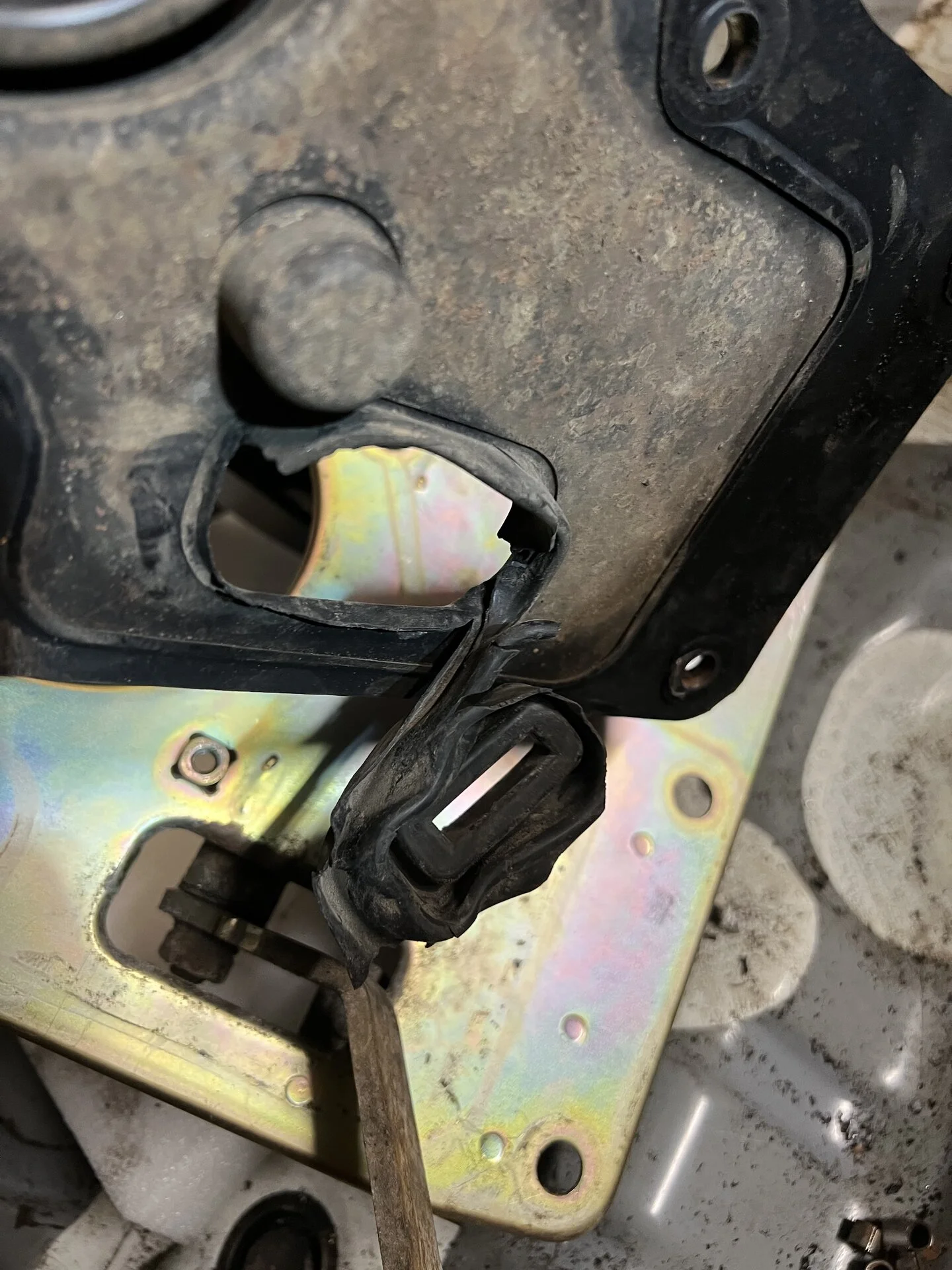

Okay, I just went for it.
Yes the clip is accessible from the top with needle nose pliers, once you remove the 6 (10mm head) bolts that hold the plate down to the tunnel.
I wasn't paying as much attention as I should have, didn't have a magnet handy, and think I lost a washer, but will recover it tomorrow.
The gasket is really shot. No wonder I was getting a lot of airflow and heat coming through.
Just another example of the rubber stuff that deteriorates over time.

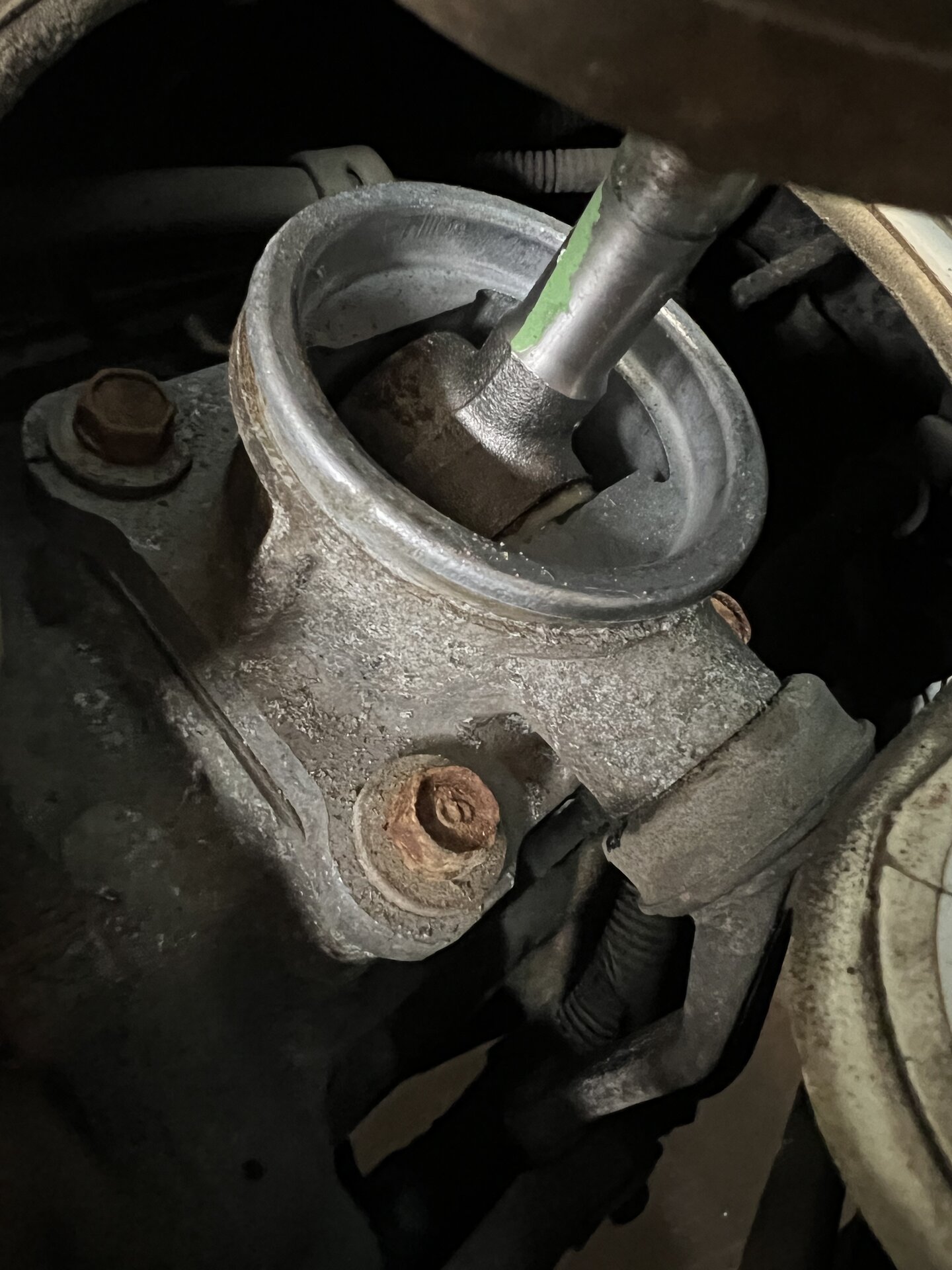

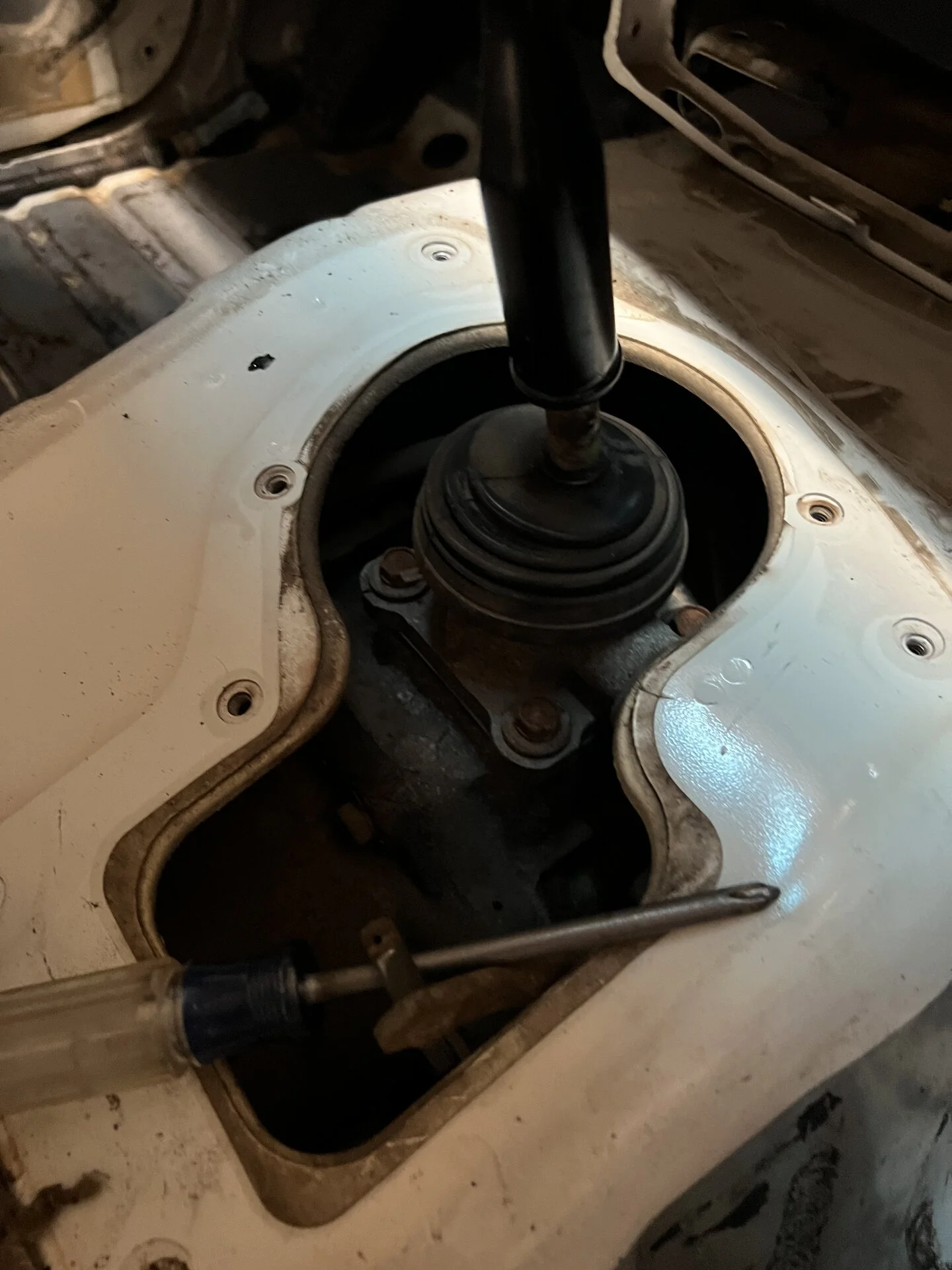

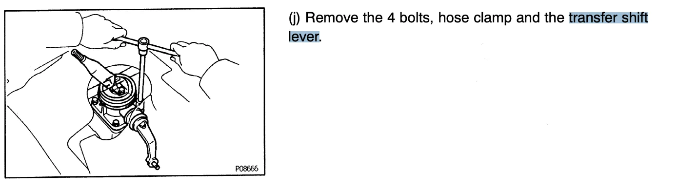

while it's apart, you should take the time to lube the transfer case lever to prevent it from seizing.
I am looking in the FSM now, but if anyone can share how they did this, I'd appreciate it.
Am I taking those four bolts off and lubricating the pivot with whatever is already in there (grease?)?
Popped the boot. No grease. Maybe just hit it with some teflon spray lube?
Make sure the lever moves freely when disconnected from the transfer case linkage. It should flop around easily. If not, then you should remove it and clean out the pivot pin. once free and lubed, I packed the entire cavity with grease, and lubed the rest of the linkage pivot points.
I can shift into and out of low range with 2 fingers.
Any rec on removing it and cleaning out the pivot pin? I have the linkage disconnected and the lever moves back and forth, I wouldn't say it "flop(s) around easily" though. Only thing I see that I can start tearing down are the four 12mm bolts shown in Charlie's picture above. Also, what are you lubing with, moly grease? Thanks!
It's just bolted to the top of the transmission housing. Remove the bolts and put it on a bench to see what you have. If the lever is able to move relatively freely, then all it needs is some grease. Remember that it is exposed to the elements being on top of the tranny. Don't be shy with the grease. The lever should flop around easily.
I use moly grease for everything on the truck.
Thanks Jon! Noticed that the transfer case shifts harder when the linkage is connected (i.e. actually shifting into and out of 4 hi/low) than when not. Is that to be expected? Outside of changing the transfer case oil, anything I should look into?
