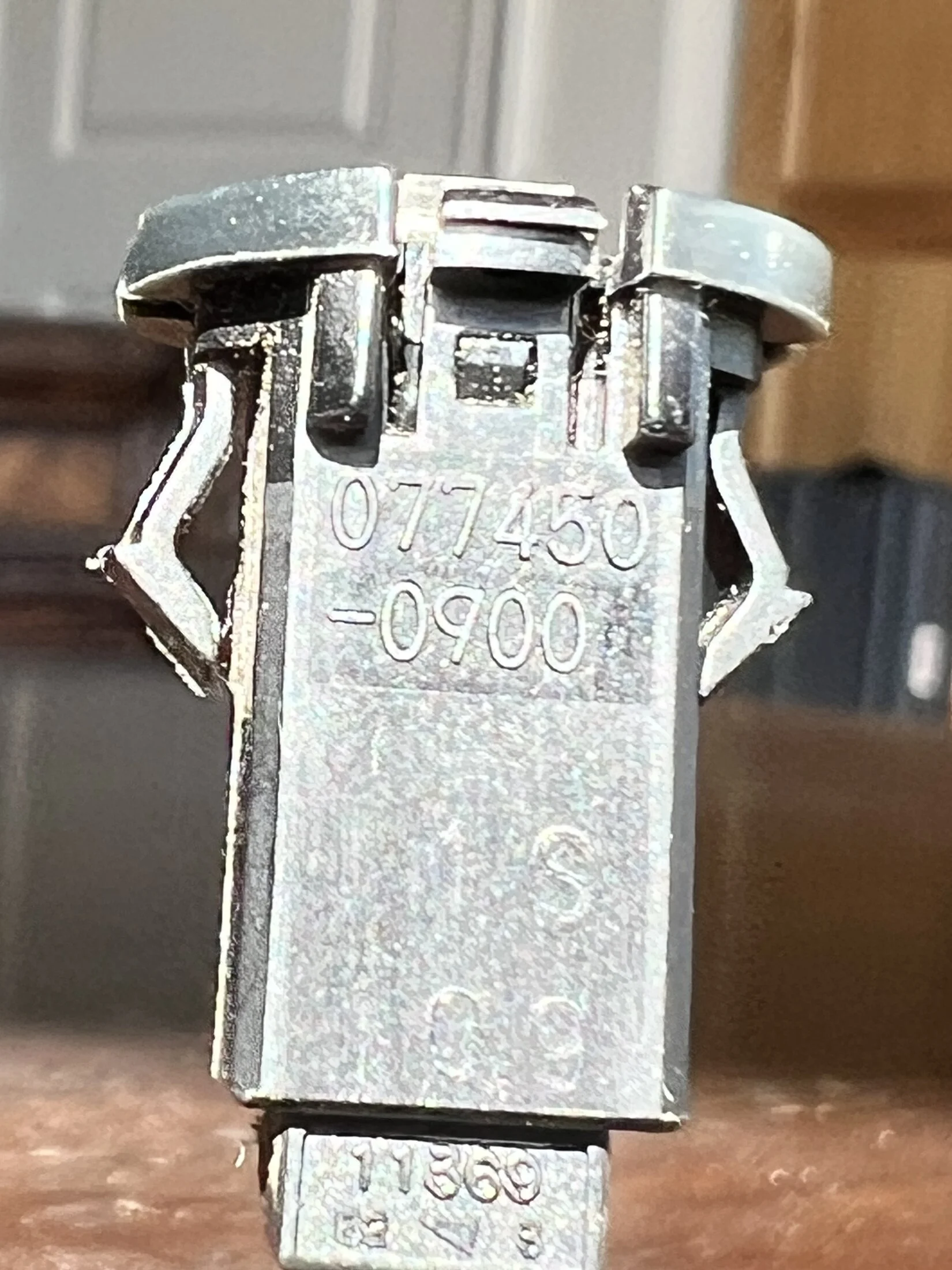

The part in question is shown below. It ought to be easy since it is proudly displayed right there on the dash of my 97 40th Edition above the passenger airbag. I have searched everywhere I can think of including the circuit diagrams and yet I cannot find anything. It looks like a light sensor to me, but then it should be shown somewhere in the parts or circuit diagrams.
Light sensor. Google that part number.
I did, and yes, I found it shown as a light sensor as well as a temperature sensor, but temperature sensor did not add up to me. However, I see nothing about it being related to a Land Cruiser or given a Toyota part number or shown in any electrical diagram.
Believe it's 88625-32160.
Something used for the auto function on the climate control. LXs and 40th anniversary editions had it.
Mine is a 40th anniversary edition, but that part number, 88625-32160, comes up as a thermistor, which is for temperature measurement not light sensing. This definitely looks like a light sensor and the small translucent cover also suggests a light sensor.

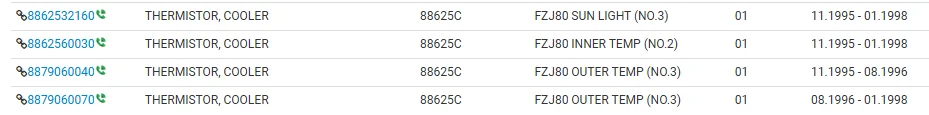

However, to add to my confusion, I do see in a Amayama diagram it is located where mine is, and it is listed there as a Thermistor, Cooler, but also a solar device. In the diagram provided by NeverFinis, it is clearly a light sensor. The diagram shown by Amayama is however, not for a USA spec 97 LC...
I believe @TXMeatball has the right part number: 88625-32160

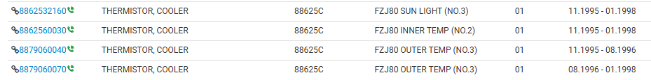

4 Thermistors are listed for my 1996 LX450 on PartSouq, but only one is also called a Sun Light.
Yes, I think I am happy with the part number provided kindly by TXMeatball, and with what appears to be a naming error calling it a thermistor. I do sort of wonder why the cooling system control would want, what seems to be a photo switch, but OK, it is there.

Just thought of something. What I am calling a photo switch might be more than a simple on/off switch controlled by light. It might be a device that can provide a simple measurement for solar irradiance. This might then be used by the AC control system to adjust automatically the AC based on the amount of heat coming in from the sun.
I think you are overthinking it.
It is a thermistor that is directly exposed to sunlight. 50% of sunlight is infrared, which a thermistor will absorb.
It is also positioned very closely to the windshield, which will also change in temperature based on outside weather conditions.
I don't think a true photon detector would work as well in this situation.

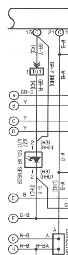

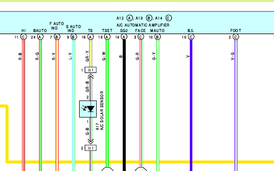

A/C Solar Sensor, Page 186 on my LX450 1996 FSM.
The 1997 Land Cruiser EWD has the same thing on page 173 (Automatic Air Conditioning circuit). There is also a Technical Service Bulletin which outlines how to test multiple A/C Sensors.

I am looking at my 1997 LC EWD Page-173 and there is no solar sensor on that page. This is weird. My AC circuit diagrams span pages 172-179 and there is no solar sensor on any of those pages. This is publication EWD282U. Can you please confirm that you are looking at the same publication?
As previously stated in post #3, post #6, and post #7, the 40th anniversary edition had the same climate control as the LX450.
The LX450 EWD is available to download from the resources section, and you will find the solar sensor on page 193 of the "automatic air conditioning" section.
While 99% of the 96/97 FZJ80 and LX450 are identical, there are some very small differences. IIRC, the climate control is the only electrical anomaly. The rest are mostly cosmetic.

The very nice service bulletin provided kindly by ToyotaDon confirms that the part in question is a simple photodiode that conducts (low-resistivity) in light and does not conduct (high-resistivity) in low light. The cover is a dark translucent black, so likely it conducts only in bright light. I may use a light meter with mine and see at what level of light it switches.
