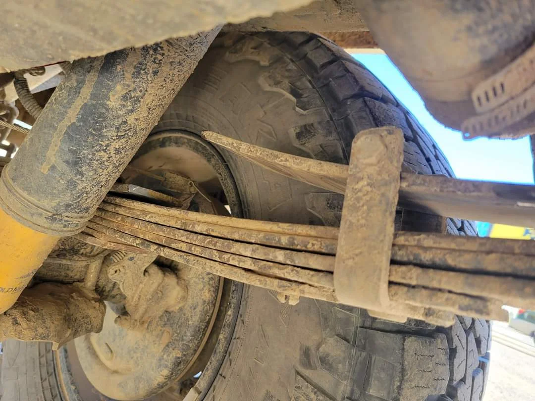

Well, some have seen a sneak peek of pictures. But, bottom line is the 4R broke a rear spring. Good news is I was about done with this leg of the adventure. Other good news is I broke down near Shawn and Jill.
At the moment I'm holed up at there place in Troy, MT. Bad news is replacement springs won't be here until middle of next week.

BUMMER! But good fortune on the location. What springs are those? I see an add a leaf?

Dang, that looks like it's been just hanging on for a little while.
